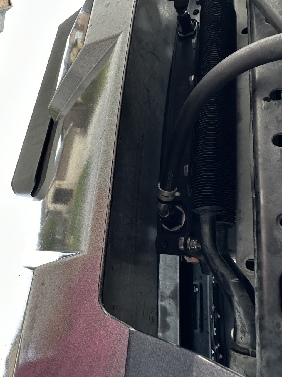

  2. Nov 8, 2022 at 4:21 PM
    #4112
    Saltyhero13
    Saltyhero13 Throbbing Member
    Aug 12, 2020
    #50704
    4,947
    Fuel delete mod Cup holder upgrade
    Good call. How are your transmission temps?
  3. Nov 8, 2022 at 5:12 PM
    #4113
    HonorNotInner
    HonorNotInner I speak the 3rd most eyetalian
    Mar 2, 2021
    #59861
    186
    Alex
    Fort Worth
    2020 1794
    Added money to it.
    So far so good just driving around town. The highest I saw today was 188… without towing something driving 90+ mph I would typically be around 203 degrees. So I’ll check next time I’m on a toll road and see if it performs as good with the new placement. Before the cooler if I was on the highway (not towing)doing 80mph the temps would be 222-232.
  4. Nov 8, 2022 at 7:06 PM
    #4114
    snivilous
    snivilous [OP] snivspeedshop.com
    Apr 16, 2019
    #29192
    5,023
    SW UT
    300k+ Supercharged 2008
    Well that makes me feel better. I have the stock cooler and at 80mph normally seen high teens, so not far off from you (before). I had always thought it was the new torque converter I have which is supposed to have a higher stall (going off the tranny shop claiming that but no proof), but lately I've wondered if the transmission tuning and running higher line pressures and such is actually what has driven the trans temp up since it used to be lower.

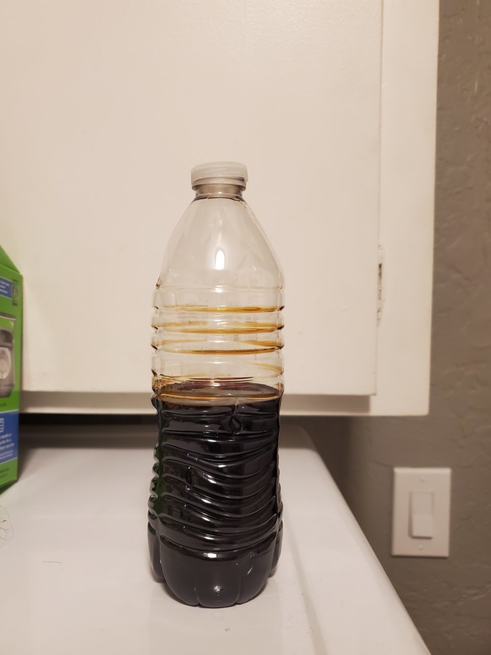

    Radium ass fluid collected over 28K miles.

    nobodyintexas
    nobodyintexas What?
    Jun 22, 2020
    #48303
    6,961
    South of Houston
    S/C'd 2020 White 1794 Tundra
    so are you that much lower in your oil pan?
    or is it mostly water?

    The consistency of the fluid is more similar to oil than water. I haven't noticed any drop in oil volume. I always check the dipstick before an oil change and haven't seen anything indicating a loss of fluid.

    I have always been perplexed by this liquid.
    where is it coming from?
    if it's oil based, why is your oil pan still full?
    ponderous

    Here's my simple logic...
    The water bottle is 16.9oz and it's roughly half full. So let's say it collected 8.5oz of fluid after 28k miles. I change my oil every 5k miles so that collection is after 5 oil changes and part way into the 6th.
    That averages out to collecting 1.7oz per oil change or 5k miles. Maybe noticeable?...that's getting pretty specific to read from the dipstick. Best way to confirm would be measure oil after draining to compare.

    so, if we didn't remove it with a catch can, it would go back into the engine and burn off in either the cylinder or by sweating off in the oil. right?
    and I thought the Tundra has a capture system - PCV system - that condenses this crap and drips it back into the pan?
    My '34 hot rod just belches this crap onto the street. ah...the good ole days.

    Well over time it cakes the upper intake area and valves hence why the capture

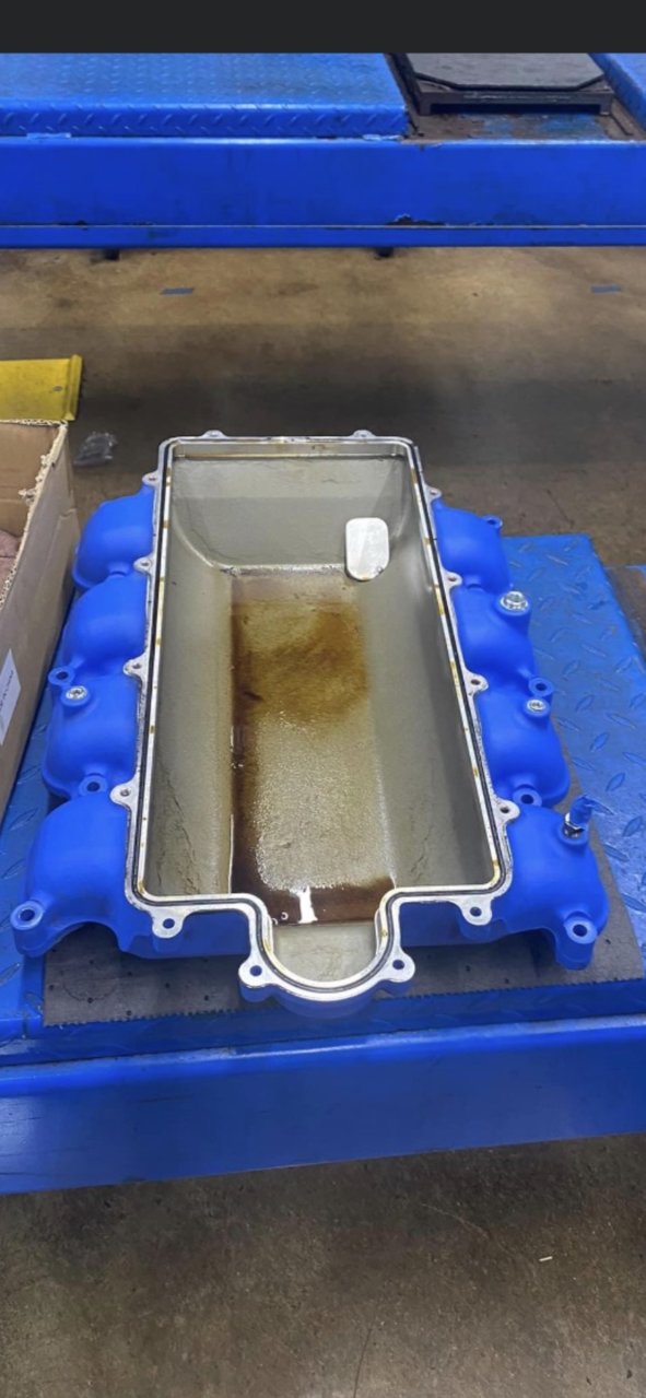

    These pics were from Facebook, this guy had to take his Whipple unit off the base/manifold when the coupler failed (Whipple has a weird style coupler btw). I think he even had a radium can installed for most of the blower ownership, and you can see the oily goo laying in the bottom of the intake pan. Just thought it was interesting to share.

    Theoretically yes, in practice there's still enough that gets by to make the intake nasty plus you have increased crank case pressure with the blower which isn't helping the stock collector. That's why the throttle body, intake, inside of the blower, etc. always look gross. It does get on the valves, but the injectors spray the valves off so I don't think there's really any harm from it. There's an argument that your effective octane is decreased because the shit gets burned up and can initiate detonation earlier. Personally I got the catch can because my PCV hose was leaking and the hose on the magnuson is a bitch and a half to get on and off and the catch can makes the hose installation easier :D I don't think it's required or even needed, but isn't hurting anything and certainly makes the intake less slimy when you're working on stuff.

    I agree @snivilous , but I've always practiced on ALL boosted vehicles to make use of the catch can as like stated, the plenums can get caked up and reduce flow speeds with all that rough slime coating everything....iI guess I'm just saying it's good practice to use a catch can when boosted...both SCr or turbos...

    Just pondering this some more while driving my son to school...
    If the can collected 1.7oz per oil change over 5K miles and let's say oil drained is ~7.5 quarts (240oz). This would mean that oil in the pan would only be reduced by 0.71%.
