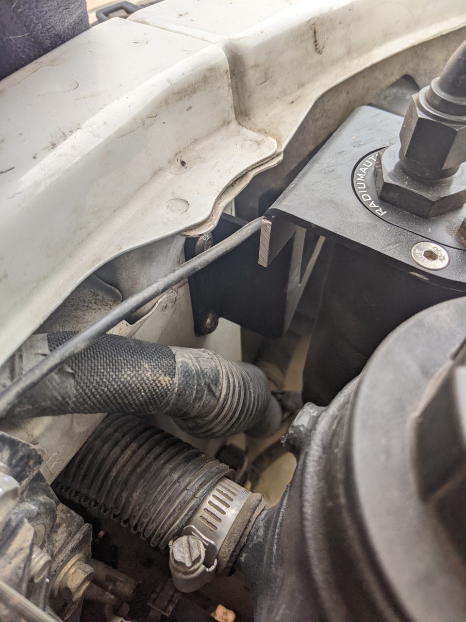

    For what it's worth I was able to modify, ie just remove one of the legs, of the bracket that came with the kit. The kit had everything I needed.

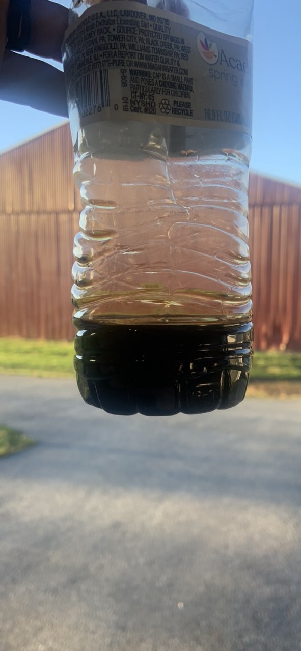

    Does anyone else keep a bottle full of all of the oil and gunk you’ve emptied out of your catch can? I have the JLT which works, but probably isn’t as top of the line as the Radium. I’m curious how much it catches compared to the more expensive options.

    Why would you keep a bottle? "This is my bottle of ass fluid, I love it so it sits on the shelf here" :rofl:
    I've only had the catch can for 10k miles, and it's collected less than an ounce of fluid, which is like 3/8" on the little dip stick thing. Maybe less. It's so little I forget to check it.

    Psssh, why wouldn’t you keep a bottle? It’s fun lol. I get to look at all of the junk that would have gotten all up in my supercharger heat exchanger if I hadn’t installed my cheapo catch can. It’s like a science experiment! Here’s mine over the course of maybe 7k miles or so. My little bottle of “ass fluid”.

    The real question is, does the person with more ass fluid have a better filter or more blowby :rofl:

    We will never know, since SOMEONE hasn’t been collecting their ass fluid!
