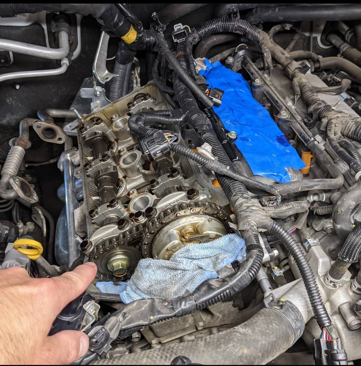

    That looks sick! At least you can feel good about probably never having to do that job again with the quick change setup. I think I watched a video Viktor put out of changing the coupler, and when he did that he removed the coolant crossover pipe and then removed the snout. You have to deal with some coolant mess then I suppose, but that was how he did it which maybe could save some others a little frustration if it is indeed easier. That is, if I’m even understanding your struggle properly. Anyway, So which pulley size is that one you installed?

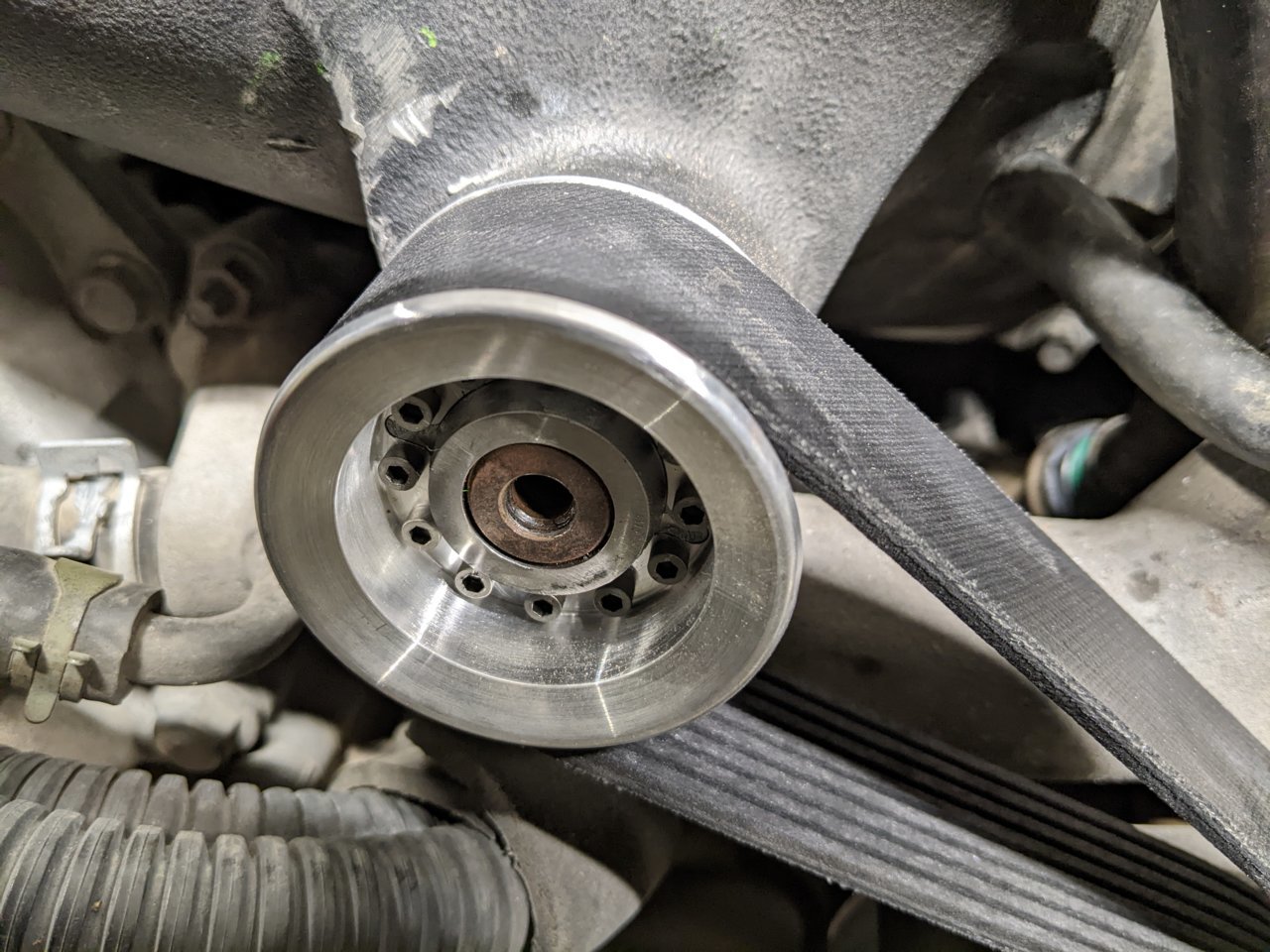

    When I bought the URD pulley I bought their "tool" but never ended up using it. I couldn't get a way to pull the pulley without pulling the snout to begin with, and with the snout removed I just put it in my HF 20 ton press which I highly recommend. No heating, and personally I was worried about stripping the threads using URDs bolt method. I can take a picture later how I set it up in the press.
    You are correct, I even watched part of his video since SCOL instructions say remove the blower. I was able to get the snout completely unbolted without removing anything, and when I couldn't Tetris it out I watched Viktors video. I even got to the point of removing the top radiator hose, but you can't access the bottom coolant crossover bolts without removing a bunch of other shit, which at that point I decided it'd be easier to pull the injectors and the main body since at least those are relatively easy to access.
    That photo is with the 2.0 pulley and appears to have similar backside clearance to the old pulley which is great, and radially no issues. Likewise the 2.3 fits the same. The hub appears to have the same fitment as the other pulley hubs too where it's flush with the shaft on the end and is touching the bearing inner race, so visually everything is lining up like it should!

  4. Oct 20, 2022 at 7:10 AM
    #3754
    reywcms
    reywcms New Member
    Dec 20, 2021
    #72040
    7,224
    Rey
    North Plains,Oregon
    2017 Tundra Platnium
    Too many mods to come
    Awesome work! Looks great I can’t wait see what the results are

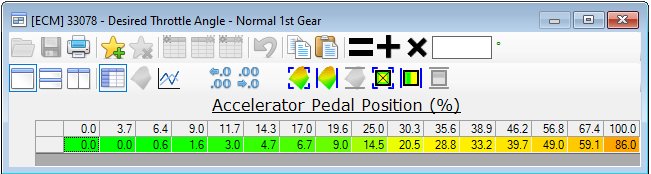

    Yea just looked at my logs from this morning and I get 83% TPS at WOT. Throttle in HPT (if you're using that) is measured in degrees of the butterfly valve, with 86deg being the max.
    Now how TPS value is specifically determined, I don't know. At idle (~600rpm) I'm at 16.5% TPS, and WOT is 83% TPS. 68% I guess sounds low, but maybe the spread of idle TPS to WOT TPS is more important than just the high number? Does my 83% TPS equal 86deg of the butterfly? I don't know. Maybe if you modify the throttle angle specs above so that the 67.4% APP is actually 86deg and see if there's any difference in performance? That's where I would start with my limited understanding--ie just make WOT happen with less TPS.
