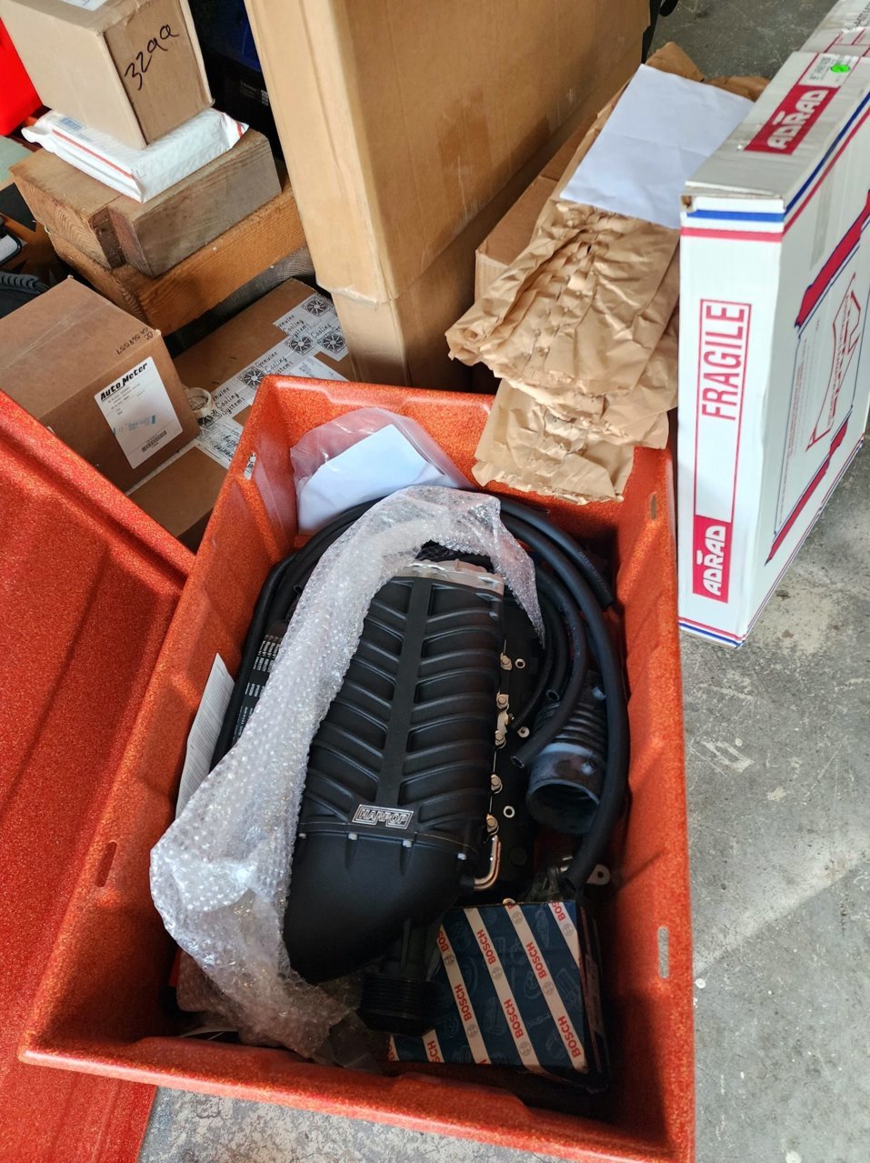

    Just landed

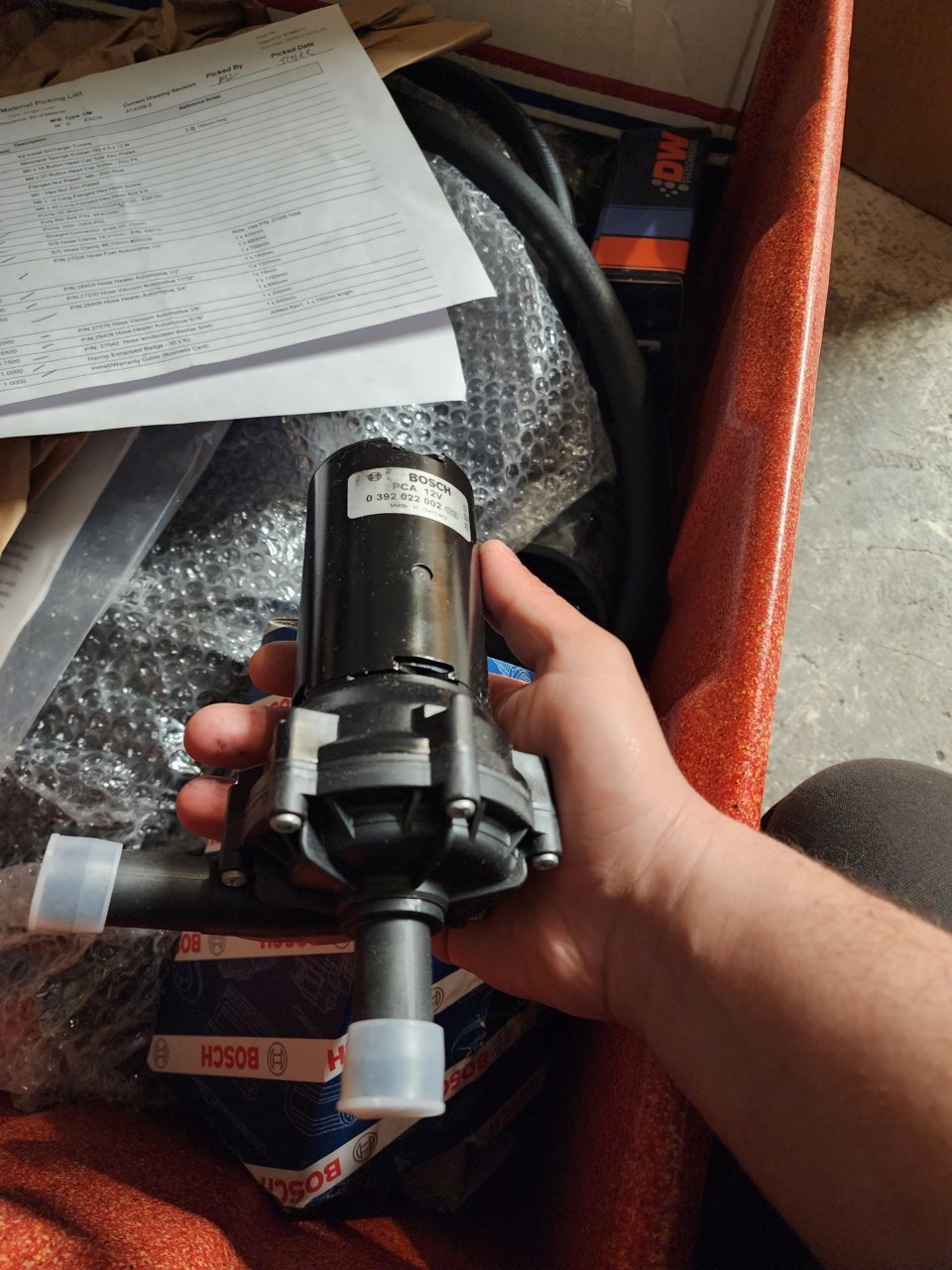

    What’s in the Bosch box?

    Gonna say i/c pump?

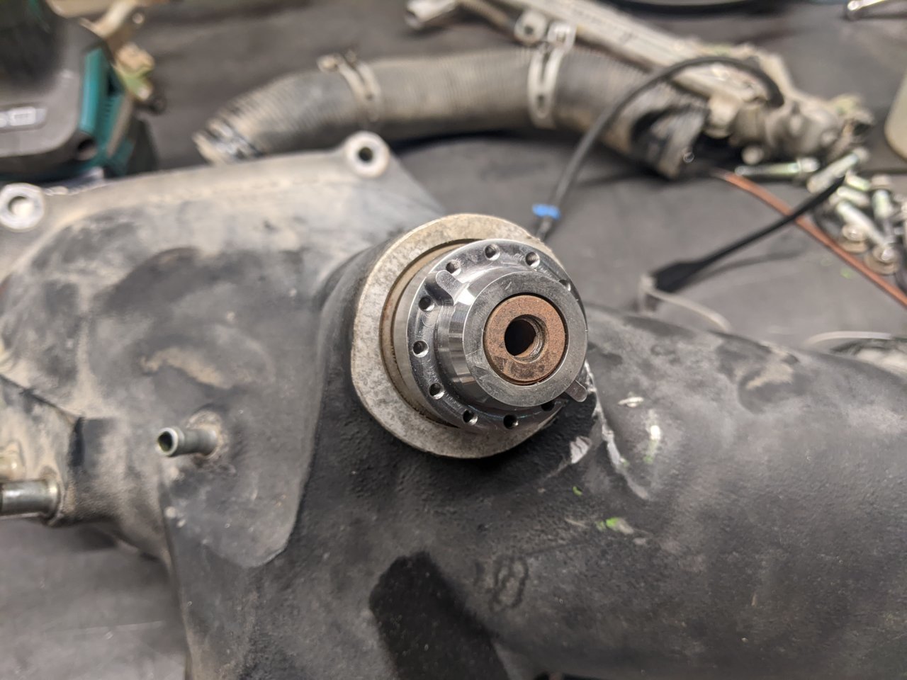

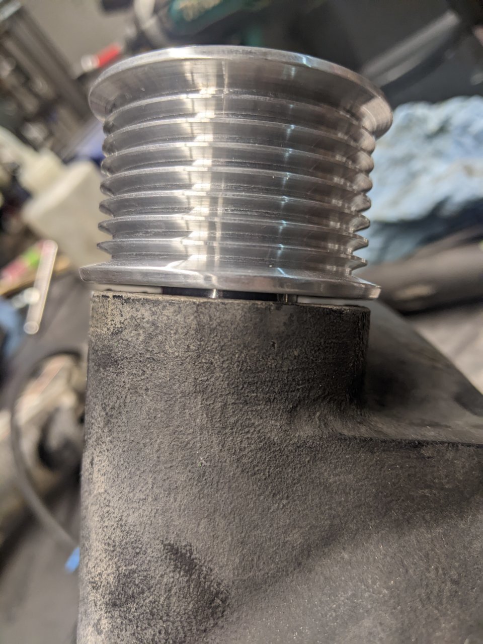

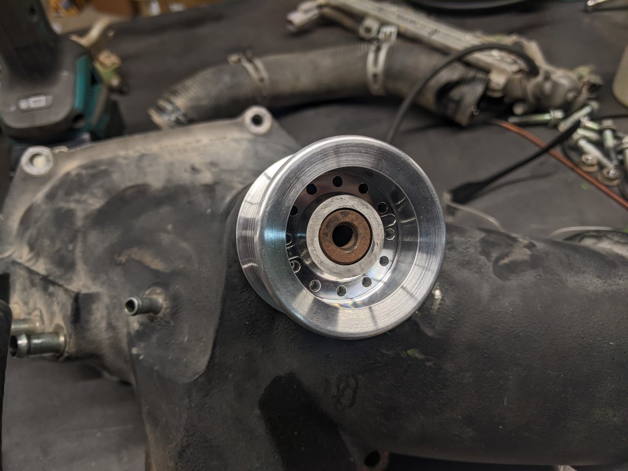

    Got a late start so only got everything torn down and got the new hub pressed on! This was the biggest risk imo since if the hub works I can swap pulleys out and improve them with very little effort, and it pressed on great! The shaft is 0.663" so I think it's good I went with 0.662" (some quick napkin math puts that at ~5600lbf of shaft compression, which would be like 900ft-lbf of torque at 0.5 coefficient of friction, so that sounds like plenty?) :D I am slightly worried about spinning the hub, but if that's the case I can drill and key it which isn't uncommon on other superchargers. Now would be the time to do that, but I'd like to run it how I'd sell it so hopefully that isn't needed!
    I forgot how much of an absolute bitch it is to swap pulleys, if I knew that when I got the URD I probably would've designed my own a long time ago so I would never have to go through this process again. The URD fought me to the end to come off, and then of course you have to pull the blower housing to pull the snout off since the crossover pipe is in the way :annoyed: I swear when I did the URD I didn't have to pull the whole blower but that was awhile ago. Either way, at least the hub is on so (knock on wood) I never have to Jerry rig a harmonic balancer again and worst case it's just unbolting some things! With some luck tomorrow will be the beginning of testing :D

    Ah yes. I never go the chance to see my Harrop crate before install as it was shipped directly to the installer.

    Did you use the urd press on tool to install? I think I still have mine. Also did you need to heat up your pulley to press on? Heated the URD in a toaster oven in my garage for like an hour and it made the press on a lot smoother, on the taco
