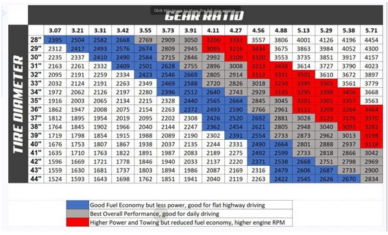

    If I put wheels/tires on that were ~28.5 inches tall...would that simulate 5.29 gears? or ~3400rpm
    or am I thinking wrong?
    @Saltyhero13 's chart

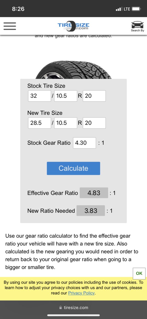

    Going by this calculator I think it would be closer to a 4.88, if I did that right.
    That said it would essentially be the same resulting ratio as someone with 35s running 5.29 gears.

    If I’m reading that chart right, you would have to go down to less than a 28” (like around 25”) diameter tire to effectively get your 5.29 gear ratio. But I like think you would just spin tires like crazy.

    The chart is telling you how to get into a specific band i.e. power vs efficiency by changing tire or gears.
    The calculator is telling what gear ratio is need to restore your current ratio. That's the only additional information its is really adding. I would be less concerned about effective ratios and more interested in which efficiency/power band I'm in.

    As Silver said, 32/28.5 * 4.3 = 4.83 which would be the effective gearing. By comparison 32/26*4.3 = 5.29, so a 26" diameter tire has the same force applied to the ground as a 5.29 does with a 32".

    Just another gear/tire/driveshaft chart I used when ordering for my JK

    I believe there is a breaking point where lower gearing actually translates to a slower truck when you have a certain amount of wheel horsepower to weight ratio, also depending on tire size. I was playing with a gear calculator for the best 1/4 mile times given my truck size and weight. I’ll include the link. It said my ideal ratio with 32.5” tires, 500whp, and 6500 lbs is 4.38 so guess I’m staying stock. https://www.motivegear.com/wp-content/uploads/calculator/drag-performance-calculator.html

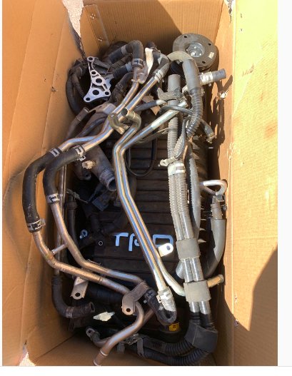

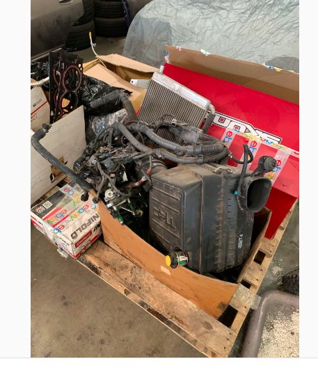

    What is a reasonable price for a used TRD set up? Seller asking 6k, I'm thinking that is steep considering it has to be sent out to be rebuilt or one risks killing it seeing as there is no way to know what condition/how much stress miles it had.
    TRD supercharger kit used original 7psi pulley Comes with majority of the components minus what’s listed below: *no belt, buy a gates green *No tune, you have options VFtuner and HPtuners *No in-tank fuel pump which you should already upgrade to a prospeed kit.
    Also he says at full asking engine harness is incuded. What harness is that & is it needed?
  19. Oct 16, 2022 at 12:08 PM
    #3679
    nobodyintexas
    nobodyintexas What?
    Jun 22, 2020
    #48303
    6,923
    South of Houston
    S/C'd 2020 White 1794 Tundra
    buy a new kit...you will live a happier life.

    I bought my blower used and bought the fit kit new. And still came in cheaper. At that price I’d buy new

  21. Oct 16, 2022 at 12:36 PM
    #3681
    e30cabrio
    Oct 20, 2017
    #10410
    6,522
    West Valley, Phoenix, Az.
    Boosted 2013 Sequoia TRD FAUX
    What did you pay? Did you need to rebuild the blower?
    I'd think 3k is the most that is reasonable used. What is the harness? Does it come with a new kit?
    snivilous[OP] likes this.
  22. Oct 16, 2022 at 12:37 PM
    #3682
    M3Tundra-JK
    M3Tundra-JK New Member
    May 3, 2022
    #77930
    2,841
    Scott
    2005 GX470
    Def get a new kit over that. Rebuild is going to be $2k minimum. New blower and kit is only $7500. I paid $3500 for my new trd blower assembly
    e30cabrio, snivilous[OP] and reywcms like this.

    My used blower was freshly rebuilt and never reinstalled. I’m into mine $5.5k I think. Not including upgrades that I added.

    You can buy new for just a bit more and know exactly what you will have!:)
  25. Oct 16, 2022 at 1:47 PM
    #3685
    snivilous
    snivilous [OP] snivspeedshop.com
    Apr 16, 2019
    #29192
    4,997
    SW UT
    300k+ Supercharged 2008

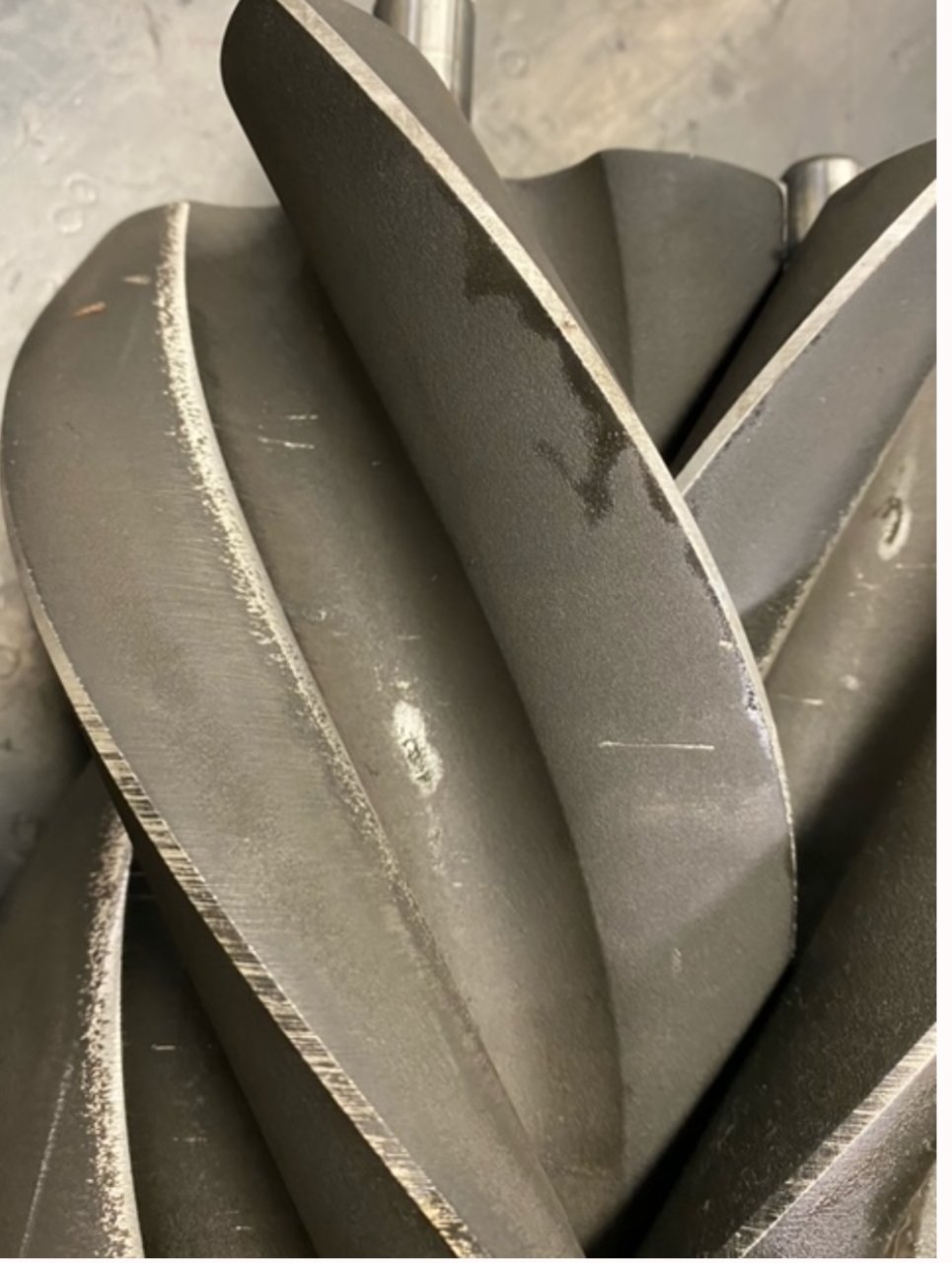

    I paid $3k for mine, minus the tune, fuel pump, and the oil cooler lines. $6k is insane, once you add in the shit it's missing it's the same price as new.
    For the record a blower rebuild from SCOL is $1250 iirc, assuming the rotors themselves are fine which unless you sucked something in they should be.
    mustang67408, HulkSmurf14 and reywcms like this.
  26. Oct 16, 2022 at 2:17 PM
    #3686
    e30cabrio
    Oct 20, 2017
    #10410
    6,522
    Which would be clearly visible I assume?
    I'm thinking I'll offer 2k & see what happens.
  27. Oct 16, 2022 at 5:20 PM
    #3687
    snivilous
    Apr 16, 2019
    #29192
    4,997
    SW UT
    I'd think so, mine ingested a rock or a socket and had visible marks on the rotors. My rotors also became mistimed which might explain the wear on the edges. New rotors are an additional $1250. For the record this was of my doing, the blower was fine when I recieved it used and this was a few years later.
  28. Oct 16, 2022 at 5:43 PM
    #3688
    e30cabrio
    Oct 20, 2017
    #10410
    6,522
    Thanks, I'll hold out for new. I have the weird Whipple recurring dream. Can't find anyone that can provide input.
