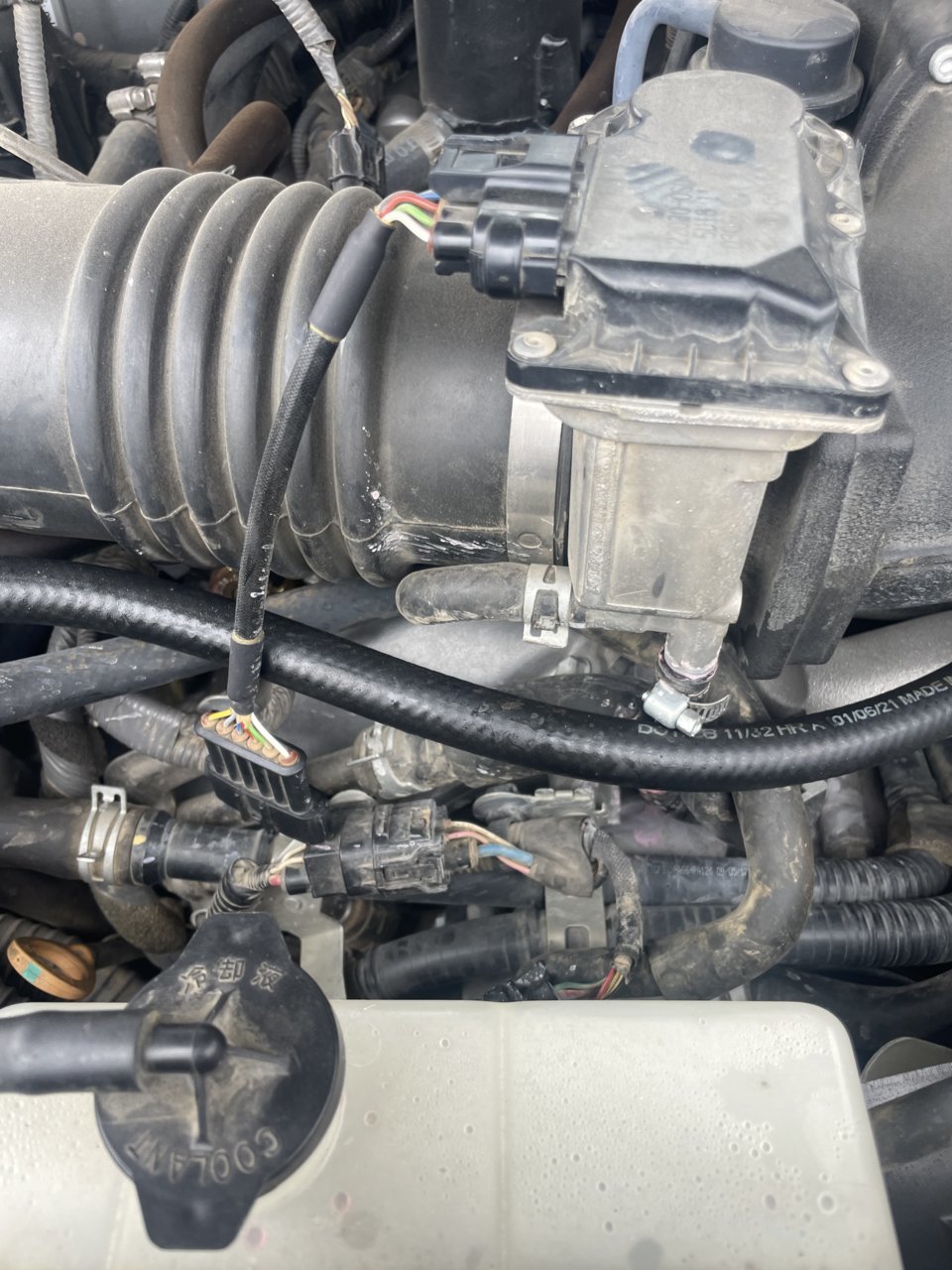

    So is that sensor wiring being stretched a common issue?
    Saltyhero13 likes this.
  10. Oct 13, 2022 at 4:47 PM
    #3640
    nobodyintexas
    nobodyintexas What?
    Jun 22, 2020
    #48303
    6,923
    South of Houston
    S/C'd 2020 White 1794 Tundra
    my understanding is - it is not common.
    I'm gonna finagle a support for the harness. to keep it from downward stress.

    Is the new harness longer? Better connectors?
  12. Oct 13, 2022 at 5:31 PM
    #3642

    Another P0121 CEL issue :-( Buddy of mine

    have him continuity check it
    see if the same pole failed as mine
    just wondering

    1. I just did the @reywcms thing that seals the passenger wheel well from the engine bay. I used Gorilla tape. going to the boat today - will monitor IAT.
    2. Zip tied the Harrop harness to the intake tube in such a way as to relieve any stress on the harness.
