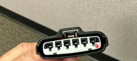

    So can I test my harness to see if it will die? Are the connectors crap or does the lack of slack in the cable cause problems? Mine currently has some slack if that means anything.

    Only thing you can really check is continuity on each wire from one end to the other, and the resistance of each wire. You can also test the insulation with a megger if you had one, but it probably won’t tell you much since it’s looking for leakage to ground which is probably not the cause of the issue.

    Harness update.
    the marked pole (below) was glitched while checking continuity.
    you have to give it a little wiggle and it will drop connection. this finding supports my error issues.
    who amongst the masses knows what connection that is?
    it was on the other side of the harness that was glitched.
    omgboost and Silver17 like this.

    I’d be curious if you removed that pin from the harness if the pin is poorly crimped onto the wire. You would need one of those little dental pick tools to remove it. It looks fine otherwise, so it must be a pinning issue.

    no tellin'
    but if you wiggled the wires continuity would drop.
    he was using alligator clips on the connections - so I guess whatever is going on in the black part of the harness is the culprit.
