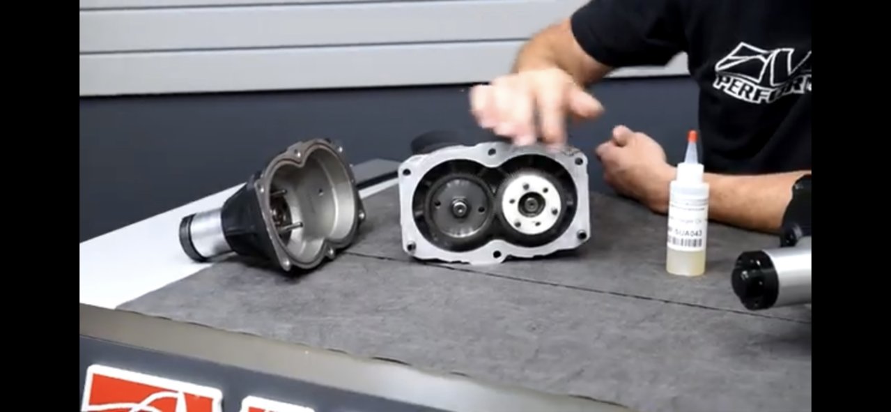

    Man, in that case I better find some more local magnuson friends on the east coast. You guys will eat through 3 couplers on your trek across the US to help me out. I’ll have fashioned all new wiring harnesses for myself out of roadside debris by the time you arrive.
    On a serious note, and only 10% to poke fun…I would be curious about pieces of the worn couplers falling into the oil (it’s inside the same cavity) and getting ground up further by the rotor gears and getting into the bearings. I’ve only ever seen 1 blower have the bearings actually totally fail though and subsequently take out the engine. Point being, if anyone notices coupler noise I’d get it changed out, as well as the oil ASAP.

    My intent wasn’t to scare anyone. I was truly being genuine in the suggestion. I’ve never seen the magnuson for these trucks apart, I was just going off the construction of this video that I had watched for a VMP unit in which it appears to be constructed with the coupler hanging out right above where the oil resides. The oil is common to the front and back of the blower as the gears on both ends rotate together with the gears meshed. I assumed they were all constructed similarly.
    https://m.youtube.com/watch?v=3NFfZaS1XBU

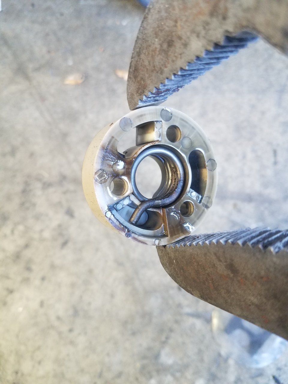

    At least it's not a spring loaded coupler like the taco! My spring had deformed and was trying to poke out the side when I swapped to a solid coupler
    Not my pic

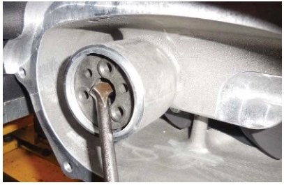

    I updated my post since I did have one thing wrong...maybe (hopefully not more!). Been awhile since I pulled the nose cone so going off of SCOL photos:
    The coupler is in the front compartment which is isolated from the gears. Where I was wrong is that the coupler is not completely isolated from the rotors, since in the following picture I think that is the rotors you see which makes sense. So the coupler if it disintegrated would have the capability of getting to the rotors, however that would require the coupler breaking apart which is different from the failure mode of the holes wallowing out:

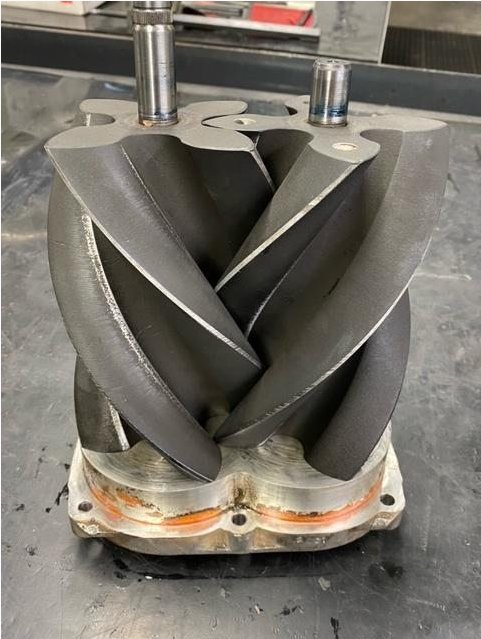

    The rotor assembly has the gears at the back, which in the following picture is the block at the bottom (or my assumption). The top shafts I assume slide into bearings, with the longer side then interfacing the coupler, point being that the oiled compartment (block on the bottom) is isolated from the coupler:

    And to add after watching that video, that supercharger is using the rotors flipped around from how ours is. Their nose cone interfaces directly to the timing gears, so all of that is lubricated. However there is no oil pass through to the back of that supercharger shown, so the bearings that hold the far side (intake side, in both their case and our case) are not actively lubricated. Only the timing gears, and anything in it's vicinity.
