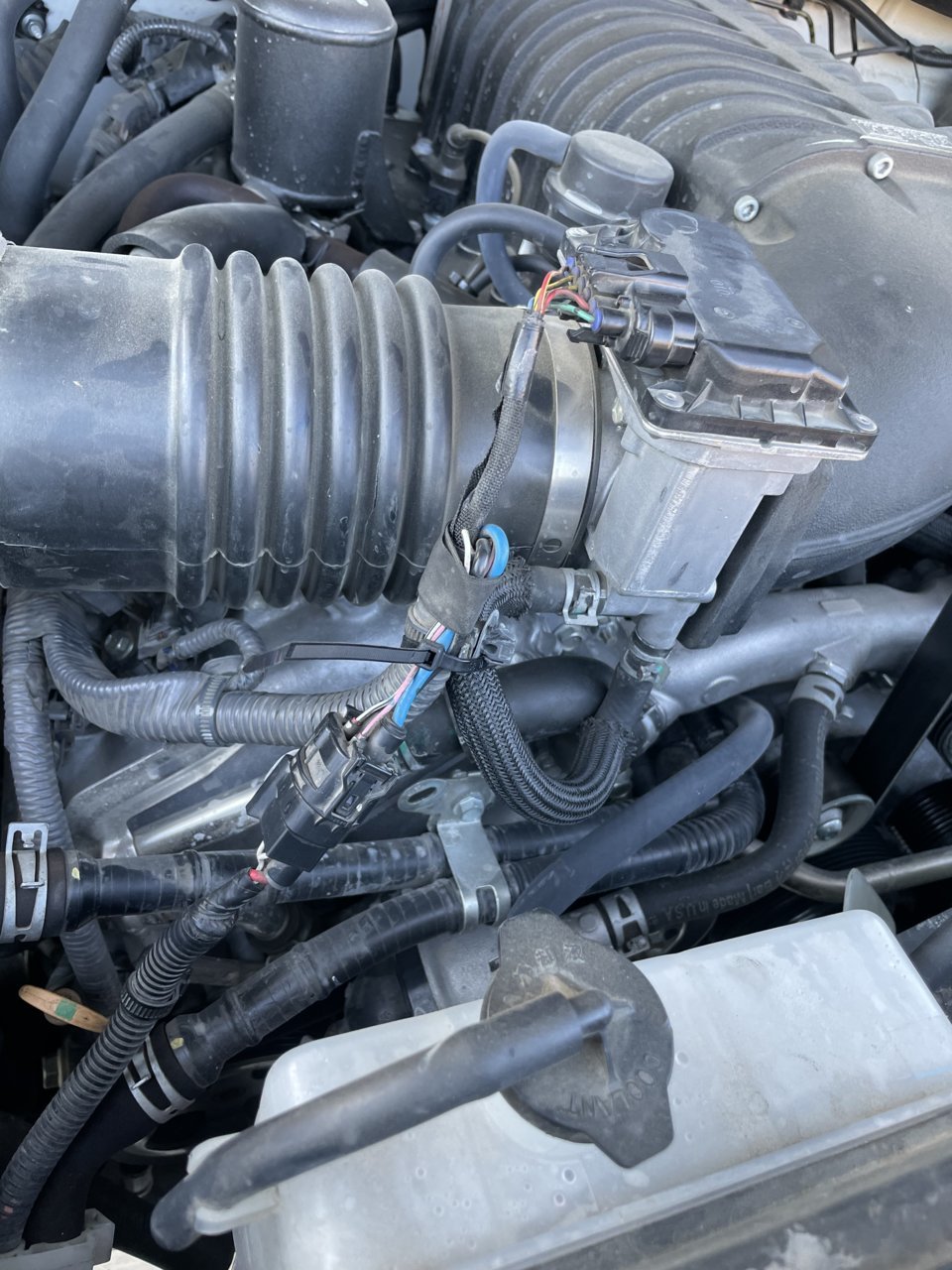

    I think I’ve been dealing with this same issue. I recently just removed that harness and finagled the factory one to reach. I’m hoping that solves the issue because I kept getting that intermittent P0121 and it would go into limp mode.

    Yep! That’s what happened to me :-( Code P0121. First symptom was she was revving high and crazy at start up. Engine sounded like I had some race cams lol. Harrop sent me a new harness, so far it’s been good. Do you mind posting a pic of what you did?

    I had P0121 hit me this morning. full limp mode on I45. 7 codes can't see the actual codes in the SGIII. they are all emissions based tho.
    10 minutes later...after running fine, I'm exiting beltway 8 onto 225...bam full limp mode the gas pedal is unresponsive.
    shut off the engine...attempt to clear codes...start it up and it runs fine.
    codes will NOT clear.
    Now I'm scared to drive this bitch.
    What do I ask Harrop to send me?
    FOCK!
    Once the sun rises....I'll go fiddle with the harness. but I'm calling Harrop.
    I sent a message to Chris Mentrup @ Harrop....he's been golden to me.

    Chris @ Harrop hollered back to me in minutes.
    I need to check the harness - in case it wiggled loose.
    he will rush another one out if it's not a wiggle solution.
    Harrop is awesome.

    You could just do what @HonorNotInner did and re route the factory TB harness to reach and plug in. It’s literally nothing but a 6” or so extension of the harness to help it reach. I may do that on mine to eliminate the possibility of that problem happening to mine entirely. Reroute it and hold the tension off the connectors with some zip ties and most likely problem solved.

    ya I did the throttle body bypass and zip tied it to that so there’s no tension pulling on the wires at the harness…. Didn’t mean to post the same picture twice.

    Hopefully it’s just a loose connection. I did the same thing when I had the issues then next thing you know… Bam! TPS was fried lol. I had to replace my TB

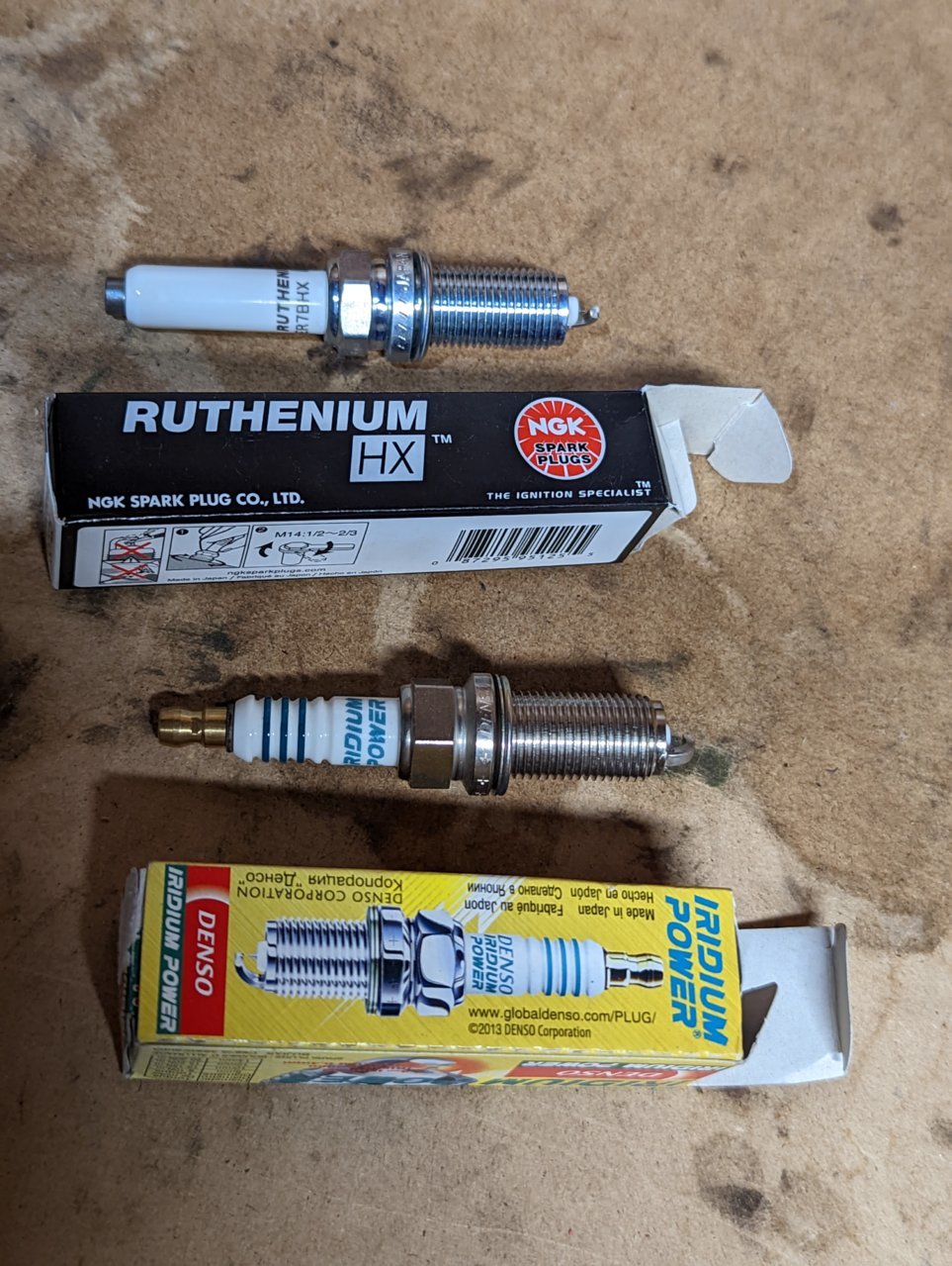

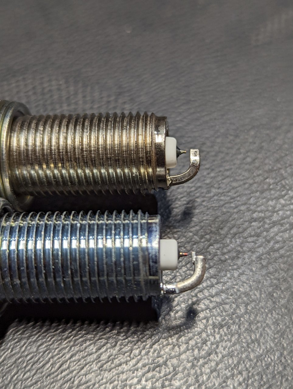

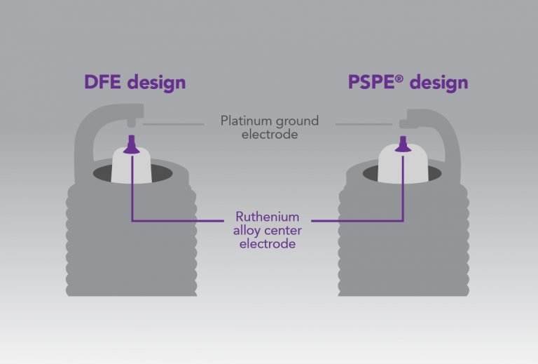

    Did some research on Ruthenium vs Iridium and here's my findings. TBH, not a whole lot of differences or opinions on which is better. But Ruthenium makes Turbo/Supercharger specific spark plugs, Iridium has only one design. Took a pic of the two that I had laying around in toolbox.
    Ruthenium HX is available in two designs to best maximize the performance of your engine.
    DFE (double fine electrode) maximizes ignitability, while reducing emissions for low-heat engines. This NGK-patented design is recommended for non-turbo applications.
    PSPE® (projected square platinum electrode) provides the best ignitability and service life for high-heat engines. This NGK-patented design is recommended for turbo and supercharged engines.
  25. Oct 4, 2022 at 8:29 AM

    Ruthenium on bottom, Iridium on top

    Back in the cobra/lighting days we ran NGK TR6s or Brisk. I did some testing against the brisk plugs and the tips were an odd shape like those above. They eventually broke off and car ran like shit. Went back to TR6s and never looked back. Had them gapped at .28 seemed to be really happy there at 700+whp and 950whtq.

    Was thinking the same thing, looks like an additional failure point of that little tang breaking off. If you're having spark blow out issues from so much boost I can see there being benefit, with how low our horsepower/boost is I would be amazed if there's any practical difference.
