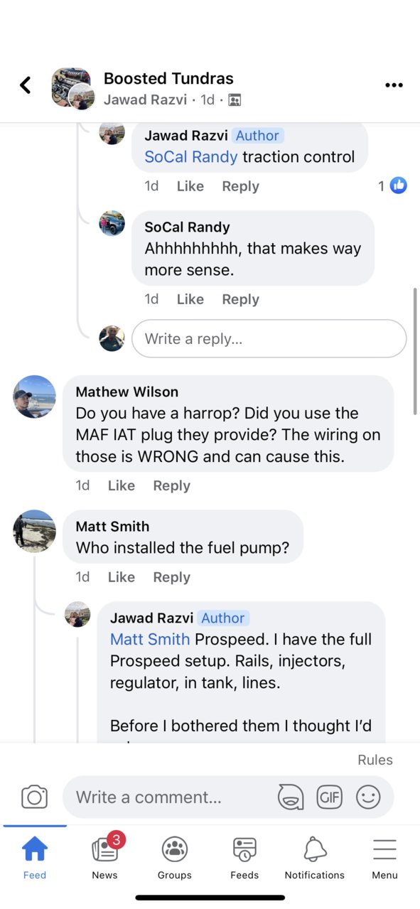

    Anyone heard of this? Regarding the MAF IAT plug

    I know that same guy had issues when it was first installed with a faulty harness for what I think was the throttle body. Harrop sent him a new harness and problem solved. I don’t know anything about it to say Mat is wrong, but I’d take whatever that guy says about the Harrop with a grain of salt. For some reason he always shows animosity toward the other brands, and I think it’s cause Magnuson started using his VF Tuner software for their tune. The guy isn’t stupid but he does seem to be petty at times. You could ask him to elaborate and enlighten us. If it was wired wrong I don’t see how it would work, or be tunable like that. My IAT reads fine and haven’t had issues so far is all I know.

    Sorry if I missed it but what is the issue?

    Yah had the same issue with my TB harness too :-( Cost me a new TB lol Harrop did send me a new harness and it’s been good. That dude might be talking about the TB harness.

    He might be talking about the TB harness. I had a bad one and it shorted my throttle position sensor lol . I went on full blown limp mode, couldn’t get the truck to drive over 5MPH lol

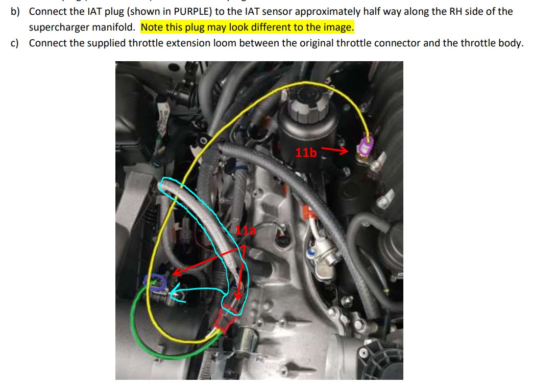

    So I am on the throttle, and it just cuts off like a fuel cut, even though it may not be that. The video shows me get on the throttle again and it goes fine. 2 videos of same issue. I did not get a CEL on the dash, however using OBDCheck BLE+ module, I get the P0101 code.
    I have not updated FB post, however I used the advice of Mathew and bypassed the IAT breakout cable. Meaning the harrop breakout cable plugging into the MAF is disconnected, the original MAF cable is disconnected from harrop supplied breakout cable and is plugged backed into MAF at intake pipe housing. The IAT end is still plugged into IAT sensor, but other ends are disconnected for the time being so it's not doing anything. I tested this daily driving and I have had no issues or codes. I then went and romped on throttle in same manner in videos and I have since had zero issues. I also have no codes popping up in OBDCheck.
    I do think harrop supplied cables are finicky. I had issues with the throttle extension loom and would get the CEL and dreaded 5mph limp mode which is dangerous. The new cable worked for a bit but then it would randomly occur occasionally. I have since removed this extension and hardwired my own solution. No issues for 5 months. So it's not farfetched this other Harrop cable is giving issues.
    Now regarding the IAT sensor cable not being used. Here is what my uneducated guess is. The data that the IAT sensor provides is probably not used on an actual tune. It's more important when you are running stage 1 and trying to fool the stock ECM to adapt. Whatever it is, it's working great now. Just giving it a more long-term test.

    So currently the ecu isn't reading iat temps or maf? How will the ecu then adjust timing/fuel etc? I would disagree that IAT wouldn't be used in some form in the tune.

    Let me clarify, using this image from the harrop installation manual, I added my drawing colored in AQUA. I plugged this OEM MAF cable back into intake tube/maf sensor.

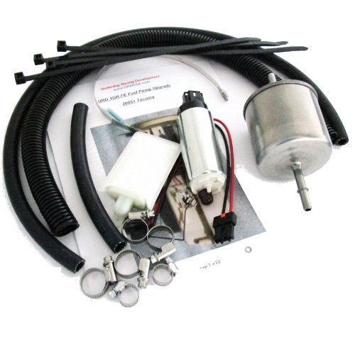

    Question. I'm looking to pull the trigger on the Walbro 450 fuel pump on ShopFigs but is it just a pump or a full kit like the URD kit? I'd prefer to get a kit like pictured. Anyone know where to get one? URD kits stop at 340 pump.

    There's nothing on the URD kit that is particularly special. The pump itself when you swap it out you just cut some wires and crimp them back together and zip tie the new pump into the fuel pump housing/canister thing, then take some fuel hose and hose clamps and connect the pump outlet to the tank pass through. All the filters and other shit included in the "kit" isn't needed. Now if you want to convert your truck to that filter setup, that can be done whenever and is an off the shelf filter (maybe you can buy that from URD or find the part number for it) which also uses some hose clamps to connect. Honestly the URD kit is pretty janky, and if it was me I would just buy the Walbro pump, buy some fuel hose and two hose clamps, and you're set.

    Cool, thanks. Guess I'll just piece it together.
    Just placed order for the Figs coolant tank. Gonna pick it up from their shop when it's ready since it's super close to me, didn't realize that. Will see what else they got laying around.

    Just be sure you're using submersible fuel line for the pump.

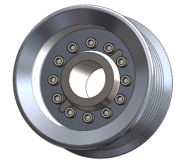

    I just ordered the prototype Magnuson hub and a 2.3" and a 2.0" pulley. Fat lead time to keep it cheap, so won't see it until November. So @M3Tundra-JK maybe I'll have that figured out before you end up buying a pulley.
    I tweaked the design a bit and added a second shear feature as well as increased the thread engagement of the bolts by 50%. The hub is made from 17-4 stainless and the pulleys are from 7075-T6. If these end up working I'll do a group buy or my own production run.

    Sweet! I'll hold off on getting a pulley for last. I mean, I do have the regular pulley on the s/c. Is there a need to add the grooves to the pulley ridges for extra grip?
