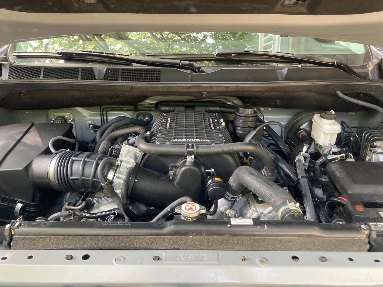

    You could open the fluid reservoir and see the fluid moving with the engine running. You might be able to do this with the key in the RUN position without the engine running as well. I can hear my pump run from in the cab when I turn the key to RUN prior to rotating it to START. You may need to jump out and walk to the front to hear it. I suspect that it's mounted up by the radiator, not sure with the Magnusson layout. Follow the hoses and you should find it.

    This is correct ^

    Does the tundra Magnuson intercooler pump run occasionally when the truck is off like the Tacoma does? For the Taco I will kick on for like 5-10 seconds every so often when the truck is parked and no key in

    Mine does not it’s wired to ignition on.

    Same on harrop

    This was good advice just tried it out. With the ignition in run you can easily hear the pump, it’s surprisingly loud. Plus removing the intercooler reservoir by the supercharger was obvious the fluid was moving there too. So yeah I guess in 70 degree weather the intercooler is not much warmer for regular driving.

    What do you think the reason for this might be... I certainly can't think of one. o_O

    I initially used a different ignition activated fuse for my pump as I already had 3 other things pulling off the ignition fuse that is recommended in the install instructions. Occasionally when the truck had been sitting it would fire up the pump for no reason and it would run for 45 seconds or so. I eventually rewired it to the recommended fuse so it would stop potentially draining the battery.

    I'd wager that it was probably connected to a part of the circuit that fires up once in a while do deal with the fuel vapor in the fuel tank. I can't think of it's proper name at the moment... Every once in a while, someone who's unfamiliar with it starts a thread asking about a ghost in the machine or something.

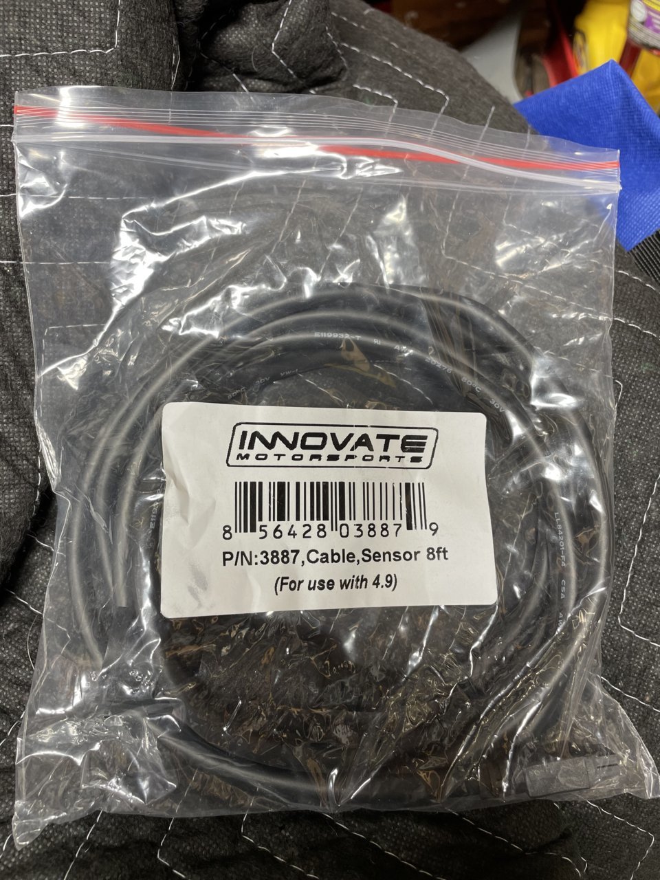

    I don't know if anyone answered this, but as I recall I did get the extension since I mounted the afr sensor on the passenger side collector. I think the cable length included is like 3ft.

    I've found two sources online that say it comes with an 8ft cable and haven't found anything about people needing the extension.. still not sure if I need it? lol
    -https://www.summitracing.com/parts/inn-38920

    Pinging usually sounds like sand hitting something. Little tapping noises. What you're describing very well may be pinging. The stock tunes are rarely the best, though that's not to say they don't work fine for most, but can most certainly be improved on such as what you (may be) describing. VictorG has shown evidence that the (older) Magnuson/TRD tunes resulted in a lot of timing retard to prevent knock, which would match with what you're seeing--assuming it is pinging.
    Also I don't entirely follow your comments on the intercooler lines. The intercooler at the absolute coldest can only be ambient temperature--its not like the AC and can chill the air below the outside temperature. The intercooler really is only functional in a high heat event where the fluid can pull out heat because it's so much hotter than the ambient (outside) air temperature.

    Fuck it, just get it and see what works. It's been years since I installed mine so Im probably misremembering; 8ft sounds like plenty.

    I remember that you and I had this conversation before I ordered mine. I found my invoice and don't see an extension on it. I had mine installed in the same location as you too. The description on the website doesn't give cable length.

    I was thinking how we had the same conversation too :rofl: well there's the answer @V10Ace ! Maybe I'll remember next time now.

    Oh I just meant I expected the intercooler to be much hotter like radiator hot where it’s nearly too hot to touch. So overall a good thing it’s actually “cold”.

    I have a brand new one in the box in my garage. I’ll go out and measure soon. It’s 8 feet.
