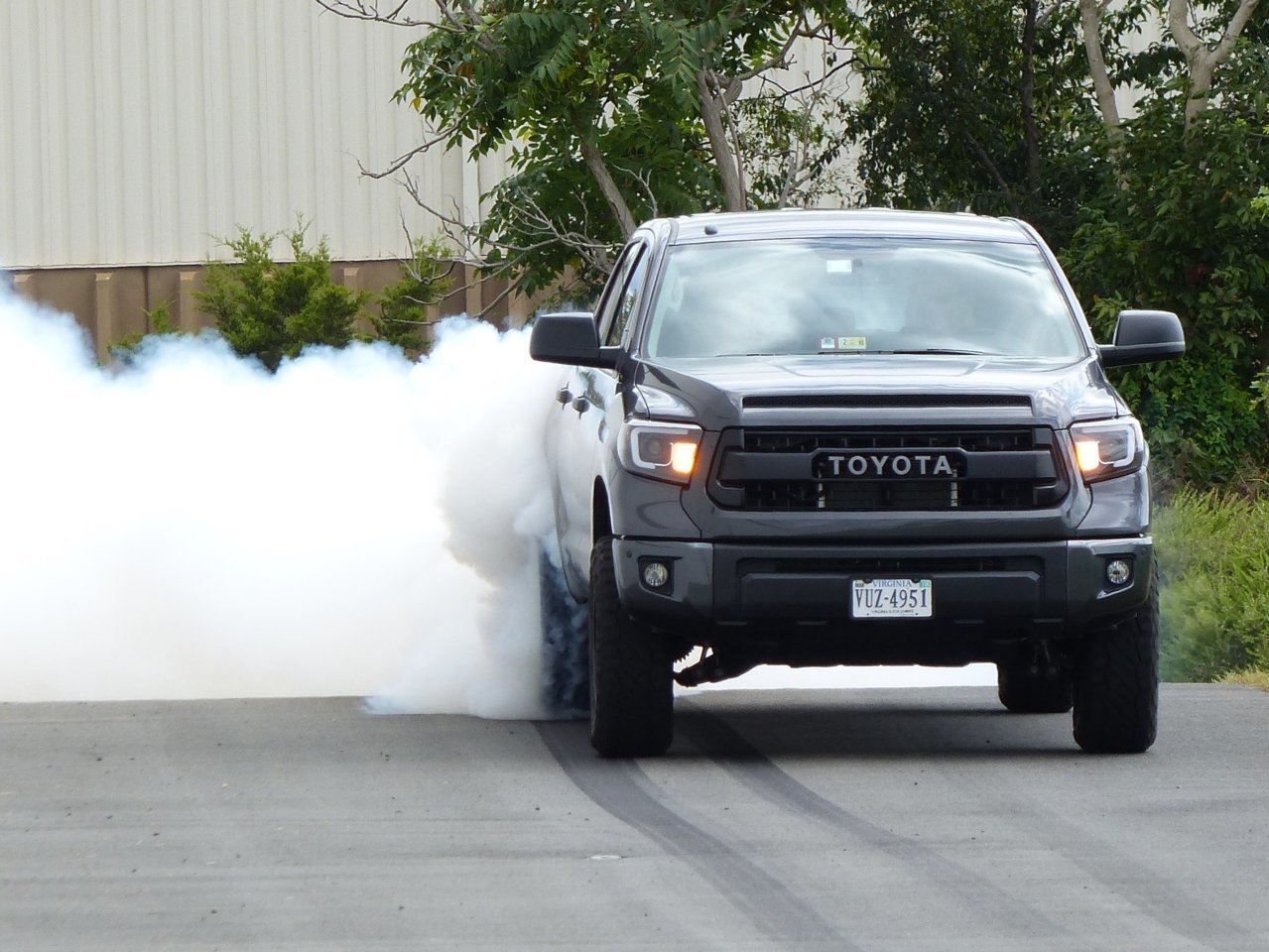

    Sequoia is a 2014 when I put the supercharger on there was no tune available for it so it had to be a custom tune. My Tundra is a 2009 even though it looks like a Gen 2.5, when I did my long travel I converted the body over and put the 2.5 glass on it. The last Tundra I had with the BullyDog tune was the same year as yours a 2017, loved that truck here's me being an idiot in it.

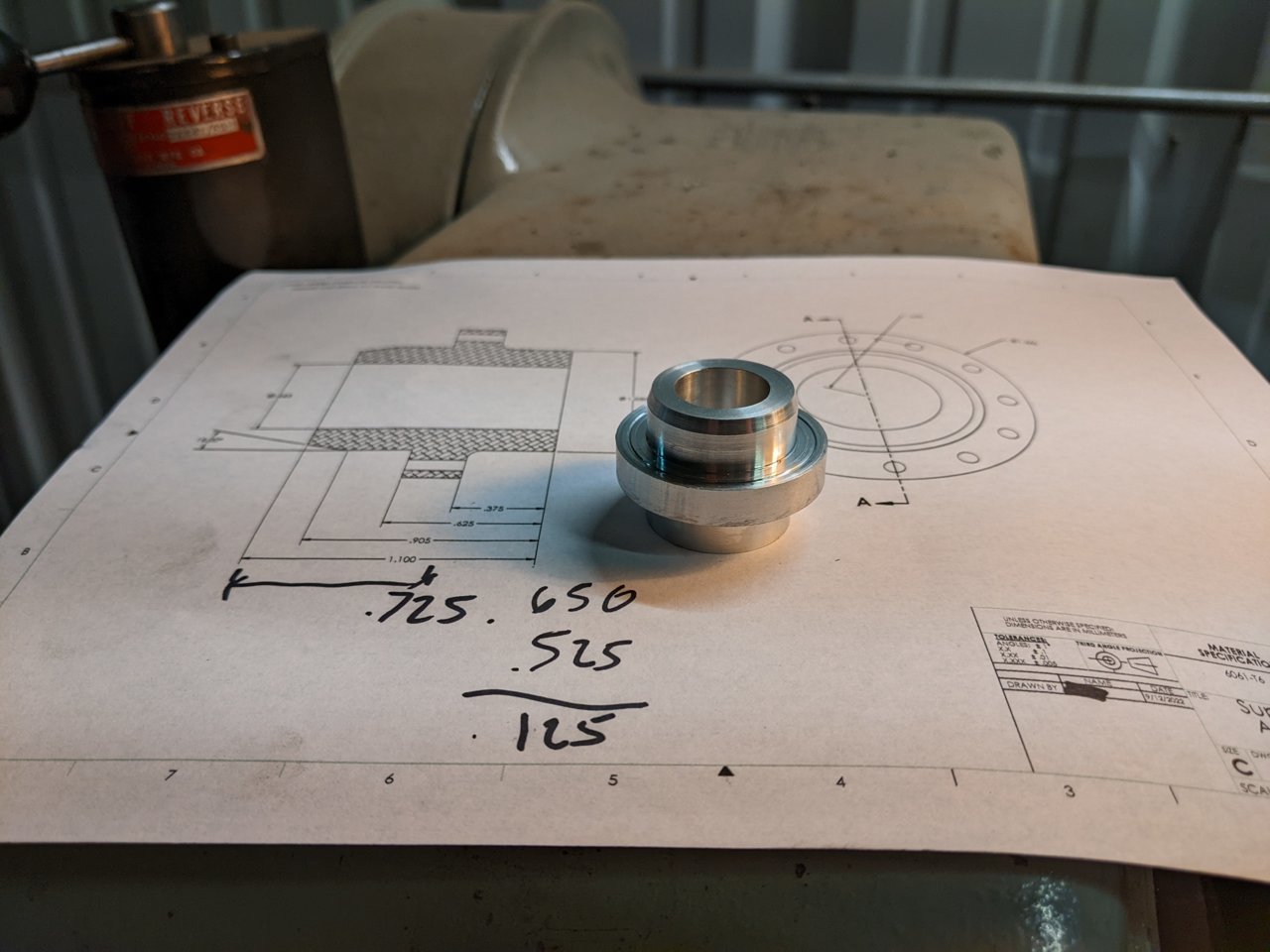

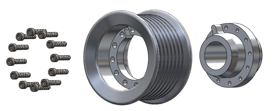

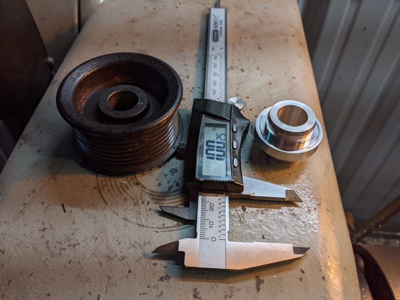

    I made the pulley hub for my modular Magnuson pulley. With how tiny this thing is I don't trust it out of aluminum, though I also haven't done any analysis so good chance the stock style pulleys are just very overbuilt. But considering the size and my intention of using helicoils, it makes more sense to just have the hub be out of steel. I might end up making the pulley out of steel too, especially on the 2.000" pulley where material is a premium. And since the pulleys are smaller they'll have a drastically lower moment of inertia so will accelerate faster regardless of what material they are, though I doubt it'd be remotely noticeable anyways. I need some larger bar stock to make the pulley, with the intention to confirm the belt properly engages. After that I think I'll feel confident to order some samples.

    @snivilous what are we thinking this will make boost wise? 10-12psi?
  16. Sep 12, 2022 at 6:35 PM
    #3286
    snivilous
    snivilous [OP] snivspeedshop.com
    Apr 16, 2019
    #29192
    4,997
    SW UT
    300k+ Supercharged 2008
    No idea :D Viktor said 14psi with a 10% over drive, but we know the rotors rpm isn't linear to boost, so 10-12psi seems realistic?

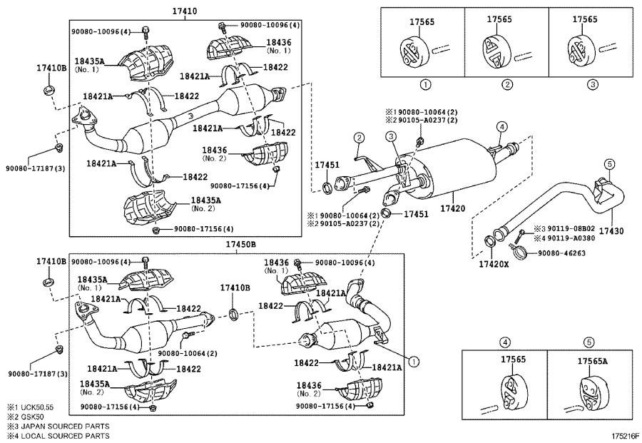

    Does anyone know if the front cats are the same as the rear cats? I was considering removing the rear cats for 2 reasons.
    1. More aggressive exhaust tone
    2. If the front cats burn up which I know is more frequent on these trucks when supercharged, than I can have OEM spares to put in their place.
    I’ve seen some people say the rears are just resonators but I kind of doubt that’s true. Just looking for confirmation.

    I just tried looking this up on a Toyota dealer website. Because the cats are all welded to differently shaped sections of pipe, the part numbers are different. So that method didn't work. The stone guards are different from front to rear too. I'd go out underneath my truck, but I can't see the cats anyway with the shields in the way...:rofl:
