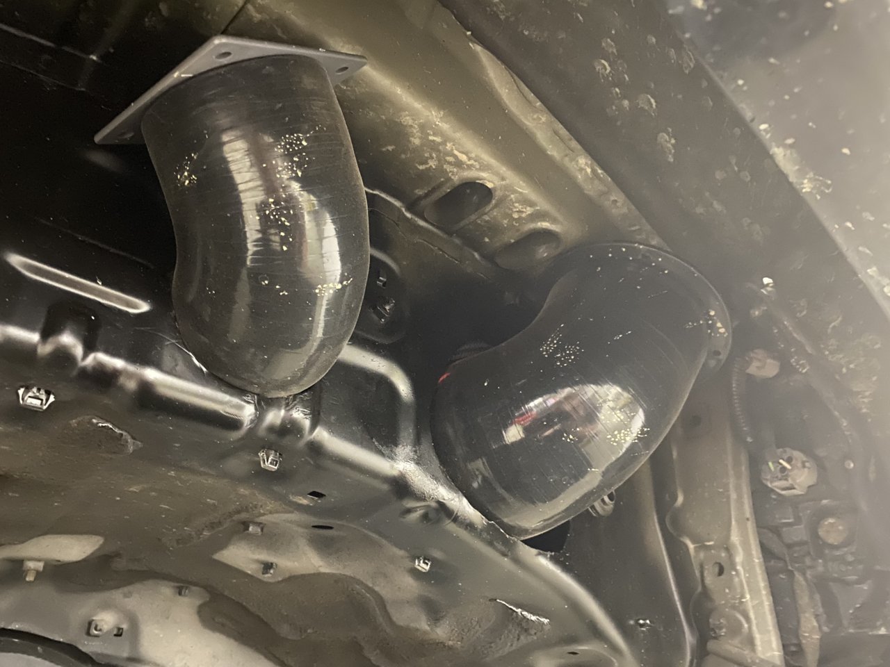

    C4633863-476F-4D69-8464-CDCFE6E91AE9.jpg Hey @reywcms this is my solution to no fender liners on my long travel. The SABM is a 3 inch 90° silicone coupler. And the stock hole I have a 4 1/2 inch to 4 inch silicone reducer coupler. I did have to enlarge the stock hole but it fit around the stock airbox and just tightened it down with a large hose clamp works great when the wheel hits it the silicone glasses I also put plastic on the ends of them to keep from collapsing not sure it’s necessary. Still need to seal inner fender around the coupler some and I might shorten them about an inch but its working great. This is my third variation of something and it’s by far the best solution I found if you actually go off routing
    ViktorG and reywcms like this.

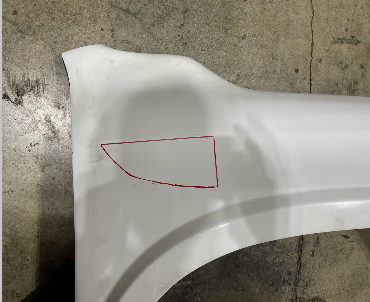

    Kicking ideas for the fender vent to help remove heat away from the intake port. I'd cut this out then just add black mesh grill screen.
