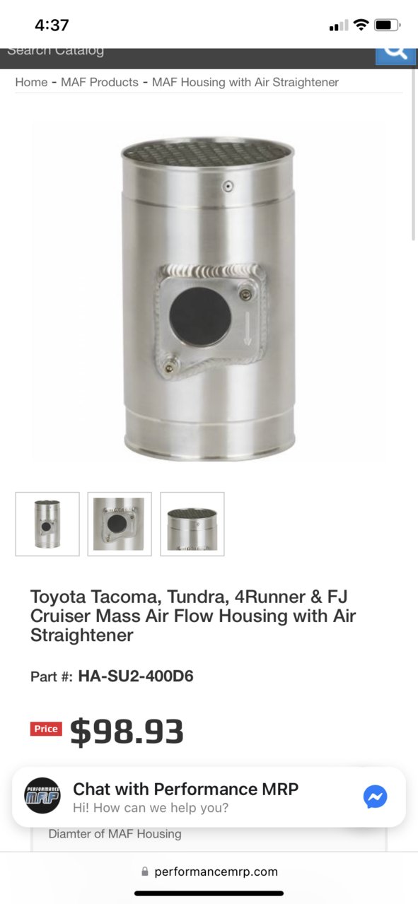

    reywcms

    #72040
    7,031
    Rey
    Beaverton,Oregon
    2017 Tundra Platnium
    Too many mods to come

  3. Sep 6, 2022 at 1:58 PM
    #3123
    nobodyintexas

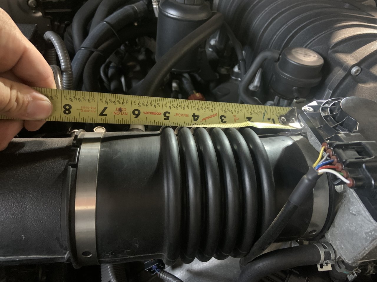

    I did notice this, but I think all of the tubes are referred to by OD. I measured my stock tube at the MAF and it’s roughly 3.5” OD. So if this is 4” OD, it’s an improvement.

    Ok, so I just measured it more precisely with a flexible fabric tape measure instead of eyeballing a regular rigid tape measure. I measured the circumference and it is exactly 12” OD circumference which comes out to 3.8” OD. So that might make it 3.5” ID depending on the wall thickness, but not positive. In this case, this air straightener piece would be .25” larger. Is that enough to fix the voltage ceiling issue….tough call? It could also be worth asking if they will custom make one 4” ID, maybe it’s no big deal for them to do that.

    Im thinking either way it should maybe be rescaled in the tune for the MAF, since on my current tune above a certain RPM my tune is likely just guessing since it’s off the map with MAF voltage for him to tune it more precisely. I don’t want to have more air than it’s tuned for and then risk running lean. I think he figured just tune it rich so it won’t be a problem, but its probably not optimal as it currently is running without a proper MAF reading beyond a certain RPM.
