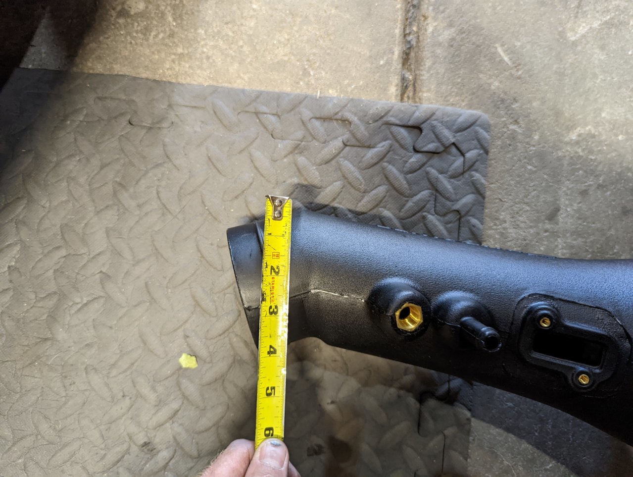

    I think the only truly consequential measurement as far as Intake diameter is the diameter of the part of the pipe where the MAF is located (and likely the couple inches before and after the MAF). This ultimately is what the tuning and MAF voltage issues come down to.

    I think this is very much true. The Stillen is funky cause it uses a 5.5 inch filter or something and necks down to a 3.5.

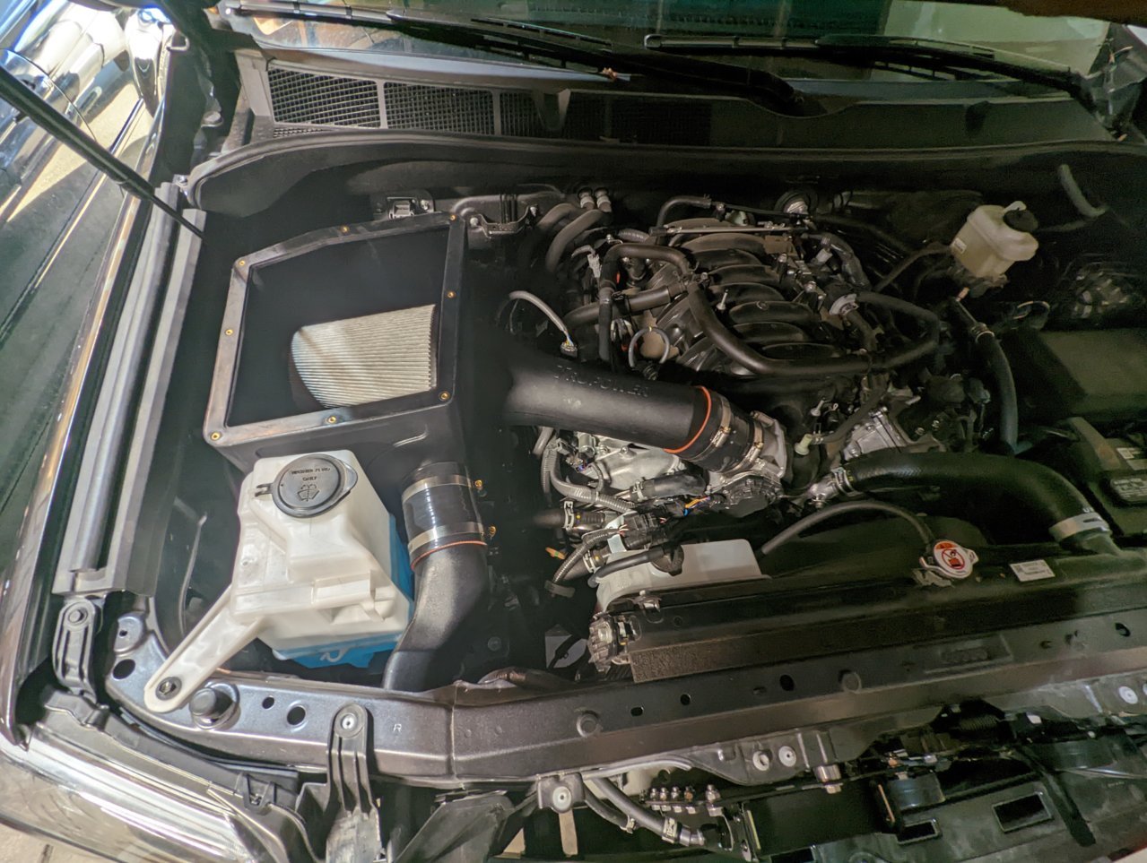

    Ok took a nap and decided to not be lazy. Finished the install. And my earlier note about 1 of the 2 bottom notes not working was wrong. I am going to leave the factory front deflector since I've already cut and run the transmission cooler lines through it and don't want to fuck with uninstalling those. Air can still get to the secondary front inlet fine. I'll eventually cut a hole in the factory air deflector for the stillen inlet

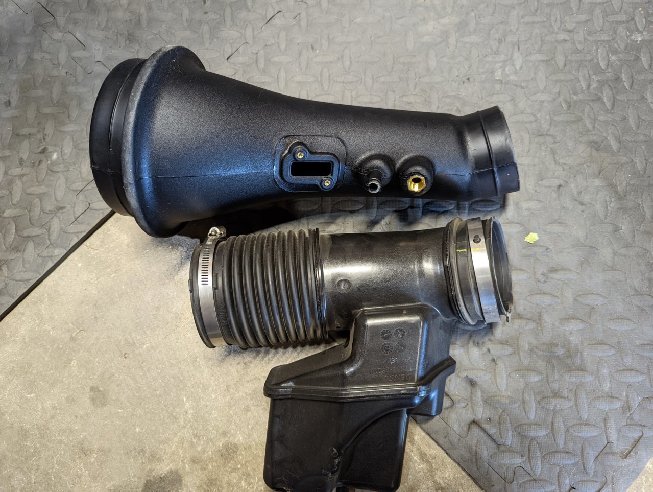

    So that secondary inlet does get blocked off when the grill is reinstalled. So did some cutting. Will clean it up in the future

    Thats what I did @M3Tundra-JK . My stock deflector was already butchered so I just cut a hole for the nozzle. Once I got the basic shape I used tin snips and a file to shape the hole with a little more finesse.

    I did the quick and dirty with a bunch of 1/8" drill bit holes, and then connected the dots with a hot razor blade

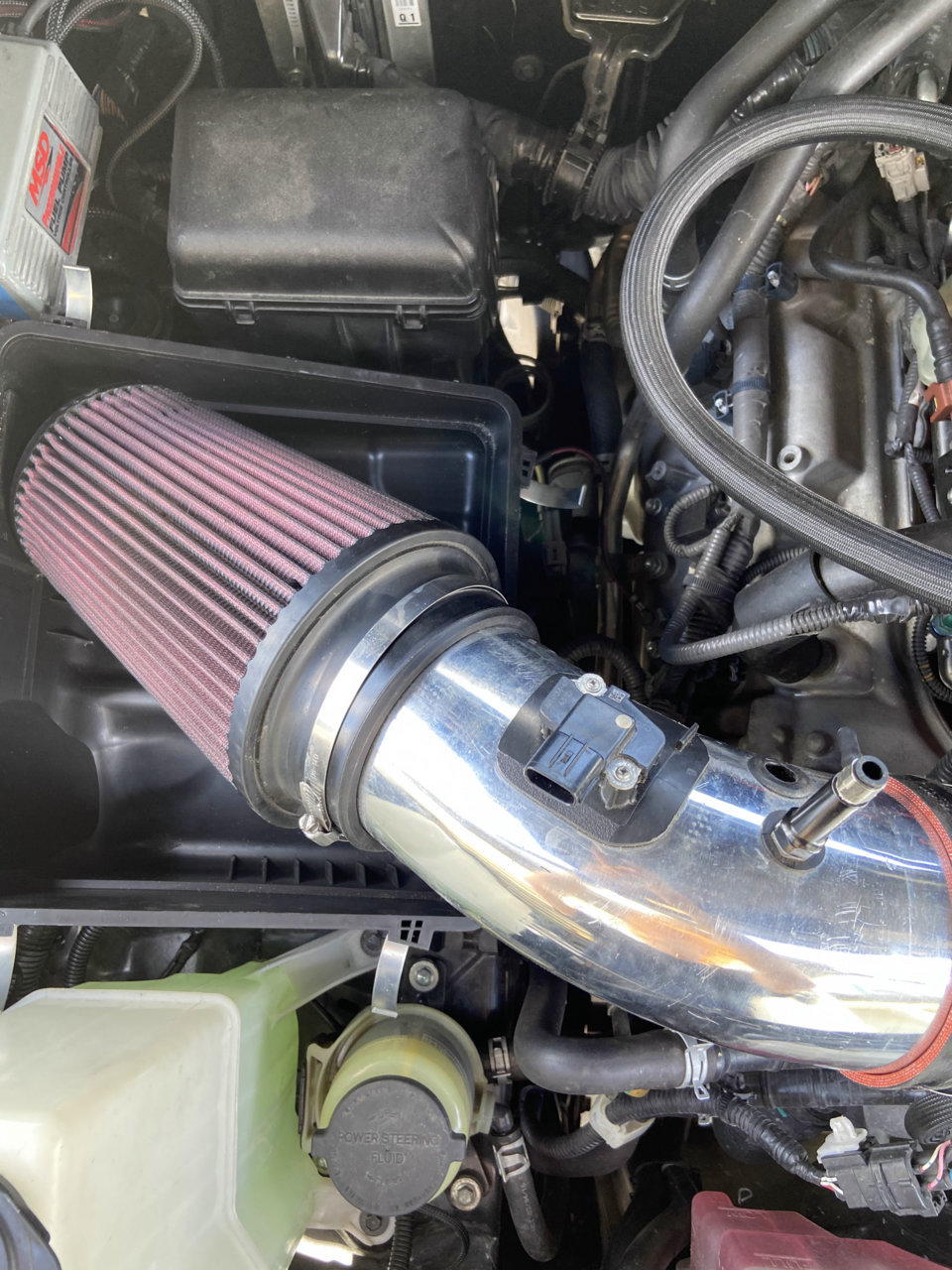

    TRD Supercharger, Ported SC inlet, RCF TB, 4.5” intake, WMI, 2.38 pulley, custom tune, DW660 inj, aeromotive fpr, msd boost-a-pump

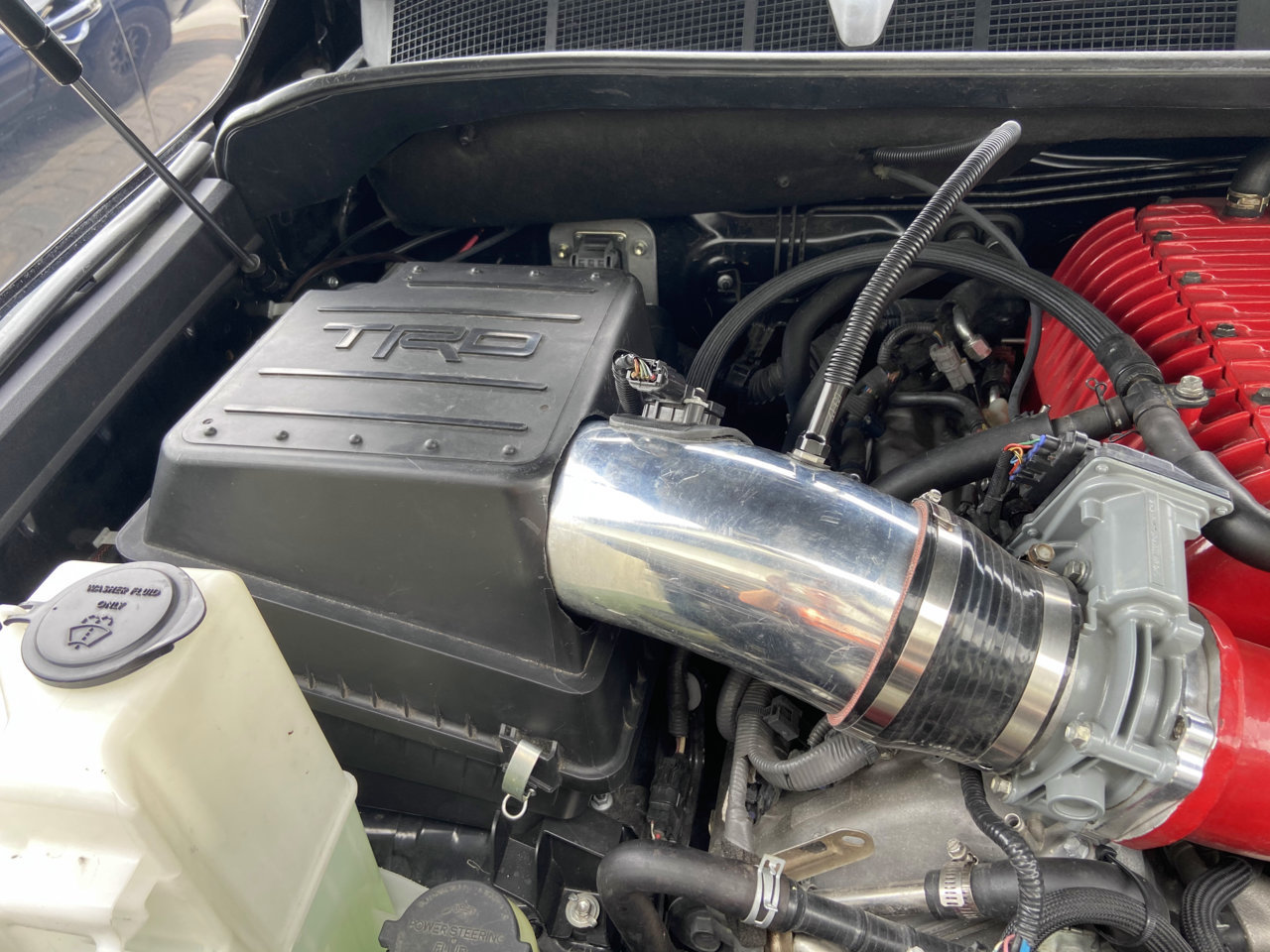

    This is what I did.
    Unfortunately I did not keep track of part info but everything was relatively easy to find.
    *4.5" aluminum tube with a 30• bend, cut to fit
    -cut the maf housing from OEM intake and adapt to new pipe with redneck engineering (jb weld/rtv silicone/duct tape/moonshine/etc)
    -drill and grommet new hole for intake air vacuum hoses.
    *4.5" rubber coupler to the stock throttle body(3" or 3.5 for RCF.. only going off memory, check your own)
    *4.5" flange cone filter
    *Make your box to fit using poly sheets or gut a stock box and squeeze the cone in there.

    Are those no weld vacuum and MAF? If so that opens up a whole lot of options.

    The maf connection is literally the oem stock maf housing that I cut out of the stock n/a intake. Then I just cut a hole in the new pipe large enough for the sensor to clear it and then attached it with a bead of RTV black silicone to hold the stock plastic tight to the metal pipe while also creating an airtight seal.
    (Just to clarify, I test fit it with the sensor while making it and REMOVED the sensor to use the silicone, then reinstalled after it was cured and confirmed secure)
    It's been that way for a few years and never budged. There's also the option to JB weld it, or screw it/bolt it. But I figured the less intrusive option was better so long as it's secure. The actual sensor is held in place using the stock screws and stock mount.
    There are 2 vacuum hoses that attach to the oem tube, one larger (the hole you can see in the top pic behind my WMI jet/nozzle) that comes from the 3 way "T" on the pass side of the SC. The other attached to the oem FPR for atmospheric reference. Both can be connected to the new pipe with simple fittings and drilling the appropriate size hole.

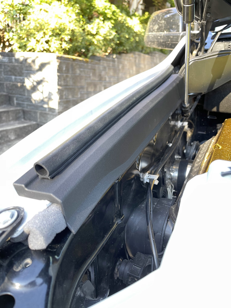

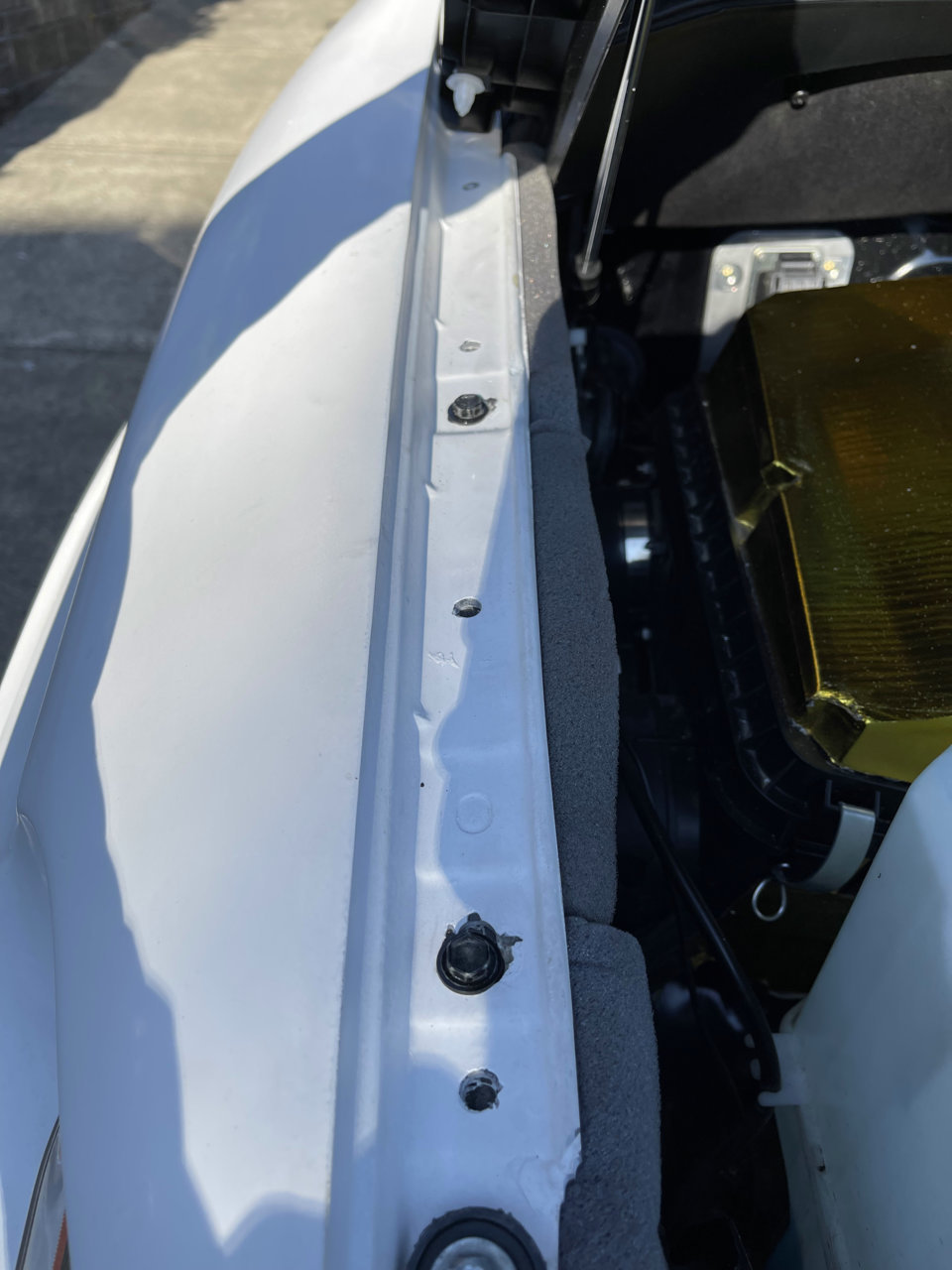

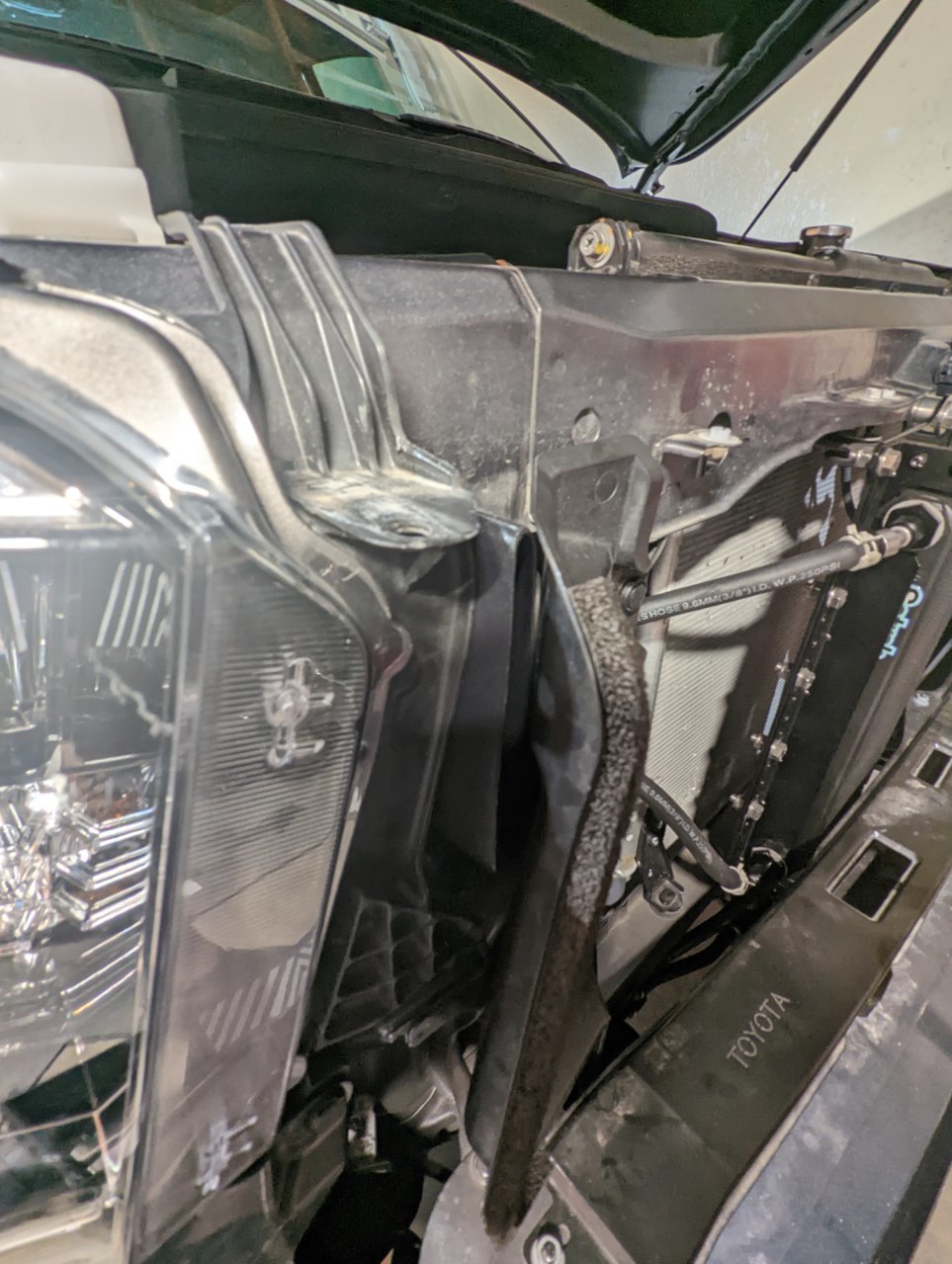

    Found the oem part for the hood seal/air gap. Got that installed with my foam to the adv glass. Heat should have a hard time getting through there now. Another idea I'm working on is after the liners are installed is adding a vent in the passenger fender to help pull heat out. This and the seibon hood should keep some heat out.

    Is that air seal something you took off originally? I'll have to look at mine again, just don't remember a part there when I installed the intake

    So the black trim is oem. The foam is an addition. I discovered a large gap in both oem and aftermarket fenders that heat travels into the wheel well. This heat sits in the fender well where the intake port is. Adding the foam and the oem panel helps fight this by keeping iat temps down.
    M3Tundra-JK[QUOTED] likes this.

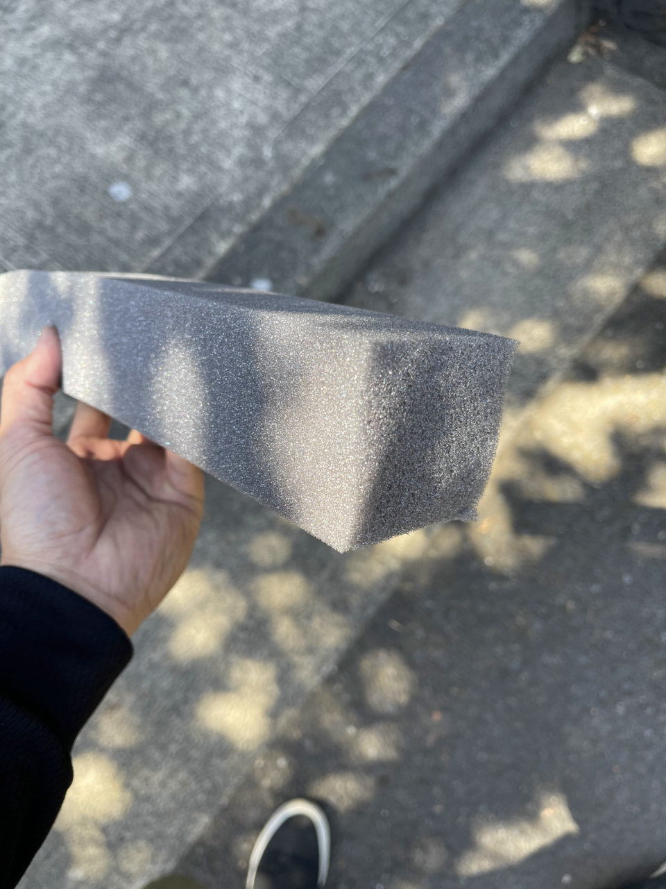

    is the foam home depot?...I'm doing this soon.
    the cut up pool noodle theory did not hold up...it needs to be more squishy.

    I got mine from ACE but Home Depot/lowes should for sure have it. Its square insulation foam for windows that I believe I got in 2" so it would squish and form. So far i've been hitting dunes etc and its stayed no problem.

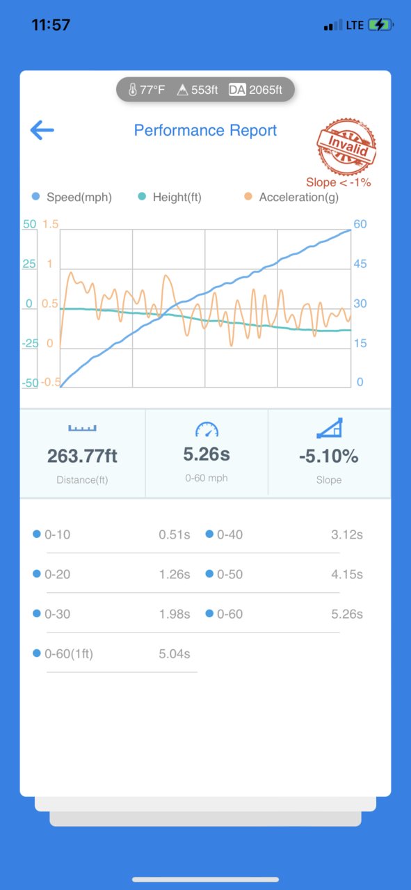

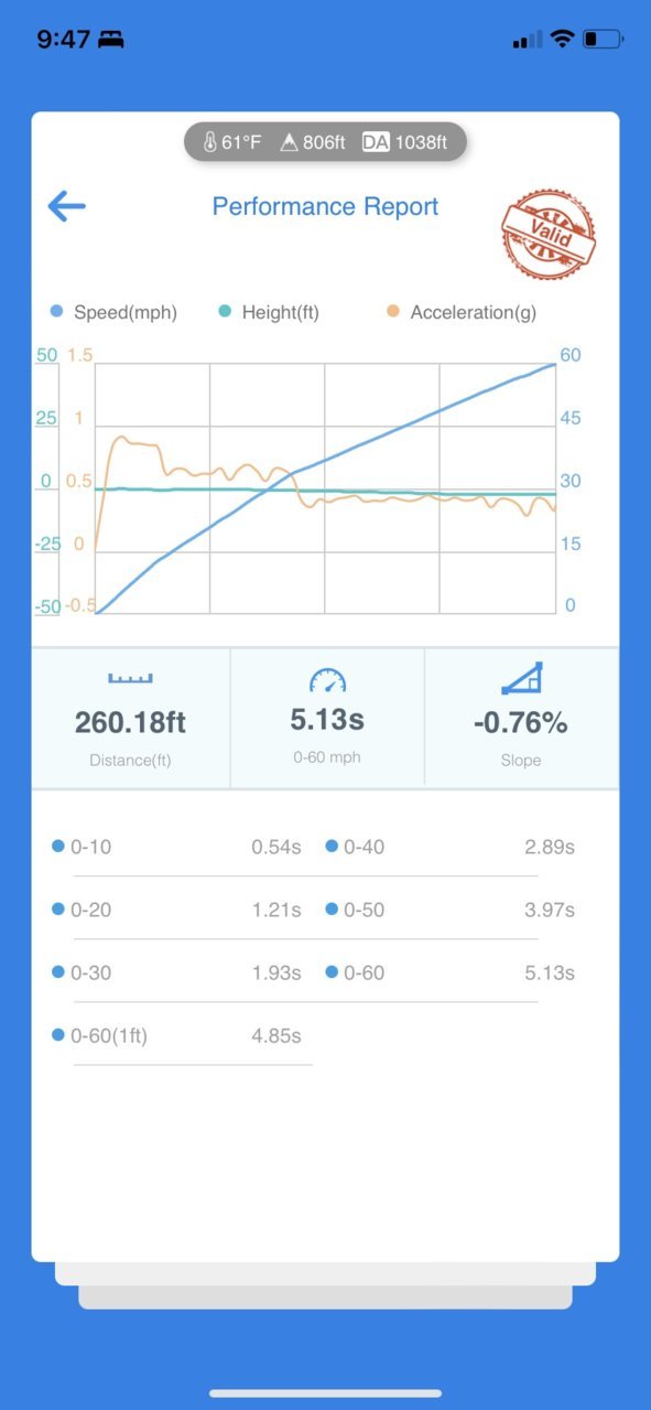

    It looks like his run was down a pretty good hill (-5 degrees), the spike around 25-30 MPH was likely a bump that just threw off the Draggy. If you can manage a 0-60 run on some flat pavement you might get more reliable results.

    The dragy is just problematic with calculating the slope. I have other runs done at the same exact location and the slope reads drastically different on multiple runs. This one was recorded going up a hill (I 100% know it is, as I walk my dog on this road and you can see/feel it) yet the dragy still reads it as a negative slope.
