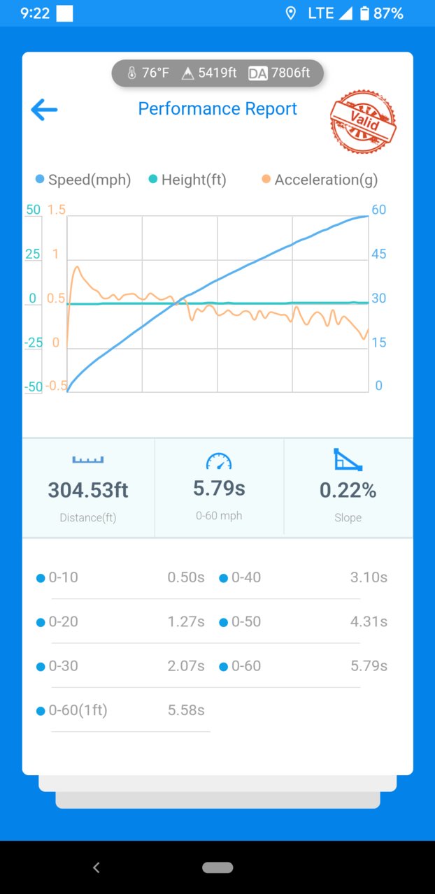

    Alright boys! First run! 5.58s!
    Some additional information: done at 5500ft elevation which is 12psi of air pressure. My boost gauge read a max of 4.6psi, so theoretically the manifold pressure was 16.6psi! That is effectively 2psi of boost if you were at sea level :D
    My "supposed" run before the Dragy of 4.4s was down the hill from my house at ~3000ft elevation which would be an extra ~1.2psi plus more air so the supercharger would generate more boost (I usually see in the ~6psi range). All of this meaning I'll do another run down the hill soon, where I get an extra 3-4psi right off the bat.
    Truck setup: 35s, 5.29s, 3" lift, URD pulley with Magnuson airbox and K&N filter, HP Tuners with @ViktorG spicy tune :D
    Air was 68F according to the dash, the MAF was measuring 72F right before I launched. Coolant at 192, tranny at 175.
    Now hitting 4.4s and redeeming myself seems like a stretch, that's a full second plus quicker, but I'll have 20% more air pressure down the hill so hopefully I can get into the high 4s.
    Also my truck has 276,823 miles on it :D

    compare you launch to mine (G's)... those gears are launching you hard.
    or I'm not pressing the gas pedal hard enough. (i need to do a better job of brake boosting)
    but after your launch, you can see the effects of your elevation.

    The launch Gs seem to be proportional to the gearing which makes sense and cool to see a "real world" comparison. Roughly 25% higher gearing and initial acceleration.

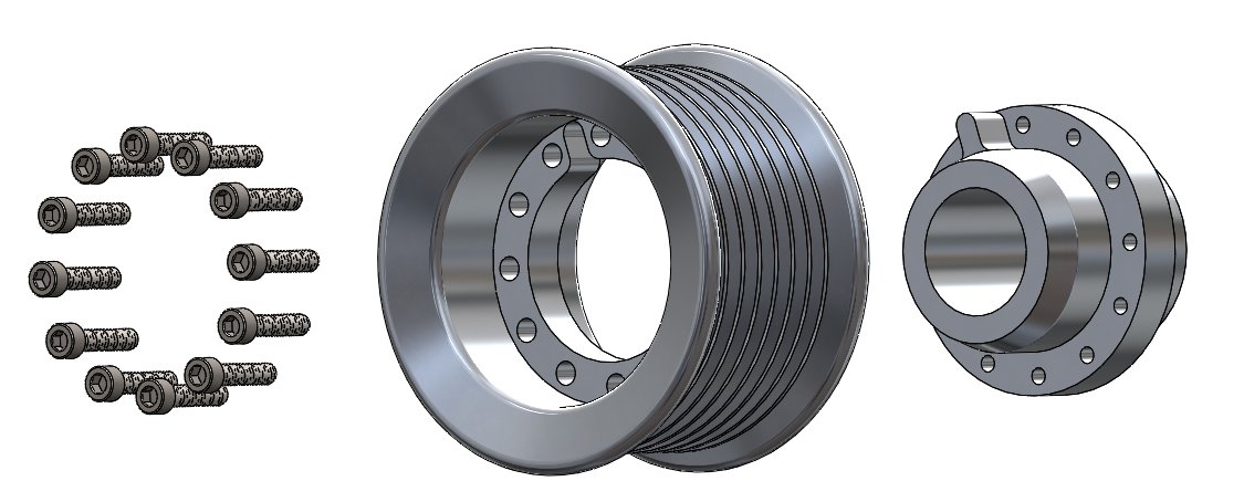

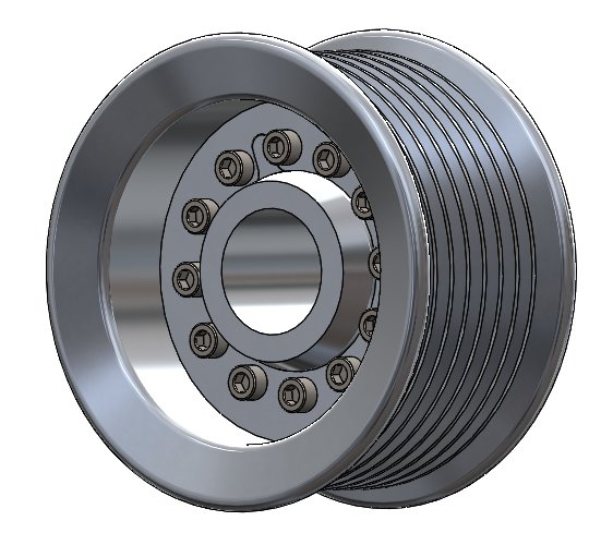

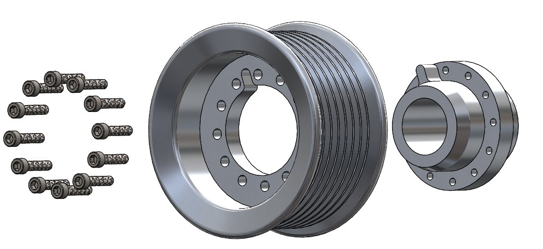

    I found my stock pulley and pulled some measurements off it. Interestingly the bore doesn't seem to be tapered which I thought it was for some reason.
    Pulley hub concept:
    All 6061-T6, 12x 4-40 A286 bolts, helicoils on the hub side, 0.125" shear feature to react torque so the bolts are just keeping it from falling off, the pulley is bidirectional so as long as the hub is installed with the shear lug pointing forward then there's nothing to confuse. Hub has a 75deg taper to make installation easier. My thought is you wrap the belt onto the pulley, then just slide the pulley on so it'd be a lot easier than fighting the belt up and over the sides. First images are a 2.300" pulley (stock is 2.445", URD is supposedly 2.345") and second image is a 2.000" pulley.
    And here is a straight press on 2.000" pulley.
    I'm very tempted to buy the hub setup for some testing :monocle:

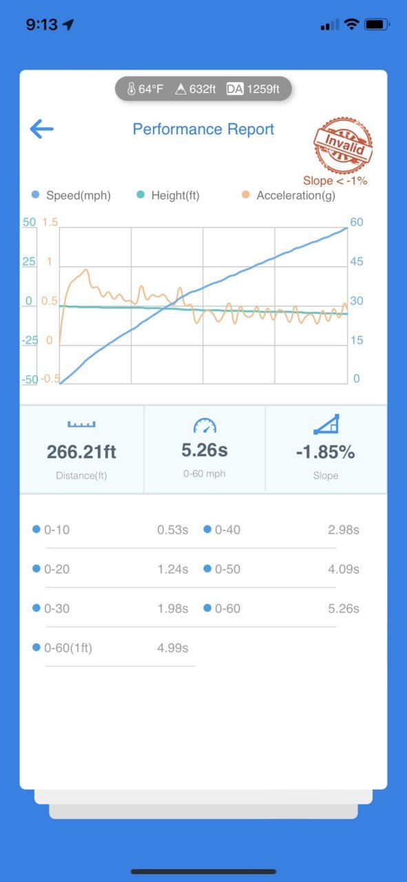

    And I’m in the 4s! By the skin on my teeth :rofl:4.99 with 1ft of rollout. I did 1 lone pass last night on a road that certainly looks like a slight incline to my naked eye. I’m convinced my Dragy is particularly bad at calculating slope. I also researched it a bit and it seems to be a well known issue, and it’s even worse on 0-60 runs than the longer passes. I’ll include a snippet from a BMW forum about it. People report it recording incorrect and inconsistent slope on multiple passes on a true drag strip. It’s annoying, I want my little valid stamp of approval on my run! Oh well, I’ll keep trying.
    As far as the run goes, the cooler evening weather definitely helps! The G’s smoothed out a lot compared to the other run. I think it’s got more in it.
