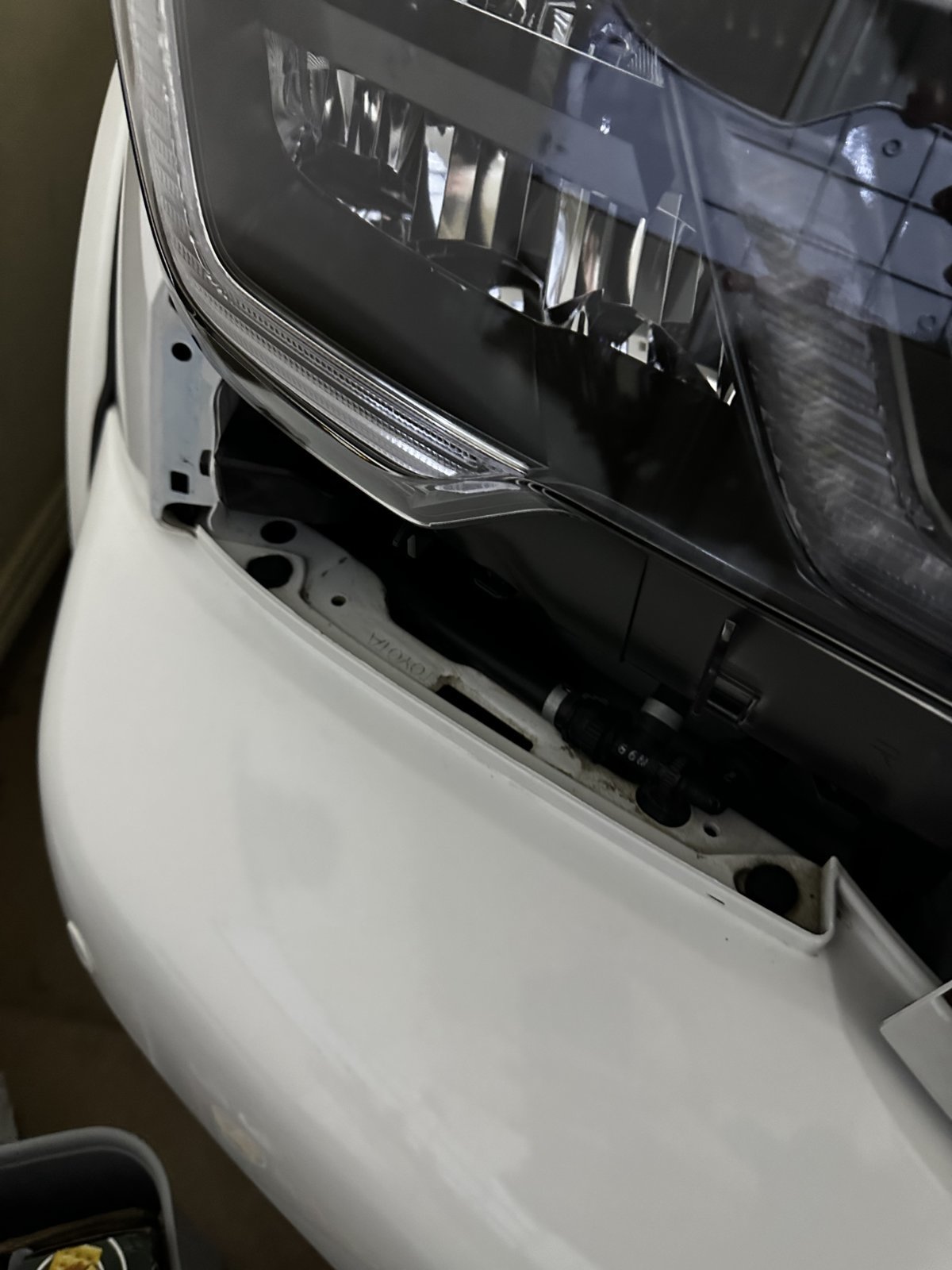

    I gambled and went the Vland route. I saw the price of a combo tail/headlight set and couldn't resist. Especially since after I watched the item the seller sent me an 8% off offer. They look good overall as far as quality goes, but my passenger side amber side marker light isn't working. I've contacted the seller on ebay and we'll see what happens next.
    I do have a few questions though. There are 5 plugs coming off the headlight assembly and 5 coming off my OEM harness. One of the OEM plugs is for the leveling motor and it obviously doesn't line up, nor did i expect it too. But what is the 5th plug for on the headlight assembly? I thought I had read somewhere on the forum about how people fuse tap something to install them? When i plugged in everything prior to install all seemed good (minus the one amber side marker not working). The sequential turns work, the DLR's work and both high beam and low beams work as well. Am I missing something here that could be preventing that side marker light to not function correctly? If I alter the empty plug and tap it into the OEM turn signal harness I will be forfeiting my warranty.
    The other question I have is that I was unaware that the side marker was just a light and not a turn signal. @Musicmasterd12, does your amber side marker light function as a turn signal, or is it just a running light?
    As always, thanks in advance for all the help.
    plug in question
    another pic of plug in question
    IMG_7190.jpg side marker working on drivers side
    Side marker not working on passenger side.

    I also had that other plug left blank. These headlights are also for the sequoia so maybe they have that other connection?
    That I can tell, nothing you did that should cause that side marker not to work.

    The side marker light is just a light, does not function as turn signal. The inner portion of drls function as the turn signals
    I just went and looked and I have an extra plug that is taped up. I guess I thought that was for the adjustable headlight motor for those lights equipped with it

    I really appreciate the insight. After much internet browsing I did find that the empty plug is for the 18-21 sequoia. Which makes me assume that I do have a bad assembly in my hands. Tomorrow I'll be looking to contact the seller to process a return of maybe one assembly or refund the whole shabang and back to square one.
