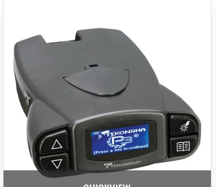

    Appears to be proportional. Been a long time since I trailer brake shopped, and I only did it once. This is what I've got.

  3. Apr 17, 2024 at 7:23 AM
    #33
    KNABORES
    KNABORES Sarcasm incoming
    Jan 1, 2020
    #40572
    15,220
    Arkansas
    That’s a good one

    Cool. Can't remember what I've got in my Tacoma and it's out of town right now. Not the same thing though. This is what came with the truck. I was happy to see the hitch, 7-pin connector (with 4 pin on the side), and trailer brake. Three things I don't need to buy. Now I just need to decide on suspension upgrades. I think my trailer has ~300lb tongue weight. I needed airbags on the Tacoma. Thinking I can get away with blue Sumo Springs on the Tundra. Hopefully that's it.
    I forgot how many little (but expensive) modifications I've done to the Tacoma over the years to get it just right. I can't afford 10% of that stuff right now for the Tundra.
