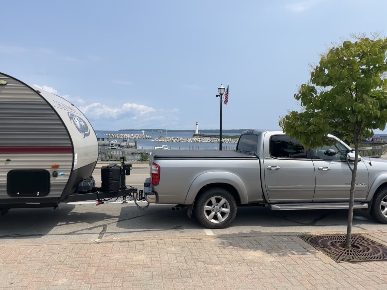

    Just finished the first of our three long trips for the year. 16 nights, 2018 miles, 10.02 MPG (pump calculated and used scangauge mileage corrected vs the truck's odometer). Best tank was 11.8 with ridiculous tailwind for most of the drive at 60-65mph. Worst was 8.3 with a headwind and really pushing the speed at 65 - 75 mph. (unnecessary, but a long drive day and ready to be to the destination).
    Didn't have any horrible experiences, worst day was with some very strong crosswinds while driving along lake superior, 30 - 45 gusts. That made for some more exciting transitions from wooded to open terrain. Kept the speed down around 50 -55.
    Brakes are adequate with properly adjusted trailer brakes, stability while towing is still comfortable - I didn't have any white knuckle moments, Power is lacking. I did however find the UP of Michigan surprisingly hilly. I'm interested to see how this combination does on our trip to Florida over thanksgiving on a route I've done several times with the previous trailer. I was in 2nd gear on several hills on this trip.
    I don't believe weight is massively different than the previous trailer (I have not yet checked at a scale though I'm estimating around 800 lbs heavier). I believe I'm more affected by wind resistance. 4 inches taller, 8 inches wider than my previous trailer if I remember correctly - makes for a lot more frontal area.
    Overall thoughts, This trailer is the upper limit of what I would tow with this truck. My previous trailer was certainly easier and more pleasant to tow. We will likely keep this trailer for 3-5 years, at which time I'll reassess a tow vehicle unless forced to do so sooner.
    YMMV based on towing experience, and locale. Our Yellowstone trip in 2025 may cause me to reconsider, as elevation will likely make the power deficit and poor gearing of the 4-speed even more noticeable. Not everyone tows a lot of miles, and for the around the home area I think this truck is perfectly fine. However for longer trips where you're doing 400-600 miles in a day, it gets a bit tiring dealing with the power and gearing.
    Of course I could just always tow with OD off and not worry about it which would be much easier, but I found I get 7.3 - 7.8 MPG doing that. I put a lot more effort in to get up around 10 MPG most of the time.
    Here is the only picture of the trip with the trailer attached to the truck over the whole trip. Getting lazy about pictures.
    Bmktw2, sportbike37 and JasonC. like this.

    T
    Tell us about that hitch
  15. Aug 7, 2023 at 6:21 AM
    #45

    2004 Tundra Double-cab SR5 Tow pkg
    What would you like to know about it?
  16. Aug 7, 2023 at 6:21 AM
    #46
    KNABORES
    KNABORES Sarcasm incoming
    Jan 1, 2020
    #40572
    15,285
    Arkansas
    Doesn’t look like the traditional trunion bar or hanging chain style weight distribution.
  17. Aug 7, 2023 at 6:30 AM
    #47
    shoe07
    shoe07 New Member
    Jan 14, 2021
    #57588
    312
    Ohio
    It's an Andersen WDH. You tighten the nuts on each side to set up how much weight to transfer. The forward force from the tensioning pushes the trailer coupler into the ball. The ball is on a taper which sits in the hitch with friction material in between. Due to the forward force, the ball and trailer coupler are connected (they do not pivot, and you do not grease the connection), the pivoting happens between the ball and the hitch taper for anti - sway.
    I like it quite a bit. It's very easy for me to dial in how much weight to transfer with a simple measurement from the ground to the front wheel well. It makes some noise, but is way quieter than my BIL's equalizer.
    The more you tighten the nuts, the more weight is transferred forward. I count the exposed threads behind the nut, and depending on how I'm loaded (water filled etc) I adjust it. I typically have 7 threads with no water, on this last trip with full water and a big load I had 10 threads exposed. I can usually set by sight now and no longer need to measure.
    I've read a lot of people who don't like it, or can't get it to transfer weight, but I've towed 22000 + miles with mine and haven't had any issues. Biggest thing is understanding what it's doing, and reading instructions on setup.
    KNABORES likes this.
