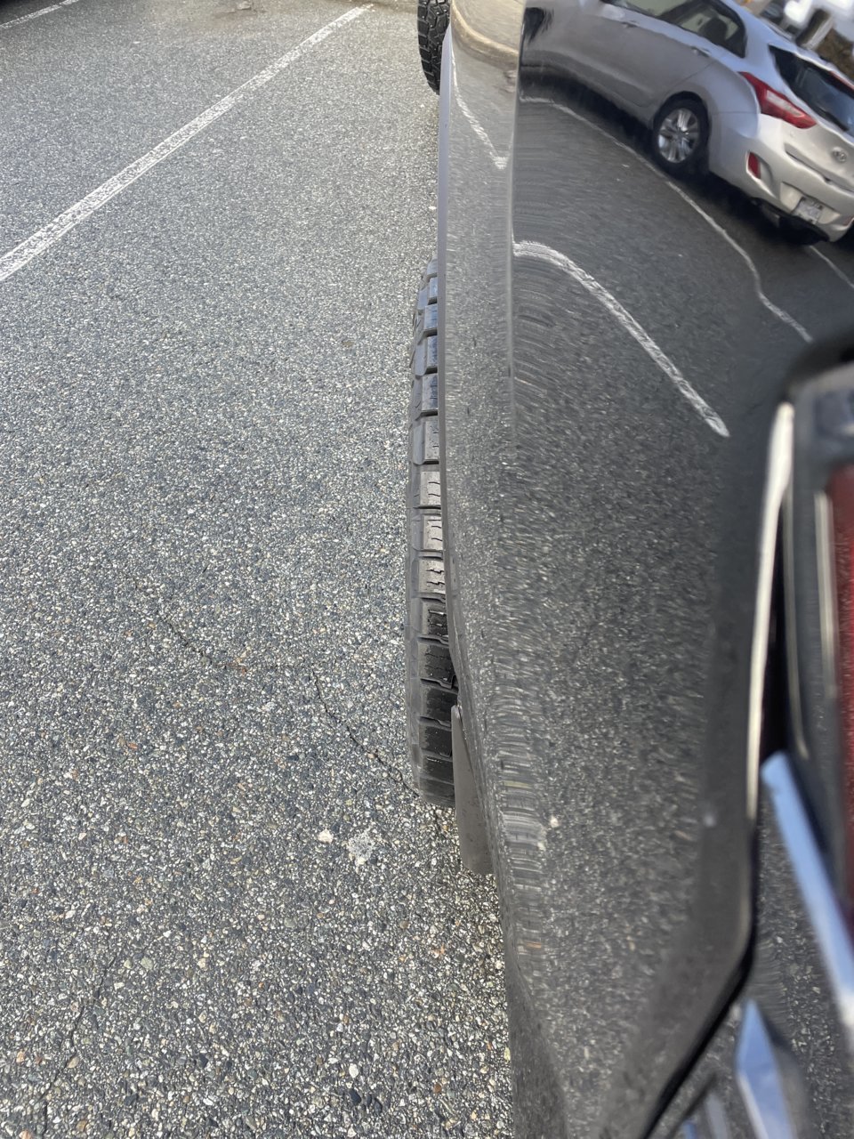

    Wow that’s crazy on your fuel wheels that u have that much poke on +20
    I fig offset is offset no matter the rim used.
    How in the hell are we supposed to order wheels if we have no way of fig out.
    I know it’s confusing to me. I would be pissed if I ordered a +20 and still had poke on a 275 tire. Not saying anything negative about your set up. It’s just that wheels and tires are so exspensive and unless u copy someone else u truly have no idea what it’s going to look like until there ordered,paid for and on the truck!
    To late then to make a change. Wow thanks for the info!

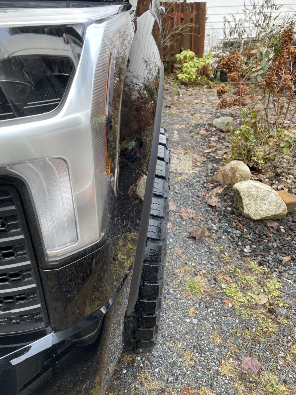

    i knew that i would have poke at +20, no different than our 2018 that had poke also on the helo wheels. have to remember the oem width is like 8 or 8.5 so according to this chart i would have to run +25 at 8.5 in or +32 at 8 in on a backspace of 5.75
    since fuel doesnt make a +25 or +32 offset in those wheels = poke
    +19 offset @ 5.75 should have made it even per the chart but the back space on the fuel is closer to 6 it seems like

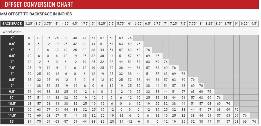

    with tire size being the same (and back spacing), you would have needed +25 to be even @ 8.5in
    here is the chart that i attached

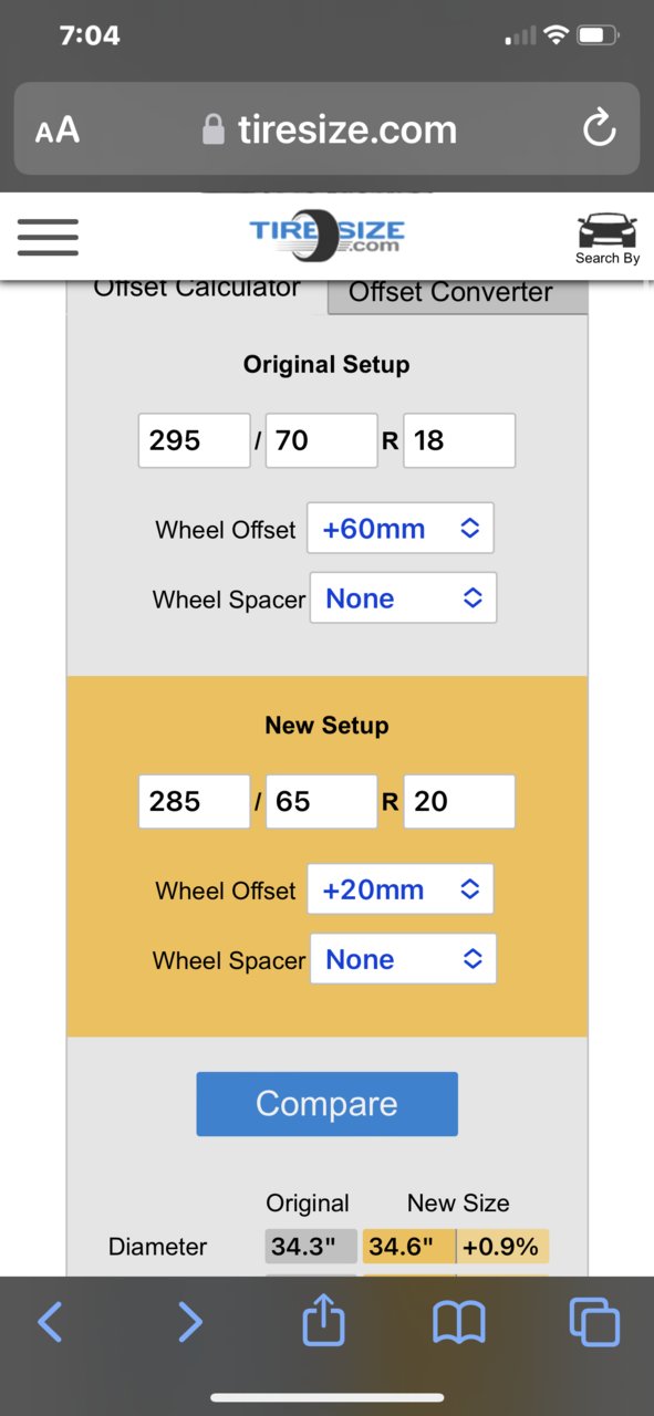

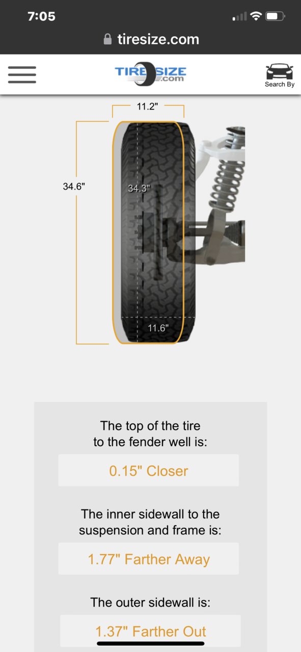

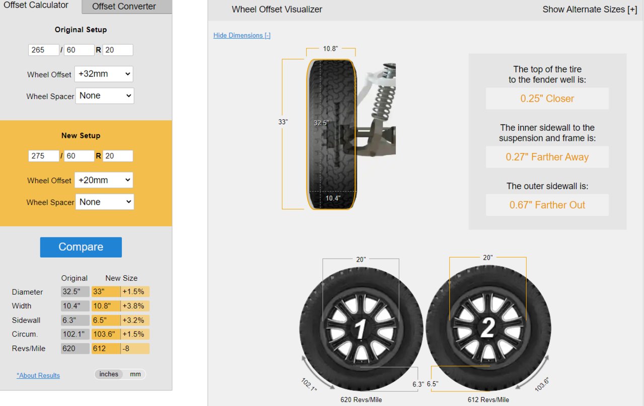

    TireSize.com answers all your questions as far as how a new tire and wheel will fit. Wow awesome site!!!!! But is it correct
    I use now a 295/70/18 on a stock TRD rim
    If I go to a 20x9 rim with +20 offset the side wall of my tire moves out 1.54 inches!!!!!!! I used a tape measure holy chit that’s alot of Polk.

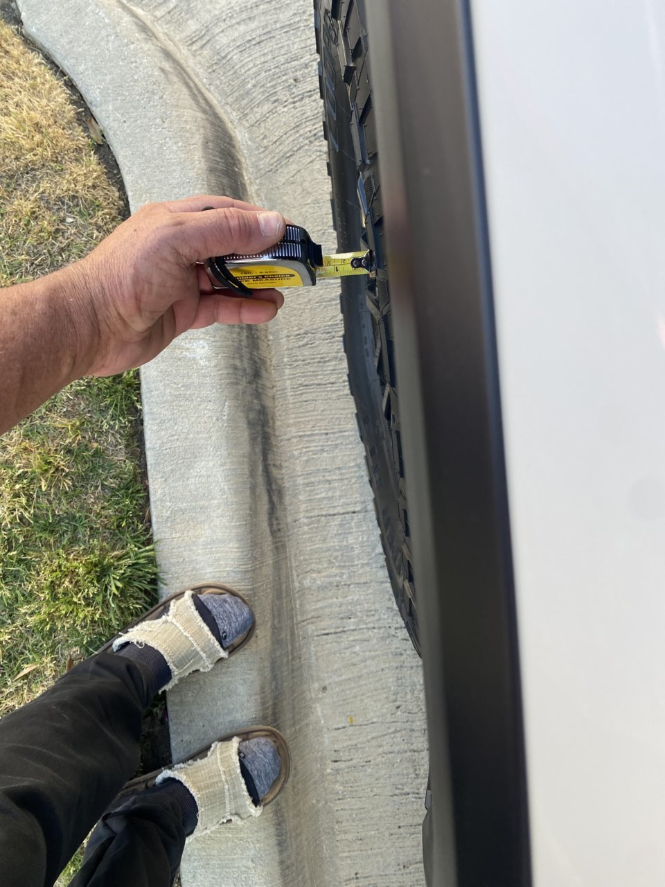

    Cold
    Socks....With sandals.
    Firefighters.........

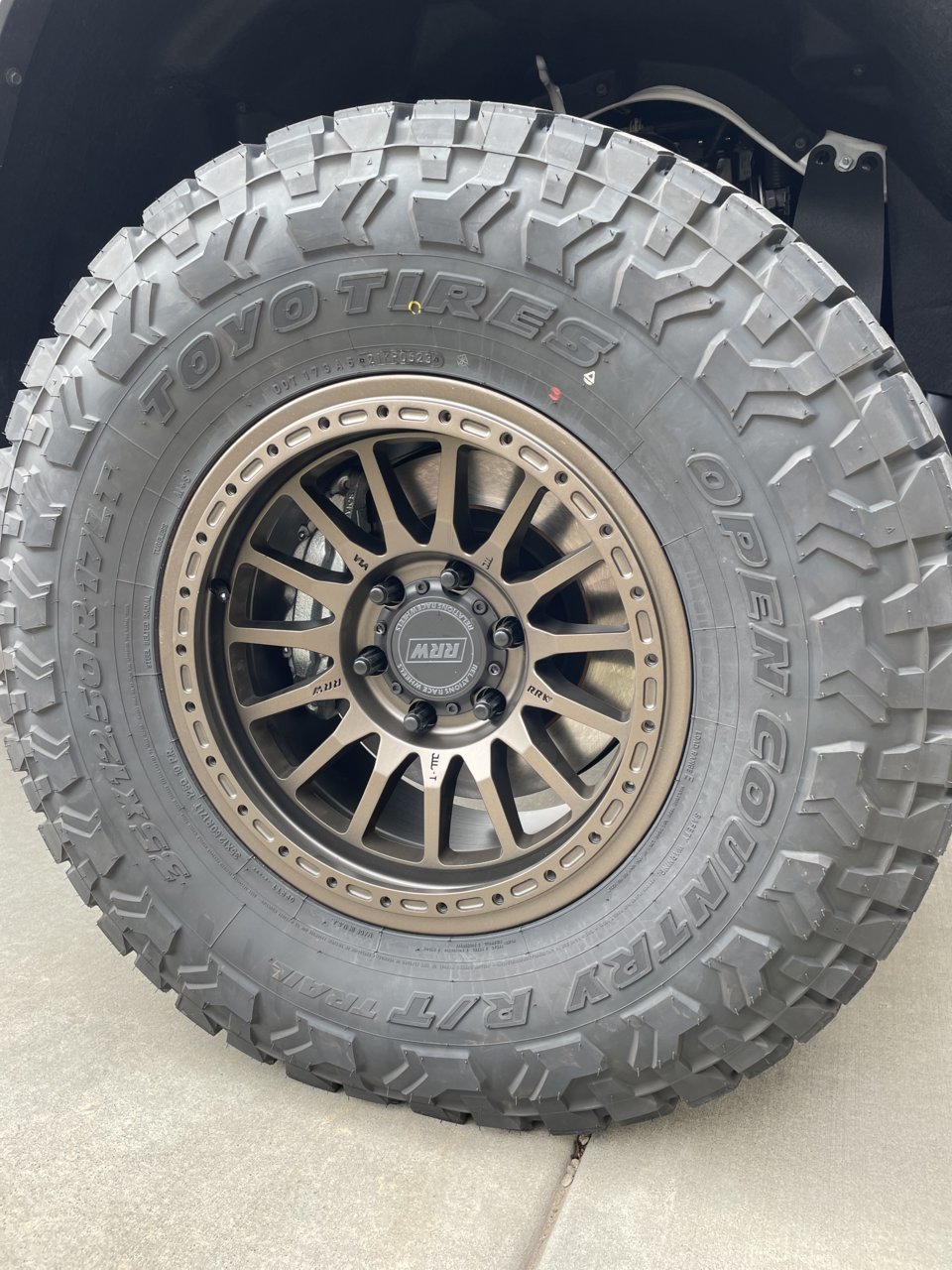

    Relation race wheels wrapped in 35s Toyo Open Country RT Trails!
    csmobley, ScootARoot, Azrsx and 5 others like this.

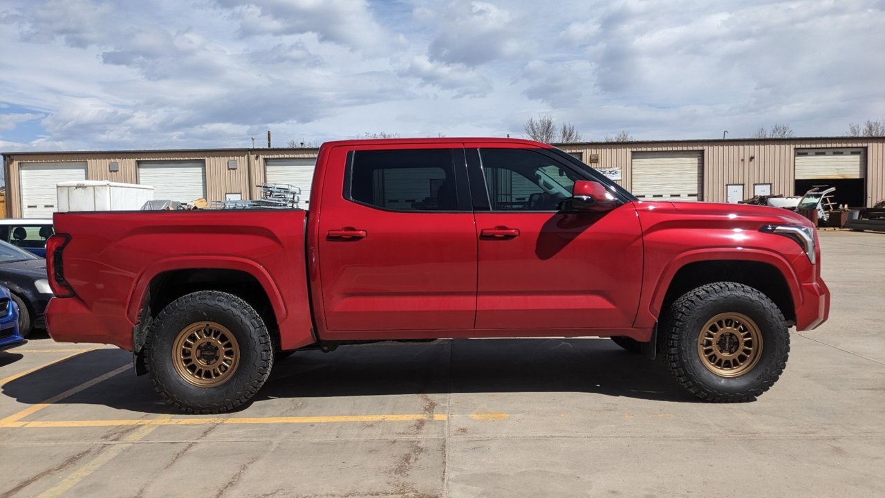

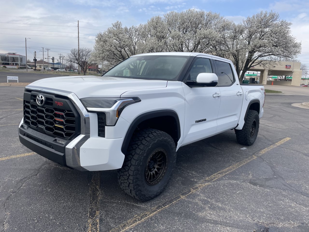

    315/70/17 "C" KO2s method 318 +25
