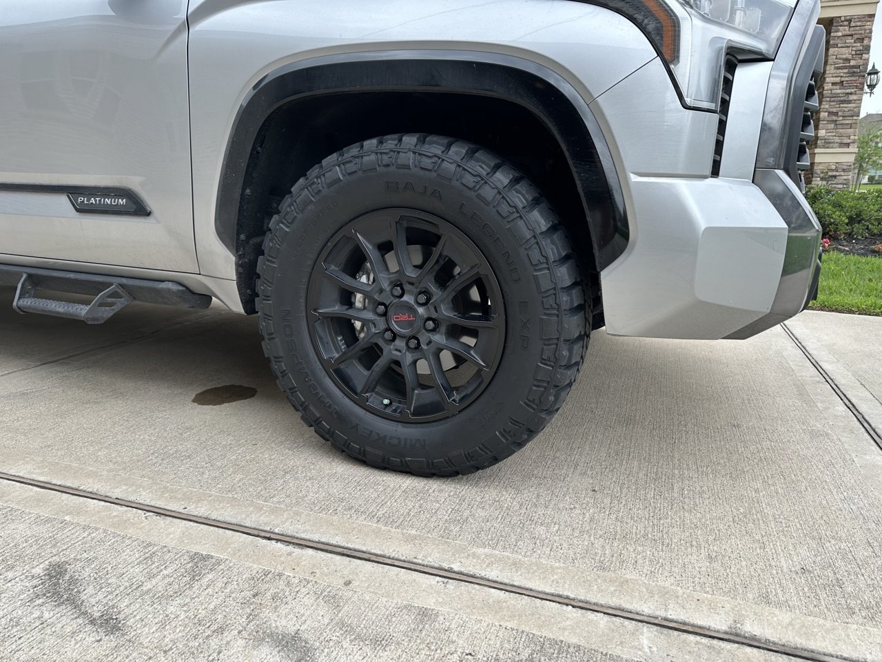

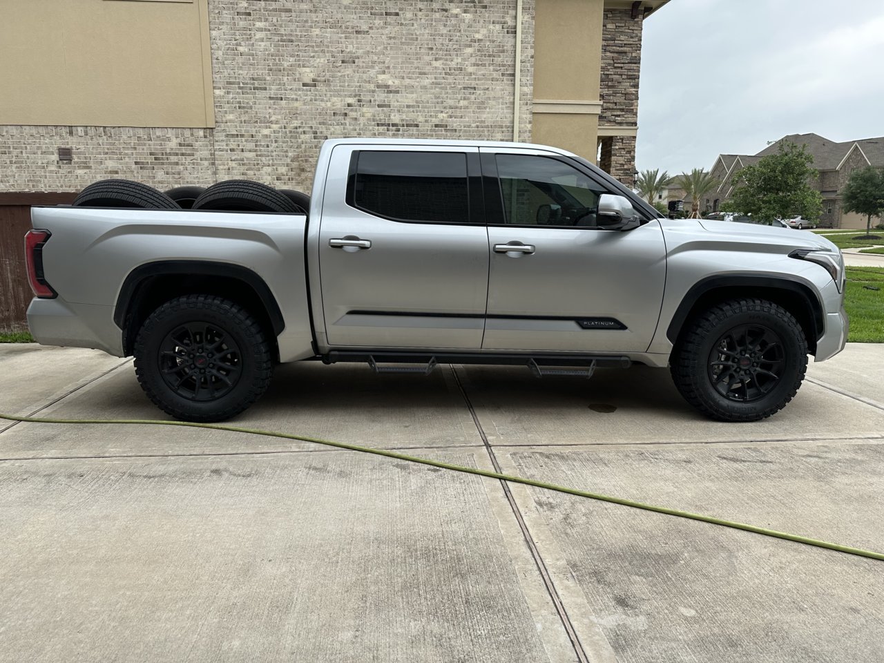

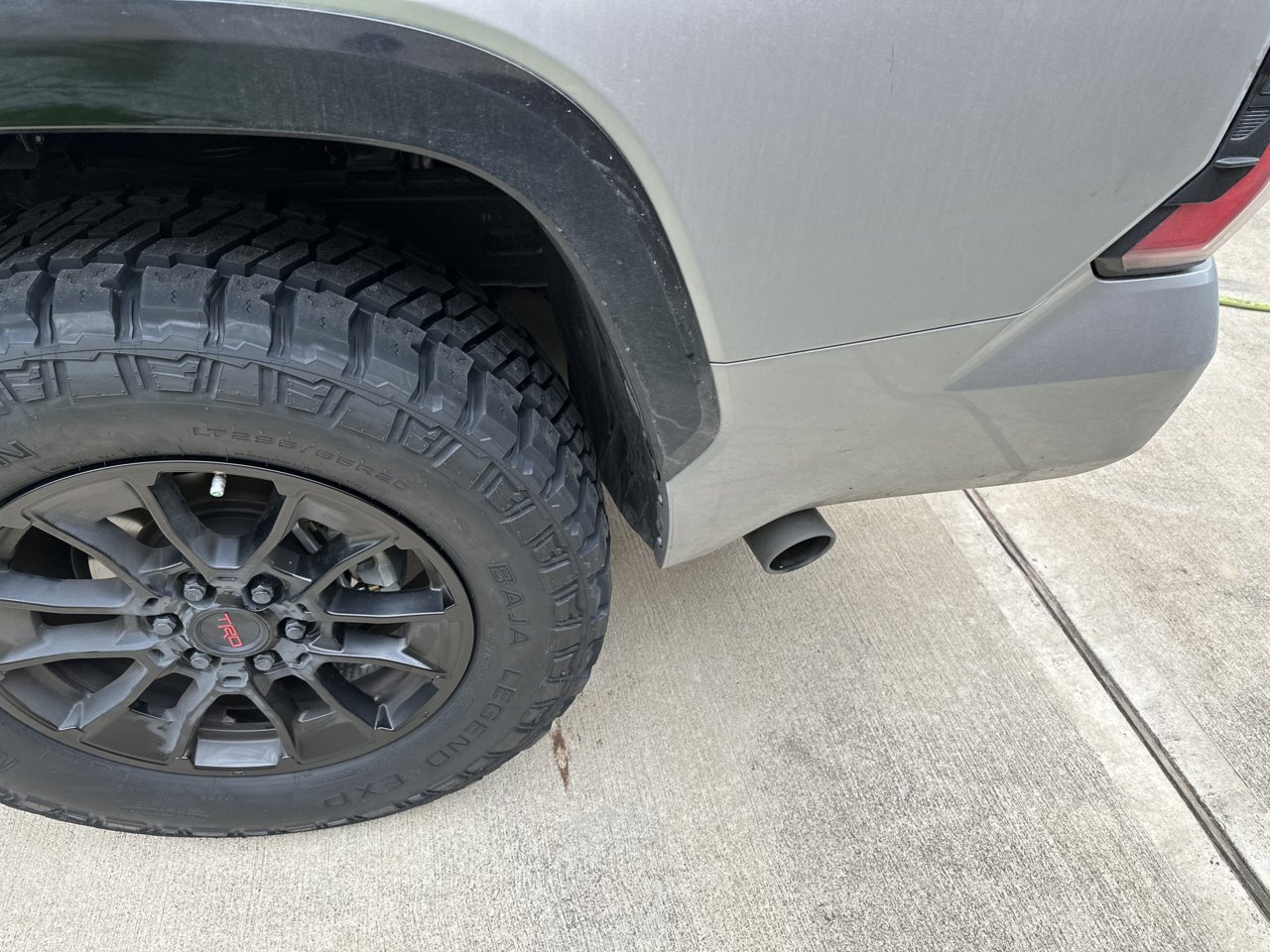

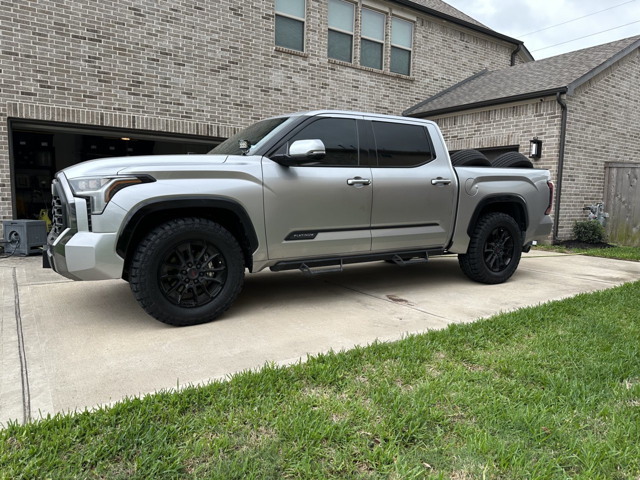

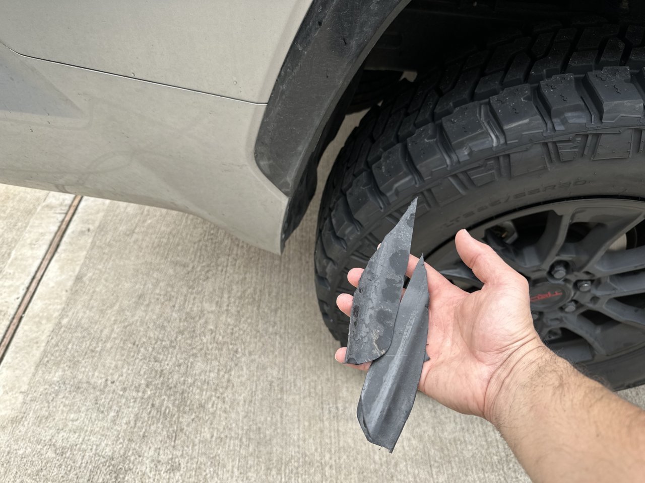

    Finally got some 35's on the factory 20 inch trd wheels and what a difference. I haven't seen much info on these but got a steal on them from discount tire with some price matching.
    Mickey Thompson baja legend exp 295/65/20, no rubbing at all in the front, but had to cut a sliver off of the rear mud guards. I'm on stock suspension, non avs.
    =JSG=, HMNYC, Kal149 and 1 other person like this.
