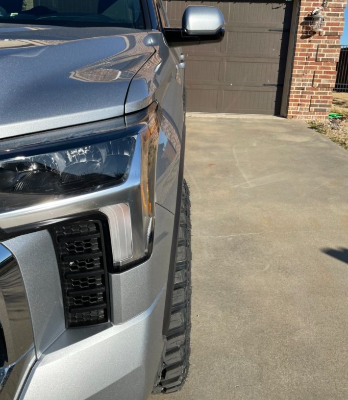

    I'm not 100% sure, but i think 0 offset on a 8.5 rim is still more aggressive of a poke than a +20 with a 9inch wide.
    This also crossed my mind so here are some photos of a 8.5 wide rim & 0 offset. This fella does have 17inch rims, but i dont think that would make a difference in this context... the poke looks a lot more aggressive than poke I've seen with +20 on 18x9. See below.
    8.5 Wide with 0 offset:

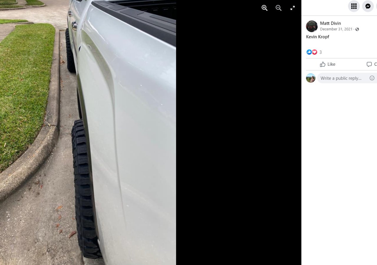

    18x9 +18 example, a +20 would be even more slightly tucked in.. but minimal.

    The 8.5” wide wheel with a zero offset has approximately a 4.75” backspace. A 9” wide wheel with a +20 offset has approximately a 5.75” backspacing. So the 8.5” will sit about an inch further out when comparing these two wheel specifications. I actually drive the silver Tundra that ToyotaTundra89 referenced above and love it.
    If you found a 8.5” with around +25 that’d be equivalent to a 9” with a +18
