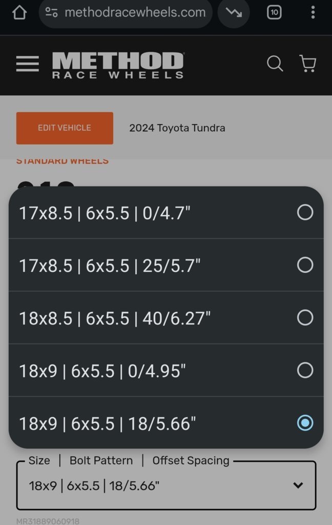

    I'm kind of in the same boat. Been looking at 17s but worried about the brake caliper clearance and dont want a lot of poke like a 0mm offset. From what I gather the 17s need a low or 0 offset to allow for wheel weights to be placed without hitting the front calipers.

    Ive had s few 17" wheels on tundrs before, most recently icons. A +25 offset was fine, weights just need to be placed close to the outside of the wheel
