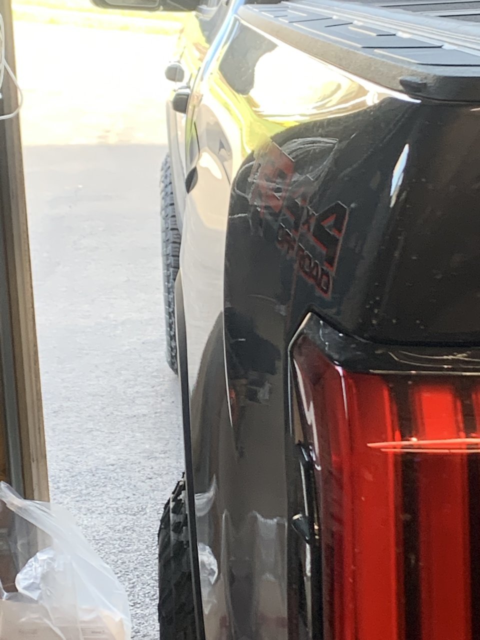

    The tech said it was close but not bad at all. :thumbsup:

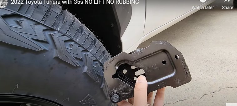

    Wanted to gauge the room, saw this on youtube this morning. I'll be running 35x12.5 soon, and although I'll be lifting first, more clearance is always a good thing.
    The gentleman in the video removed a metal bracket which sits behind the wheel liner at 6:10 mark in the YouTube video. I will probably be doing the same to gain additional clearance, but wanted to see if anyone saw any dangers to the part that he is removing? Could be a good tip if you need more space? He's running 35x12.5 on stock suspension in this video.
    https://youtu.be/pjy_d_Np8iU?t=368
    Apparently this piece is held on by just 2 - 12mm bolts behind the wheel liner, no cutting is what he stated.

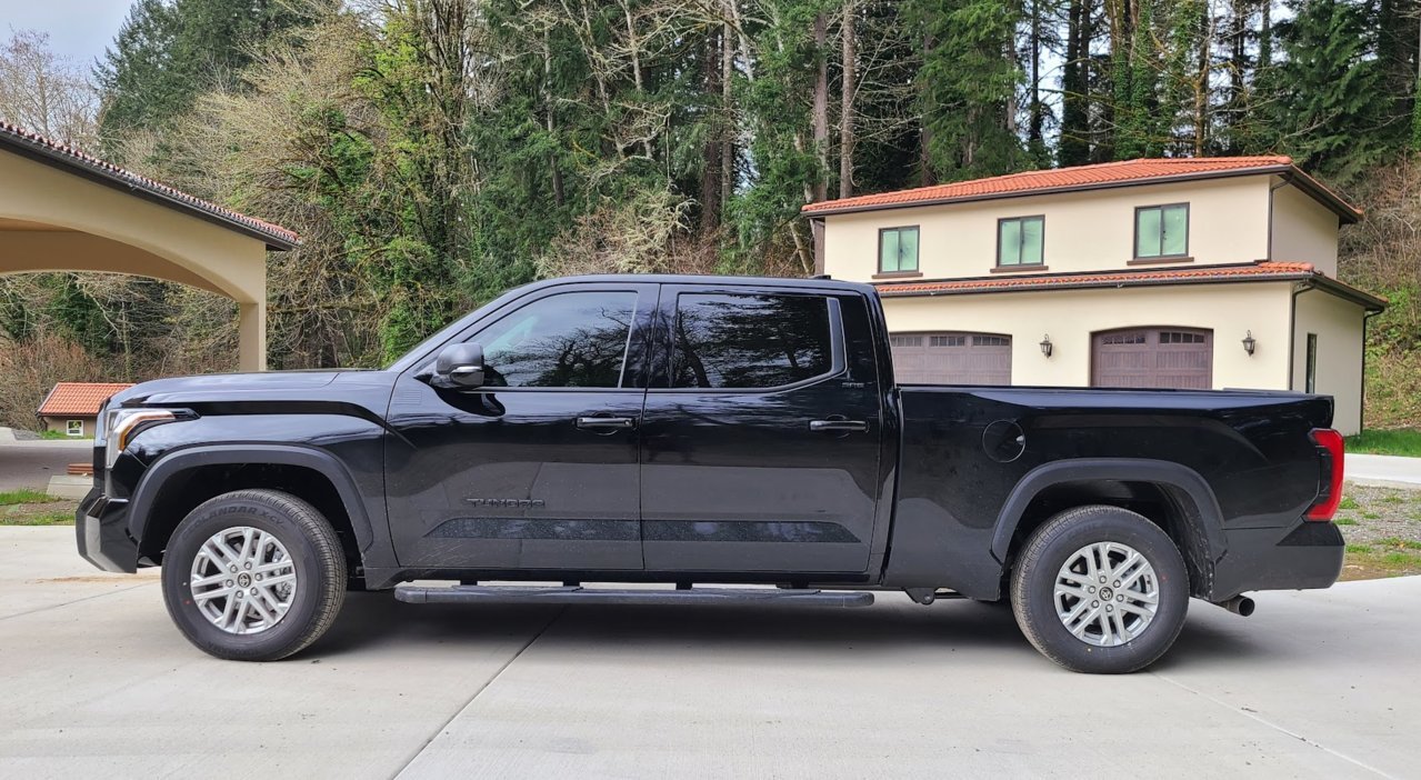

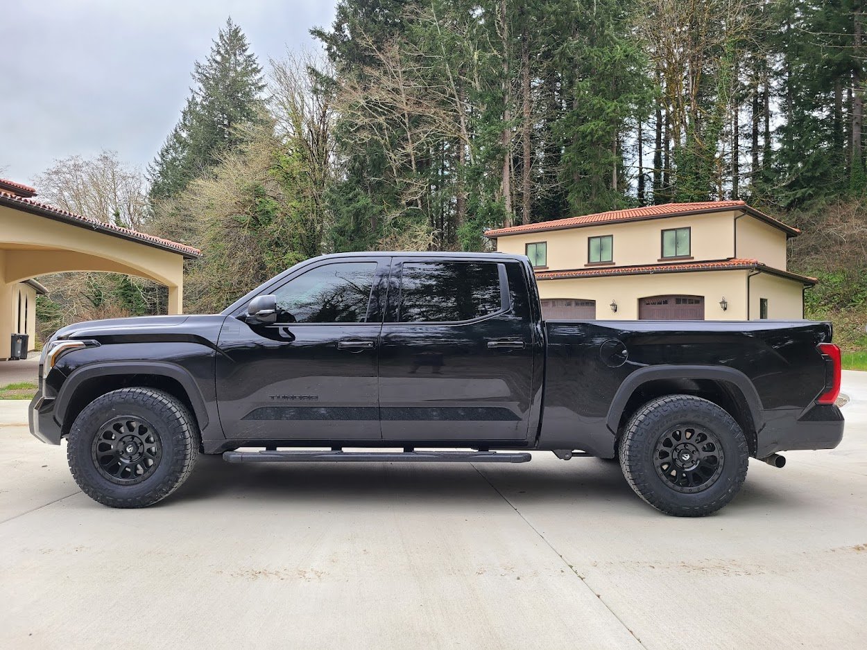

    Just got back from Discount Tire. The pictures show the before and after of the profile of the truck. Rims are Fuel Vectors +19, Cooper AT3 XLTs (295/70R18). ZERO rubbing on the front fender wells. Will still pin back the ballistic cloth in the wheel wells so that they are not shredded by road debris. Love the new stance of the truck and how it all turned out. The truck definitely feels a little sluggish, but I have only 403 miles on the ODO.

    Was this stock ride height too?

    Yes, stock suspension. Non-TRD package....will probably get the Westcott kit later in the summer once some more feedback is available for the air suspension set up (what I have in the rear)

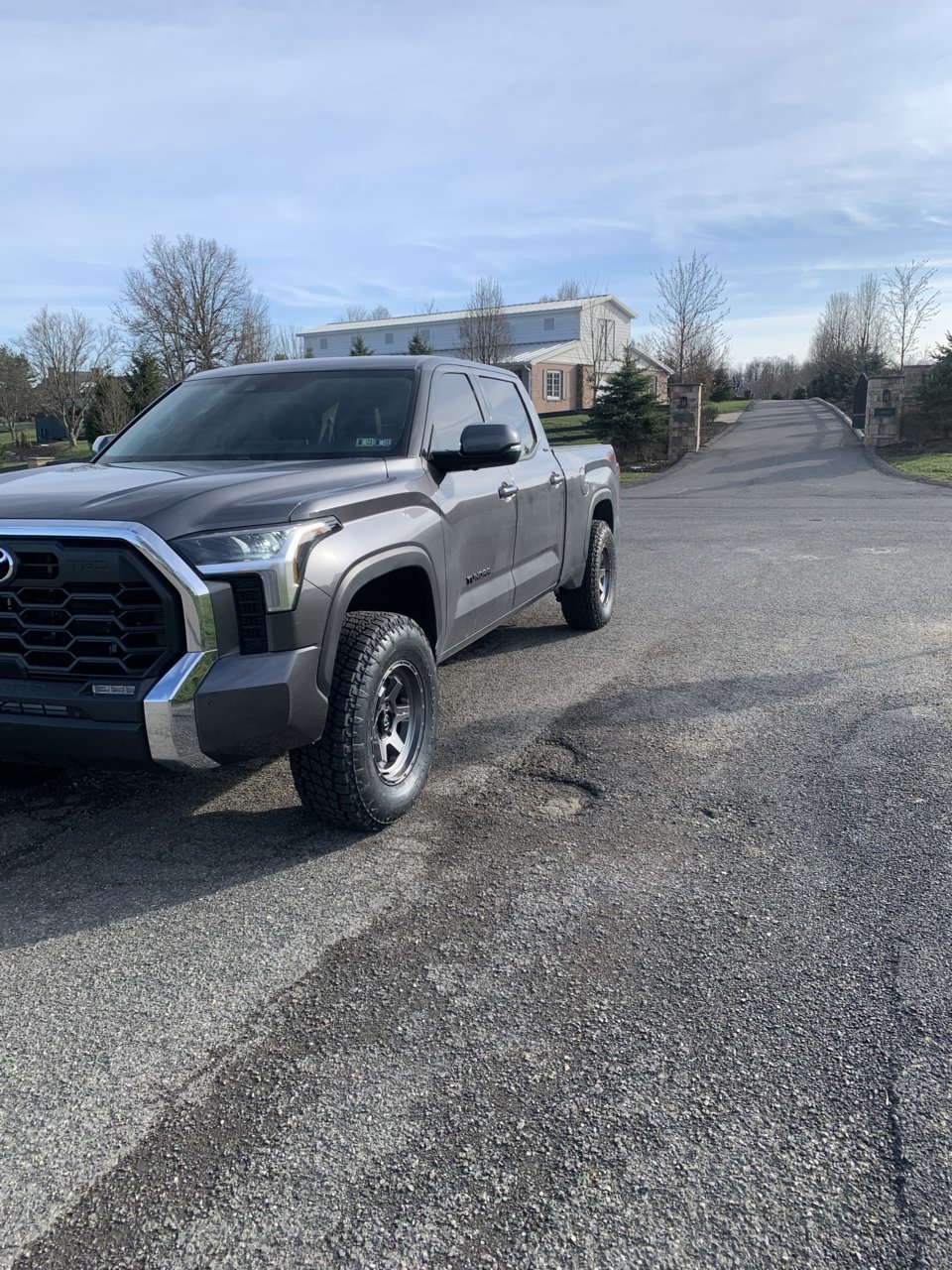

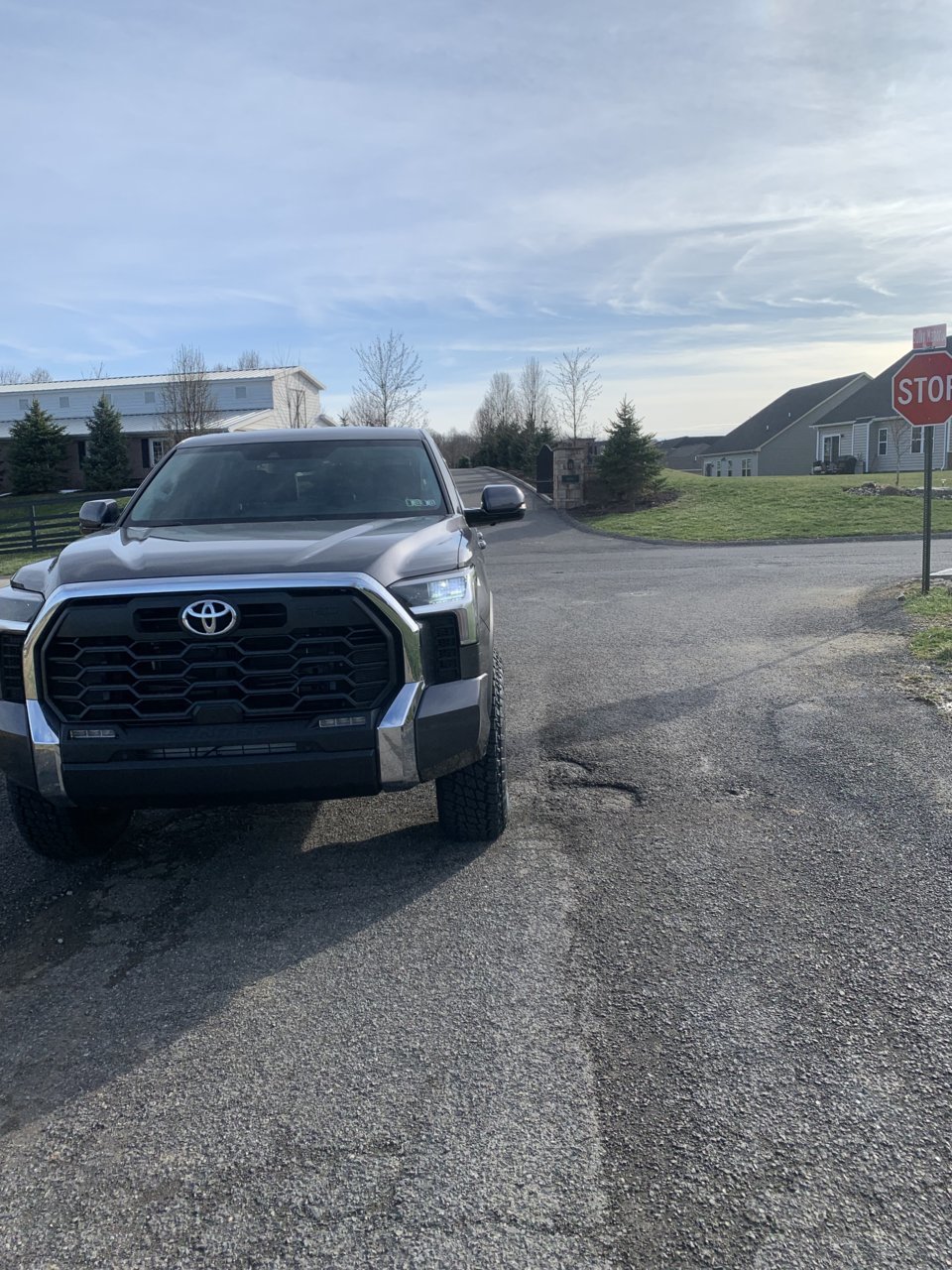

    So until other options are available here is a 2nd gen spacer and fuel shok wheels 18” with +20 offset and nitto terra grapplers 295/70/18. No rubbing even with mud flaps at full lock forward and reverse. I can confirm stock 18” setup on a SR5 OR weighs 69.5 lbs. This setup weighs 80lbs. Height is 1/4 “ higher in rear.

    Looks amazing! Thats the perfect set up.. jealous of your huge driveway! And villa garage lol
    Love seeing all the Crewmax long bed configurations. Truck looks like a beast!

    It sits perfect in my opinion. Even at stock height, with the length of the crewmax and 6.5 bed this looks proportionate just bad@ss. That sounded like a really fun time in the garage at DT lol

    Is the back of the truck sitting lower than the front? Could be the pic but it looks like you have a bit of a squat going on.

    The "before" picture, I would agree with you that it seemed to squat in the rear....the "after" pic it seems to be completely leveled out. I cannot explain it and I didn't take measurements before to have a basis of comparison. And I didn't touch the air suspension toggle....

    Sluggish? What is the weight difference? How does the ride compare to the stock skinnys? Looks really good.

    I myself will not remove that piece from behind the liner. From what I have read/understand, it is for crash protection. It is supposed to help with not allowing the front wheel in a front impact make it's way into the cab (I could be wrong). Although I don't plan to crash my truck at any point, I'm not taking chances with removing parts that are meant to be there, but that's just me I guess. My Westcott lift goes in Saturday along with wheels/tires, so here's to hoping I get no rubbing!

    I didn't weigh the tire and rim combos separately, it is a "seat of the pants" thing. Mind you I am still babying this truck for break-in. Stock tires the ride was very light and a little skid-ish, these Coopers make the truck ride "planted" a little heavy, but the truck doesn't wander. Heck there is an additional 1"+ of tire patch on the road

    Is that part removed not a safety device...so the tire does not come through and into the cab???

    Could be.. but not sure. The fact that it bolts off so easily makes me wonder.. however will probably not touch it just in case.

    if it's rather thin just held on by a couple screws vs welded on, I don't think it'll make a big difference during a crash whether it's there or not

    Yes I saw that also on Tim’s “Pickup Truck and SUV talk” show…the one he did at the Rough Country facility.
    …again like everyone said we don’t know if it’s true or not (none of us got it from Toyota) but I don’t plan on removing it either…and don’t need to since I got a lift.
