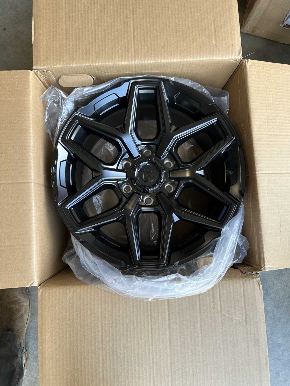

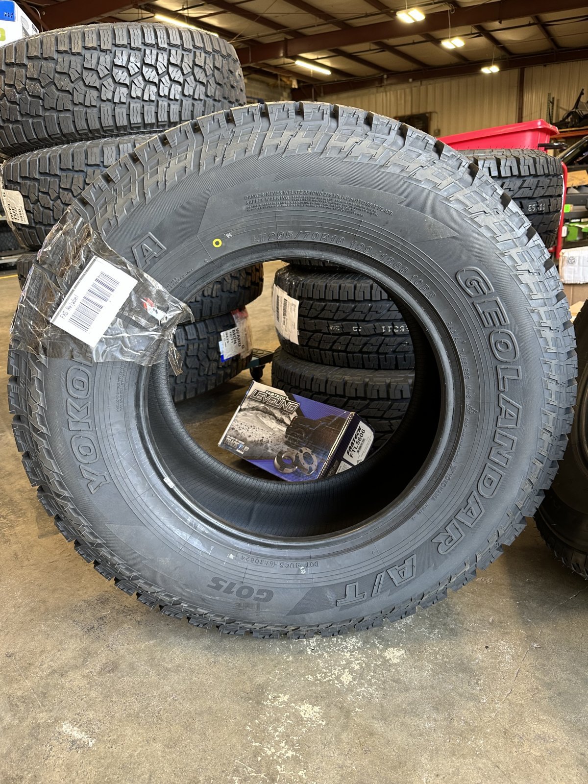

    Getting these put on Monday.
    Fuel Flux 18x9 +20mm
    Yokohama Geolandar AT G015 295/70/r18

    I like those, post up once mounted.

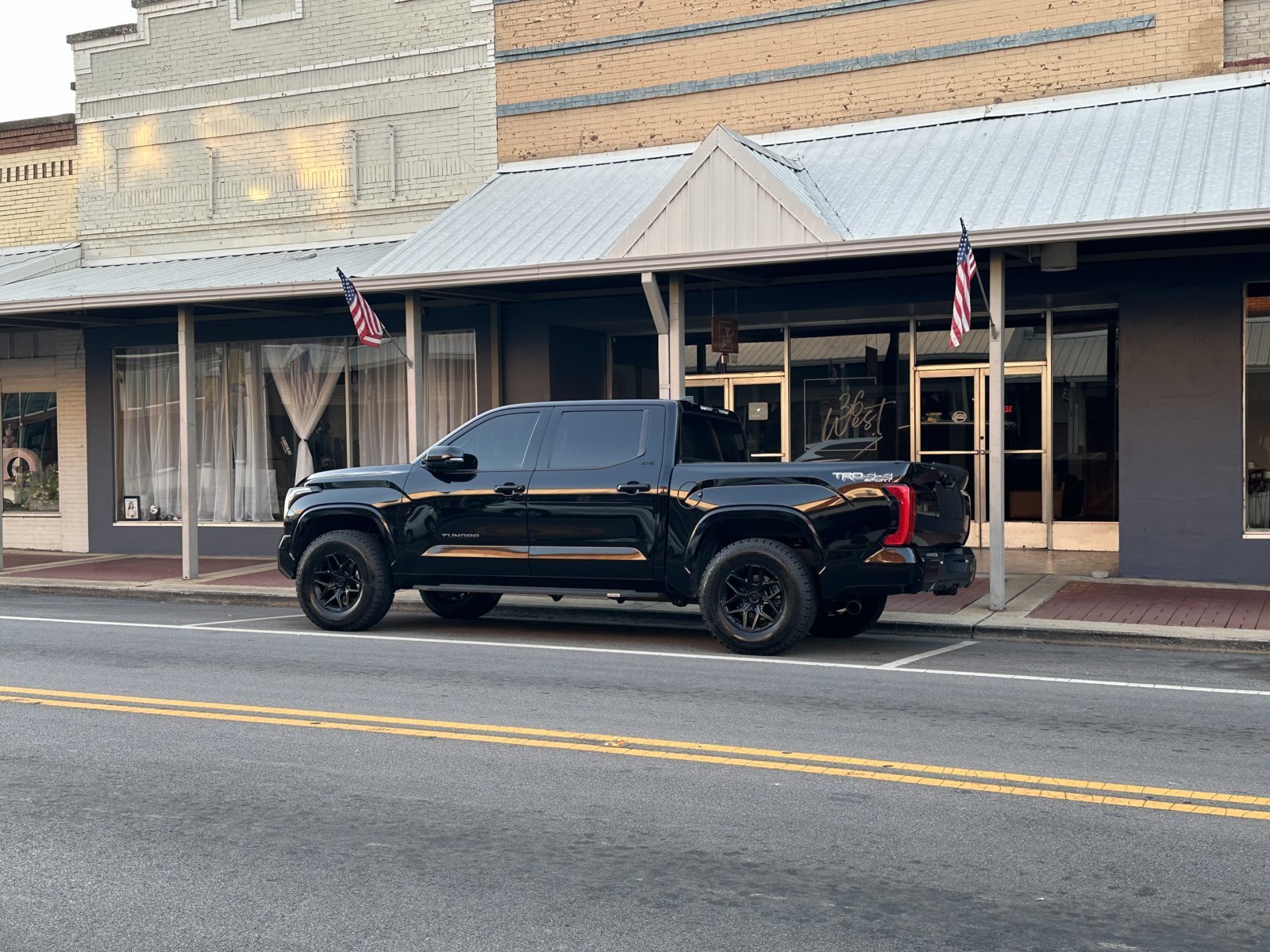

    #116533
    11
    Steven
    24 trd pro
    Westtcot lift 37s
    Something smooth about 37s!!
    lavern23, COTundra23, akira and 7 others like this.

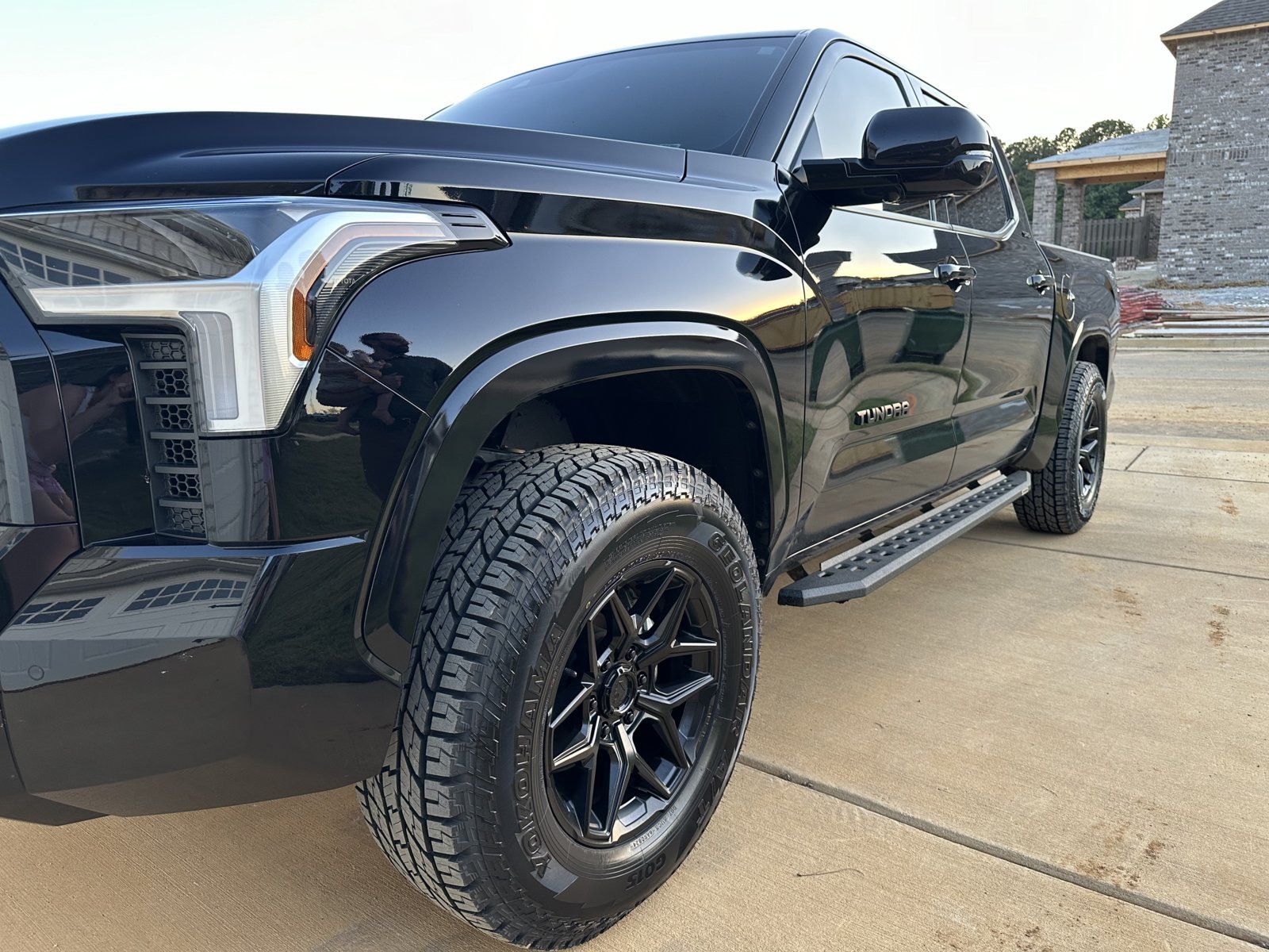

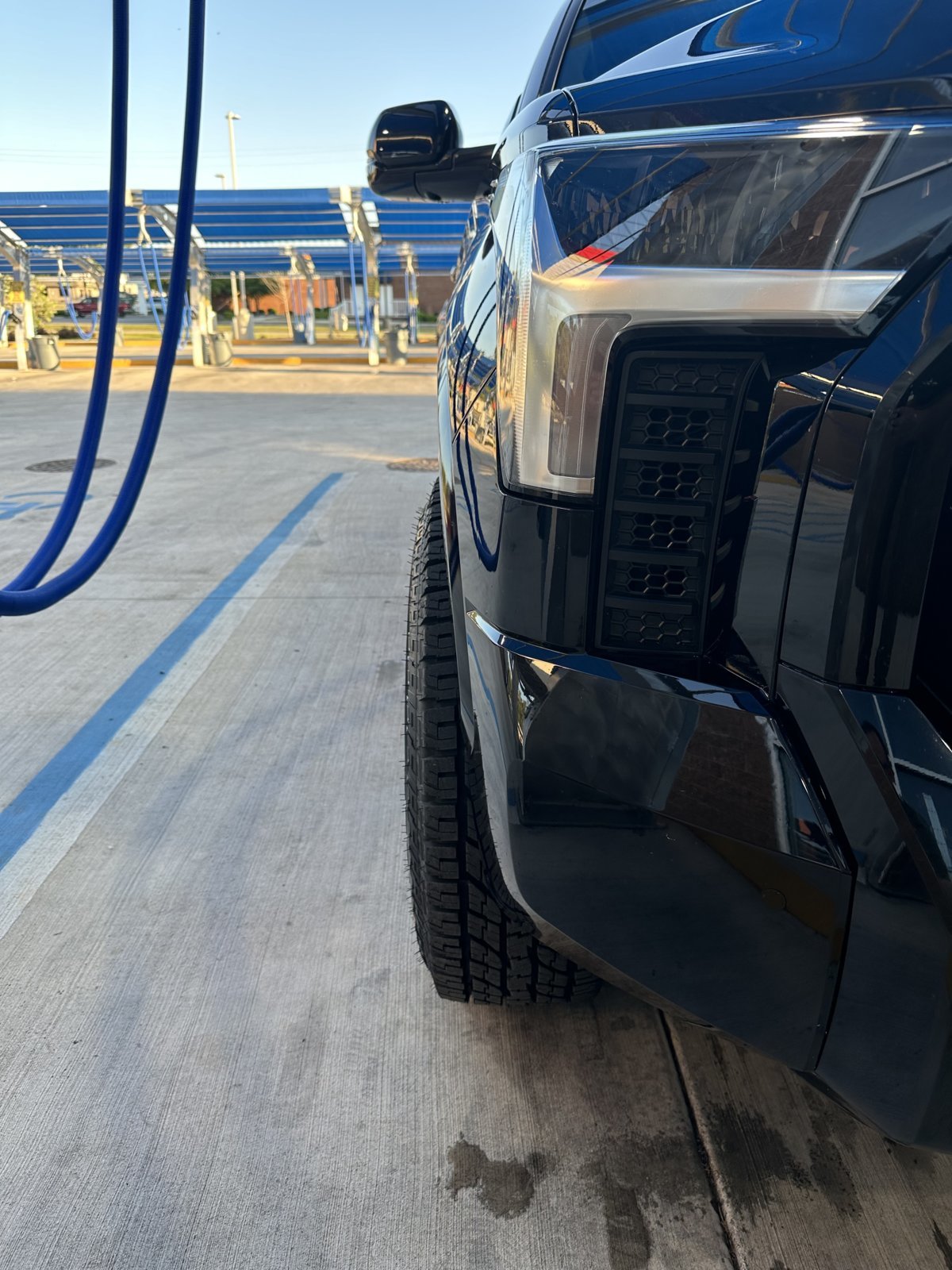

    2022 Tundra SR5 TRD Sport 4x4
    Fabtech 1.5” leveling kit
    definitely rubs at full lock and little less than, gonna need to trim it up. I have the sport, which is lower to begin with, but feels/looks level to me. Very little poke.

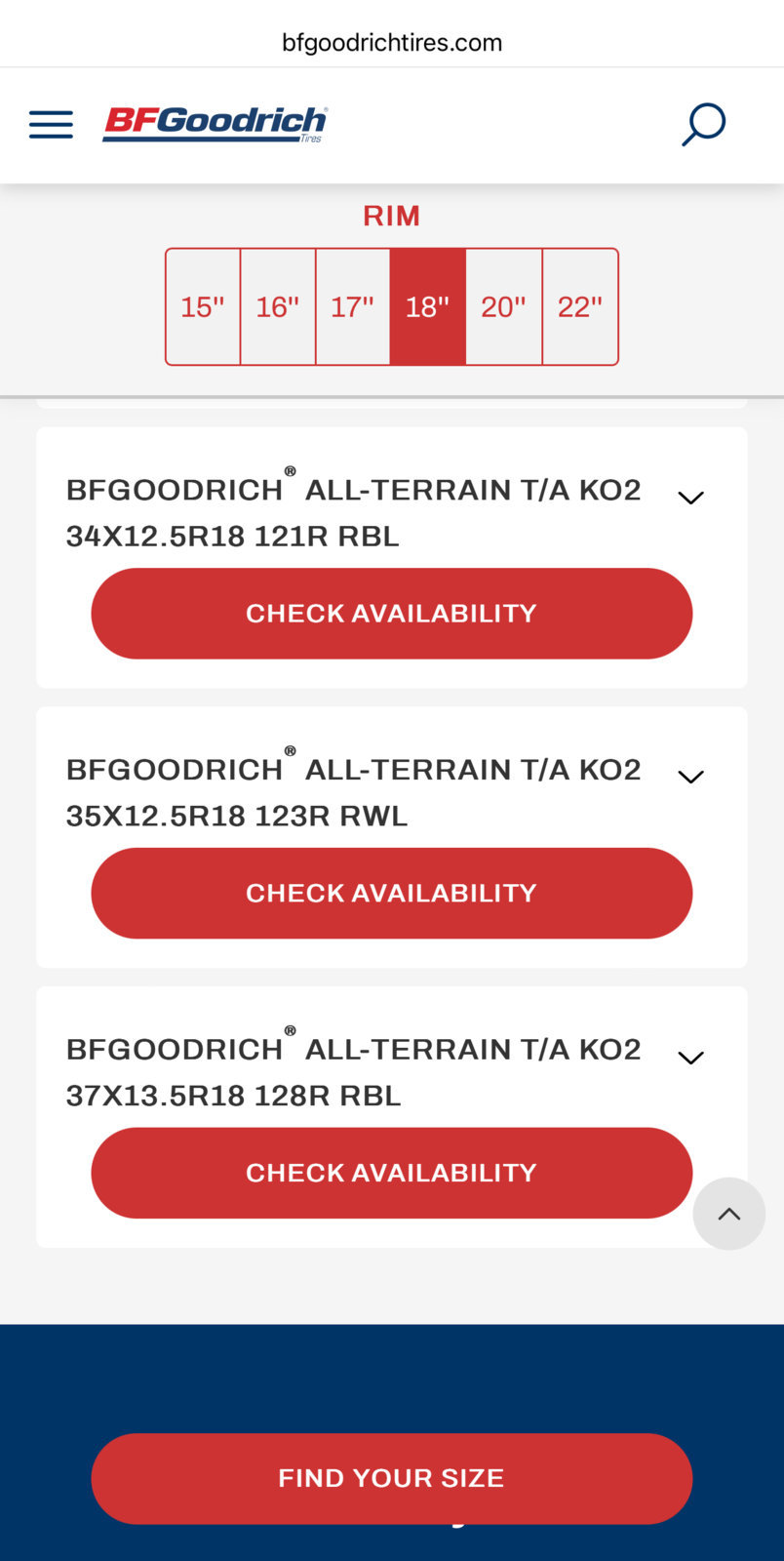

    Does anyone know if the Falken Wildpeak A/T4W 35x11.5R18 paired with TRD Pro wheels will fit without rubbing? Per Falken's website they're 34.9 which is larger than 35x12.5R18 KO2's.

    How is a 34.9” tire larger than a 35”?

    yes, they will likely rub at stock height. I put 295’s on my pro and they rubbed slightly on the well liner at full lock.

    I dont see KO2s in that size per the BF Goodrich website. Are you sure they make an 11.5” wide in a 35”?IMG_1804.jpg

    Sorry about that I meant 35x12.5R18
