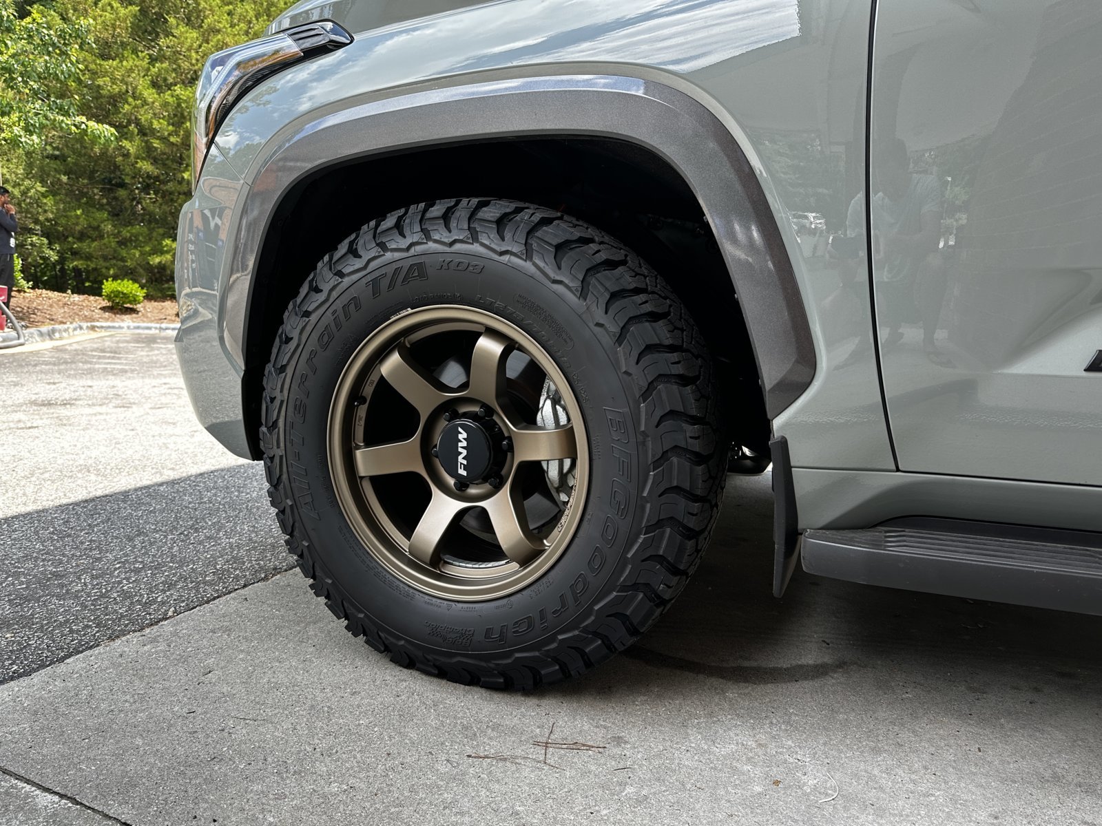

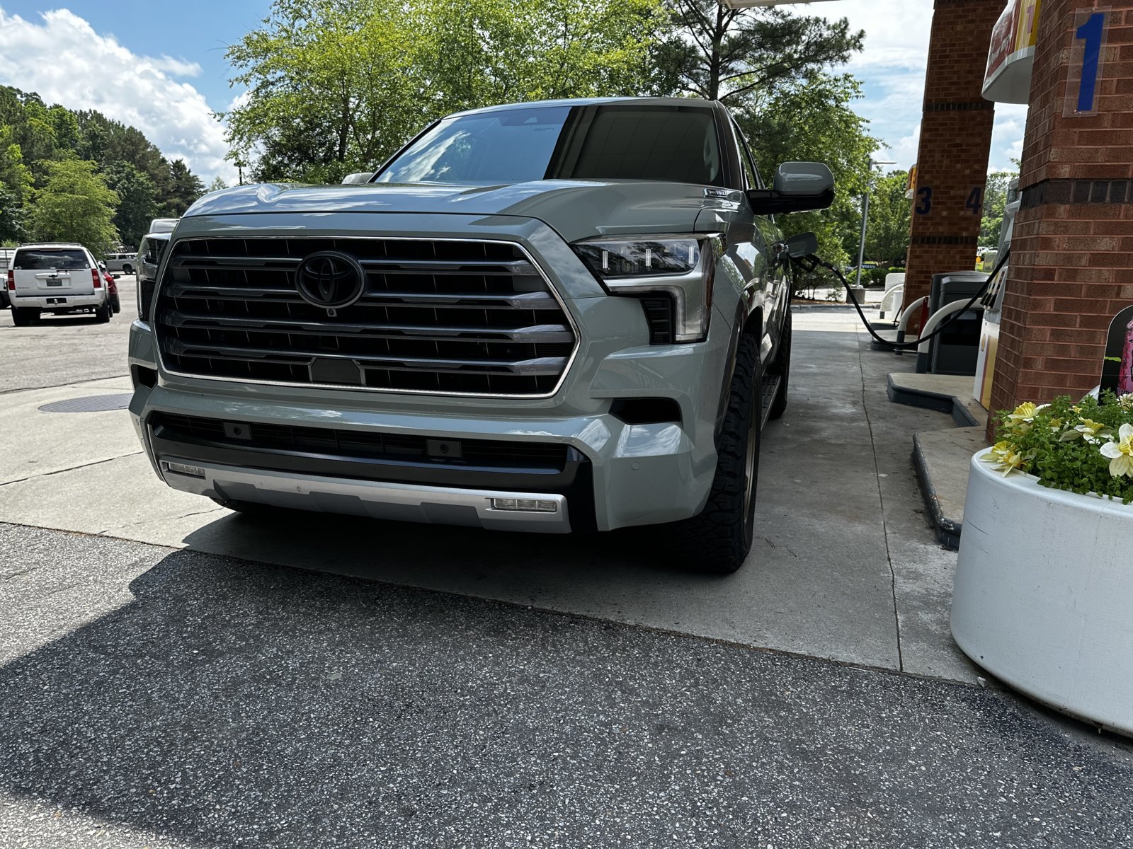

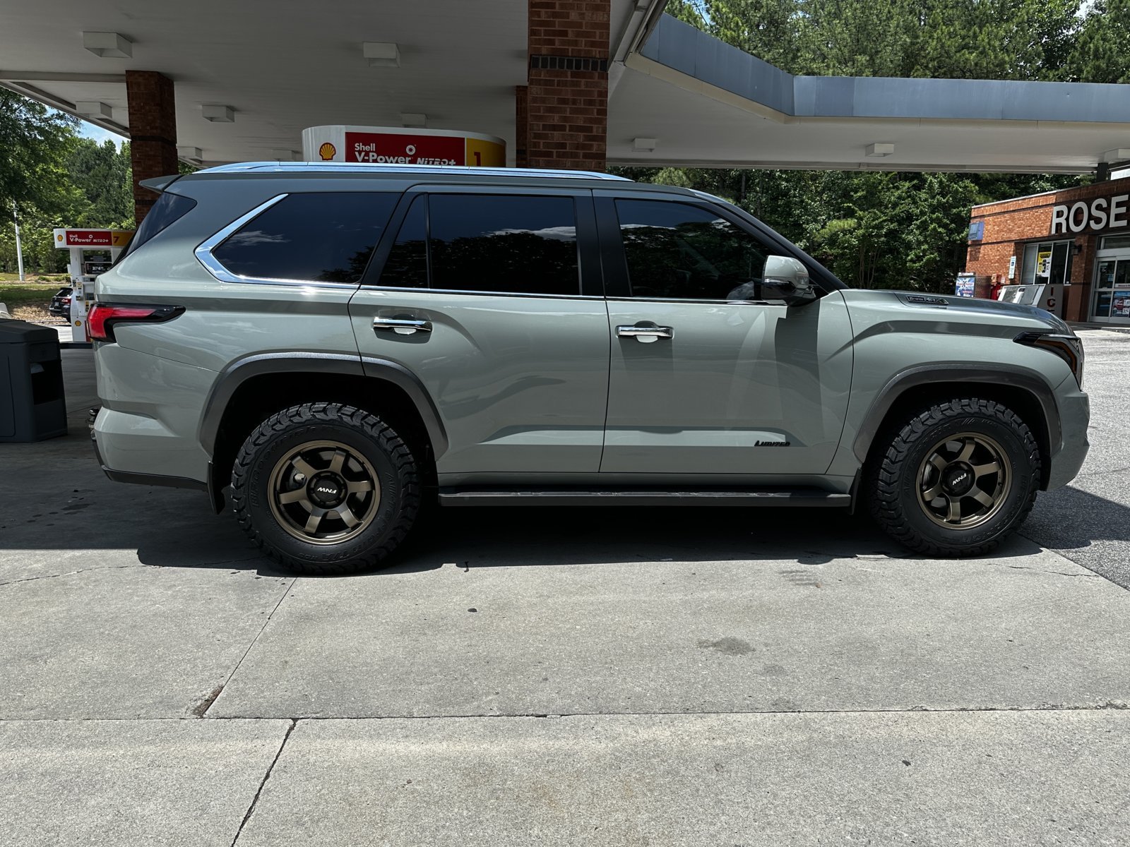

    My Sequoia went from “soccer mom” to “get out of the way or I’ll climb over your mini van”.
    2024 Sequoia, Limited 4x4, non OR.
    Matte Bronze FN BFD +20mm with 275/70r18 KO3’s.

    Awesome color combo

    Man those FN's are sexy. :thumbsup:
    Definitely on the short list for wheels.

    Always happy to see something other than black or chrome wheels. Nicely done.

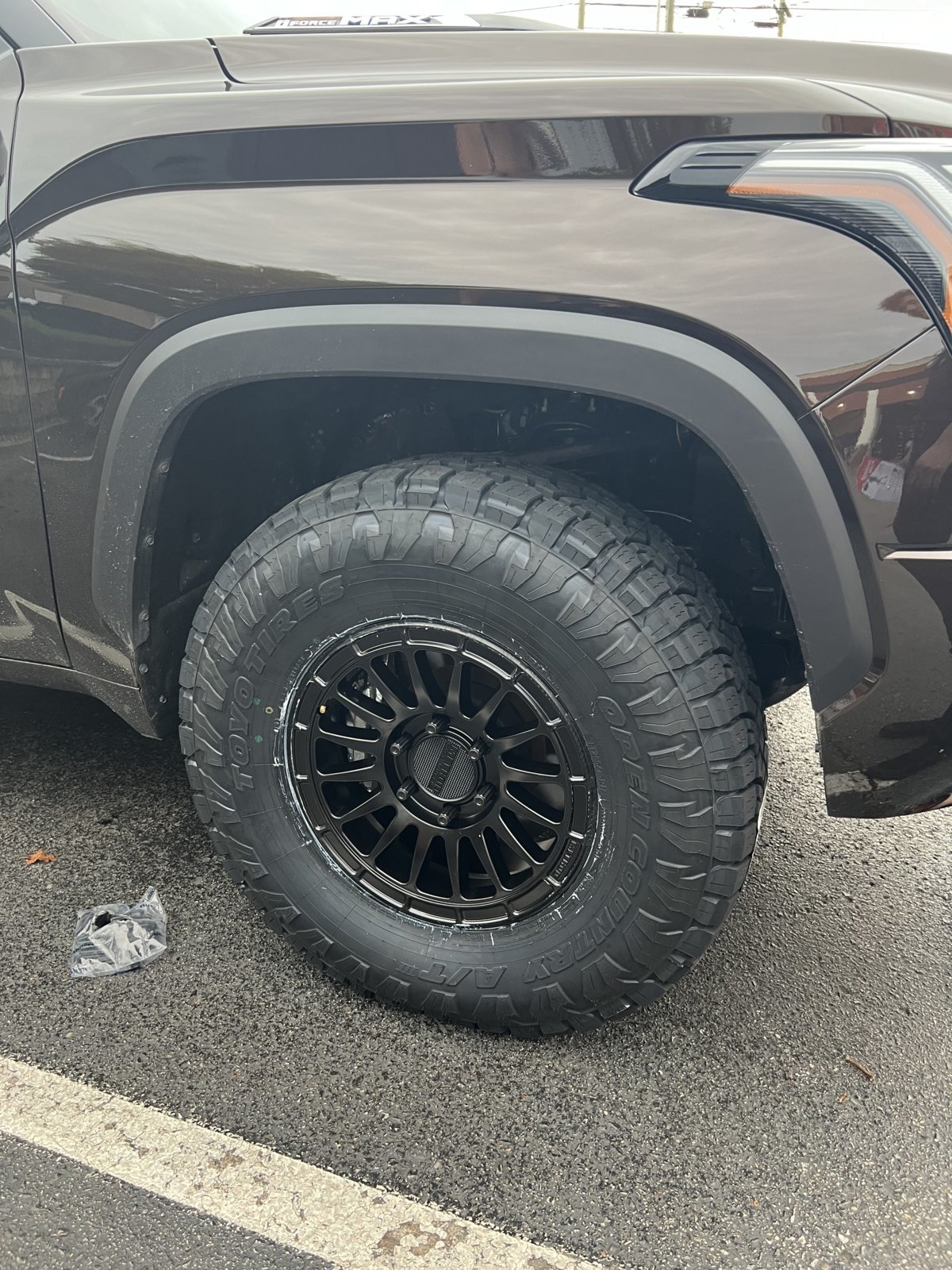

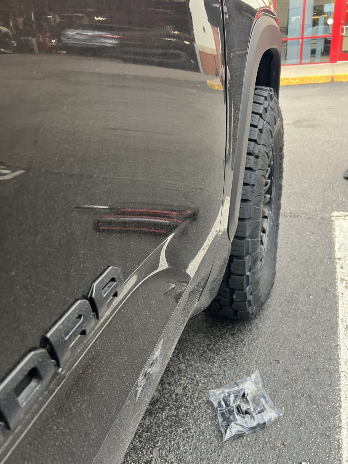

    18” Method Wheels, 35x12.5 Toyo AT3, TRD Pro suspension with Westcott preload lift and Icon rear springs
    Finally took the plunge and upgraded to 35s. Went with 35x12.5 Toyo AT3 on Method MR316 18x9 +18mm offset. Added a 2” BDS level to make sure I had clearance. No rubbing or cutting needed.

    Looks great! Definitely not a "soccer mom" Sequoia!
