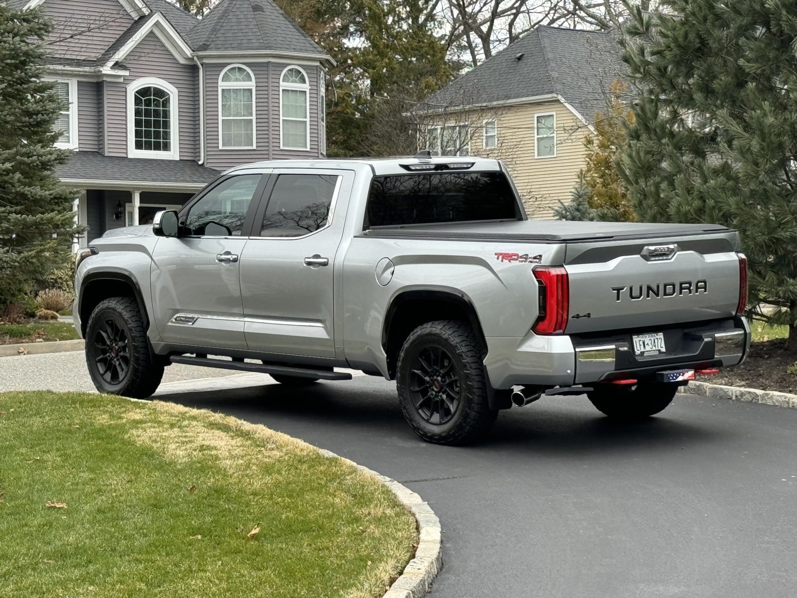

    Paul, your truck looks great! I have my new TRD being built as of this week and am looking to put the same size tires on it. Do you know what your new roof height is in inches with the bigger tires? My garage at work has me limited at 80" max height and am hoping these tires will still allow me to fit in the garage.
    Thanks!

    Thank you! I will measure first thing tomorrow morning and let you know.

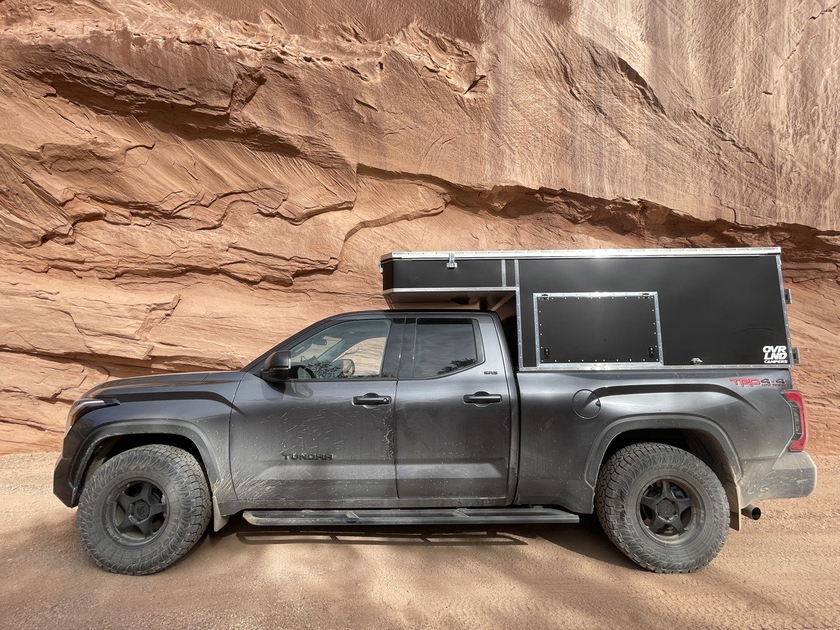

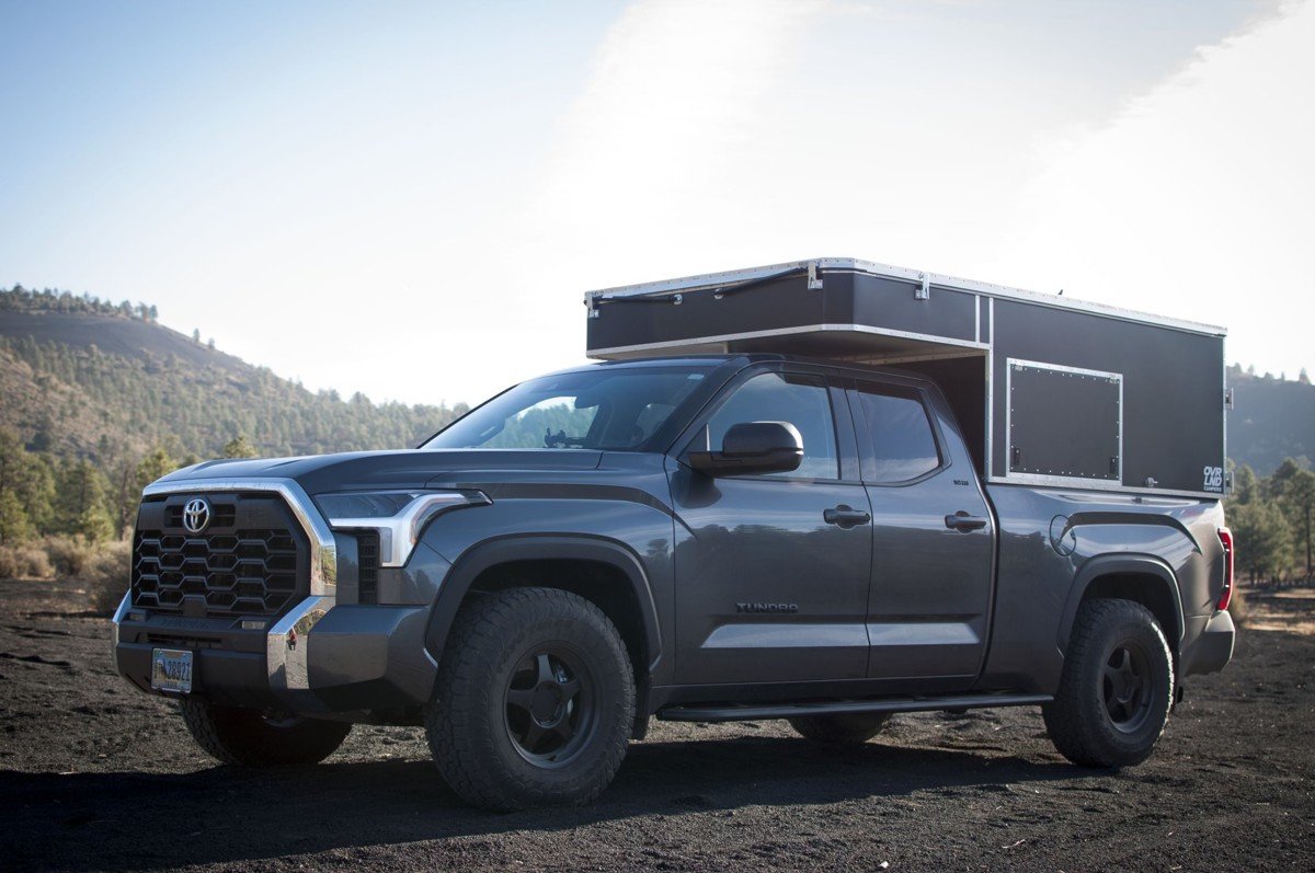

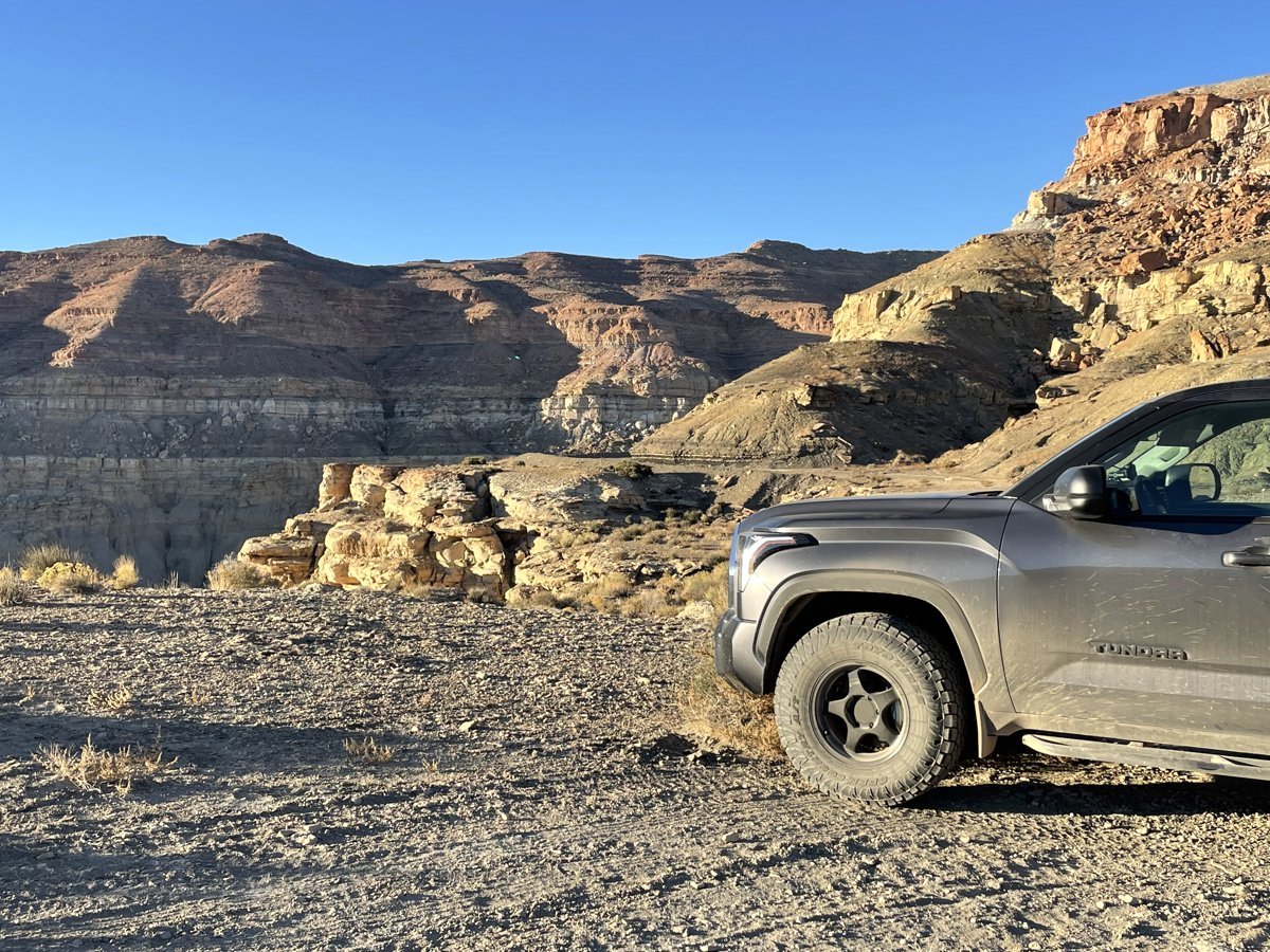

    1) Does it all boil down to just biting the bullet on tires and wheels and then making necessary adjustments?
    If you're trying to avoid rubbing and you wish to maintain your stock TRD Offroad OEM suspension (i.e. no lift) I would consider a 34" tire diameter with a width somewhere in the range of 275mm ~ 295mm (10.5" ~ 11.5") about as large as you should go. The rim width should be 8" ~ 9" and the offset should be +20mm or higher. This is a generalization, but a pretty good rule of thumb.
    Some people have had success squeezing 35's onto the OEM wheels with stock suspension while others have reported some rubbing, so I'd say 34's are the way to go if you want to avoid or minimize the rubbing.
    These pictures are from one my customers with a 2023 Tundra 4x4 TRD Offroad, stock suspension, 17x9" +25mm offset Five Stars and 285/75R17 Toyo Open Country AT-III tires (34"). He reported very minimal rubbing on his front mud flaps while offroading and no rubbing on the street.

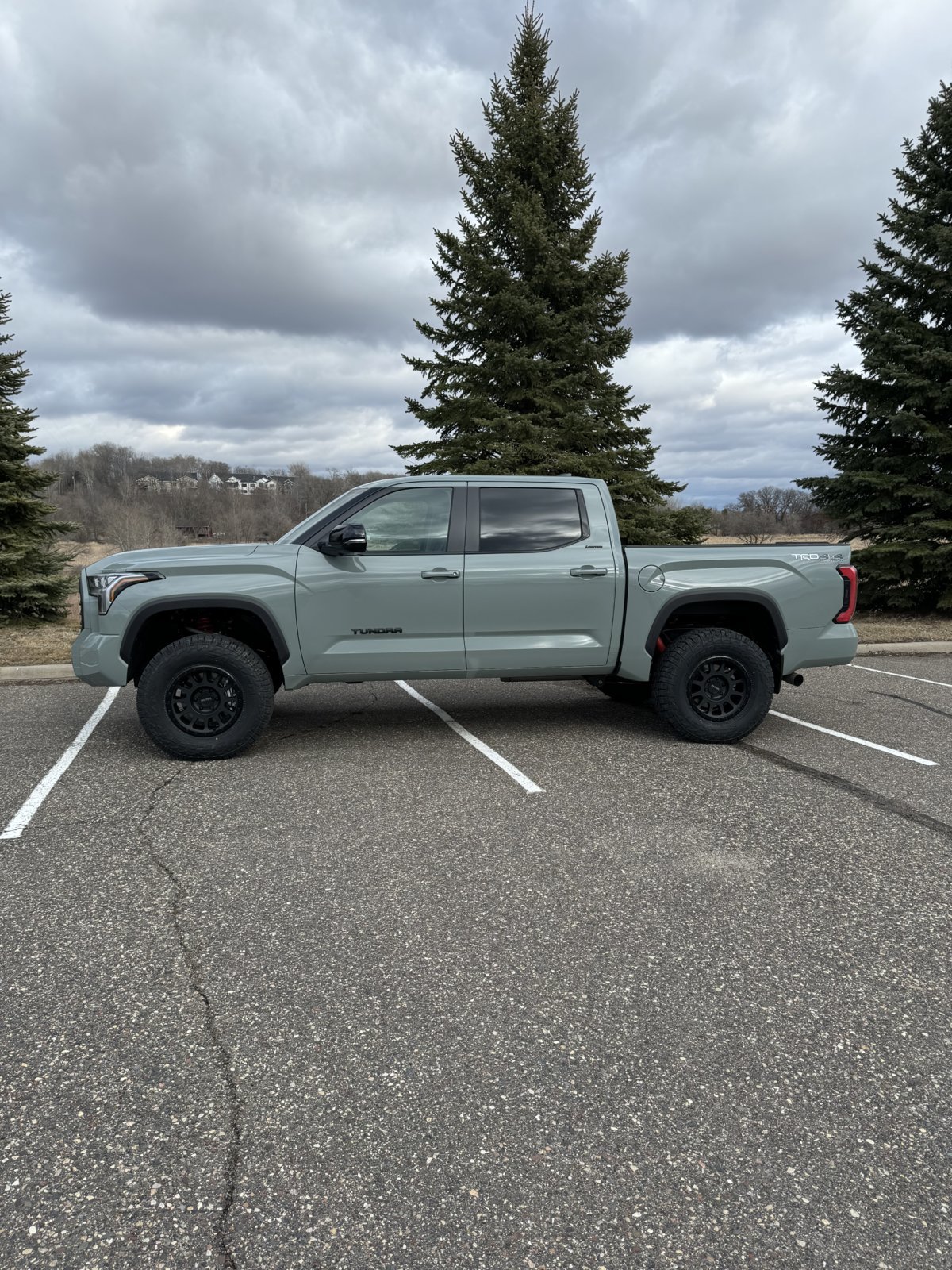

    Minnesota
    2024 Lunar Rock Tundra Limited TRD Off-Road w/3" TRD Lift Kit
    TRD 3" Lift Kit, Method NV Double Black, Falken Wildpeak A/T4W 35x11.5r18
    yes, C rated! Still a bit stiffer than stock, but overall I like the ride, and so does the wife, and they’re pretty quiet tires.

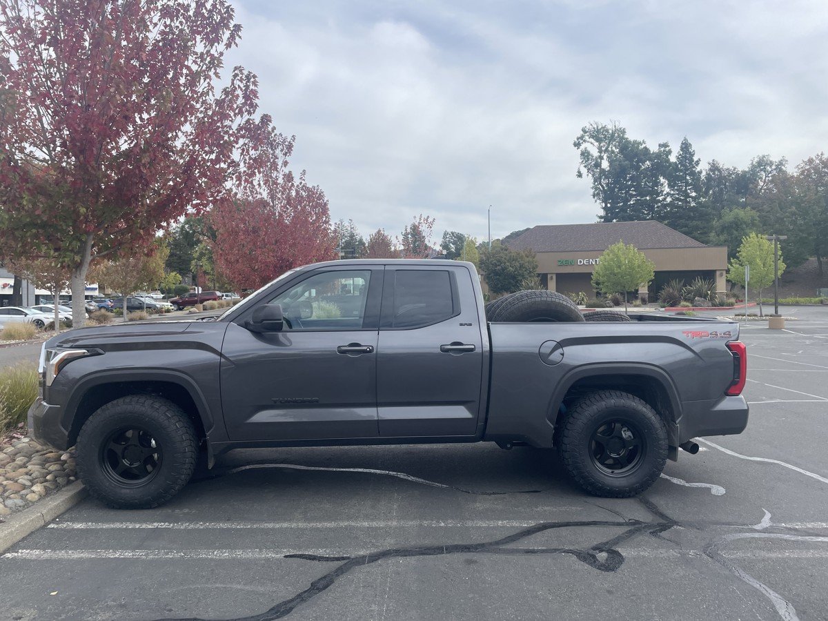

    Just installed Kansei 17x8.5” wheels and 315/70/17 load range C Goodyear Territory MT tires and the ride is so stiff. Aired down from 40psi to around 32, it got better but still bouncing around. There are no suspension mods. I had the 20” limited wheel and tire set up and thought if anything the ride would get better since there’s more sidewall. Is this anyone else’s experience?IMG_5488.jpg IMG_5493.png
