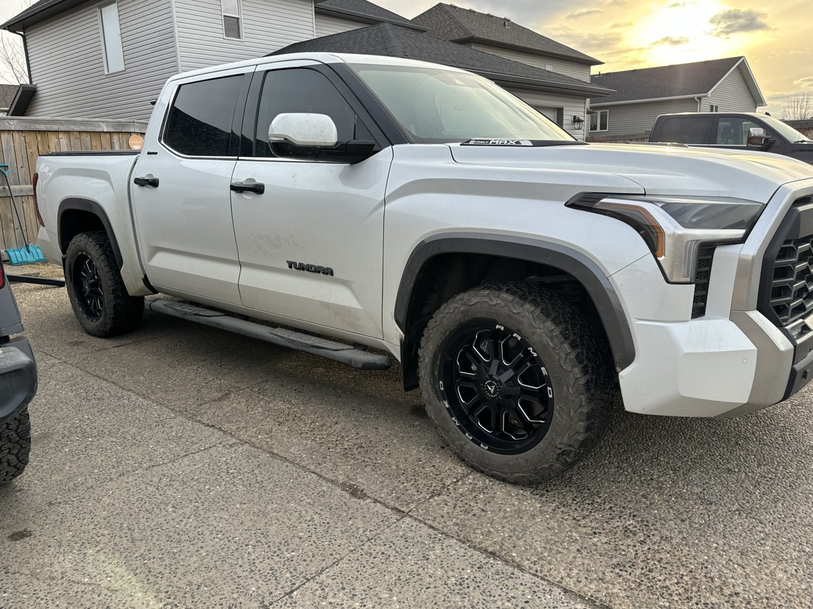

    working on it
    ‘23 limited
    20” Armed Cannon wheels +18 offset
    Stock size BF Ko2
    Stock height with stock mudflaps
    No rubbing
    Just enough poke for my liking.

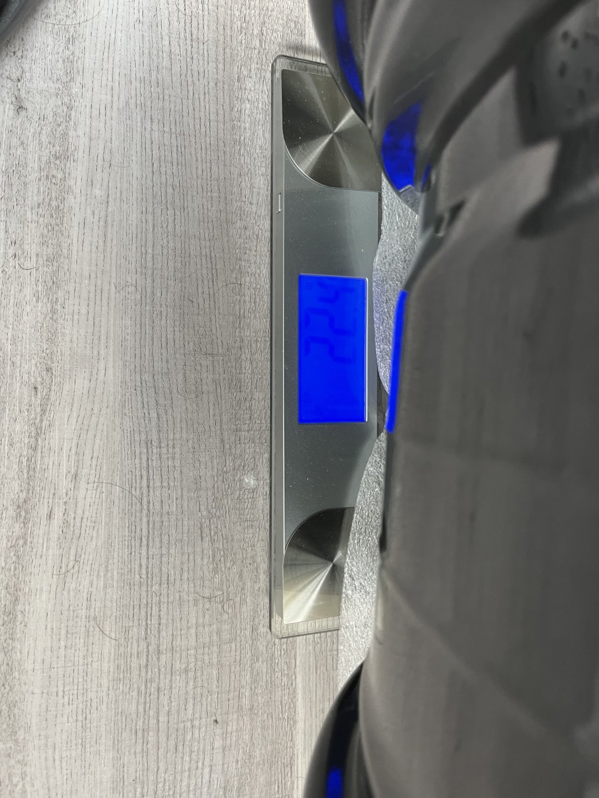

    22.4 lbs….I weighed mine.

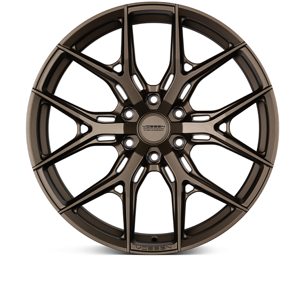

    All good info., I appreciate the knowledge. My concerns lie within a few things; first is the amount of tire that will be poking out, I don't mind a little, but one of the wheel companies selling them said the new wheel at -18mm offset would be 4.08" farther out than the OEM wheel, it sounded a bit off. If my stock wheel is at 60 offset and I move it to -18, I would expect about a 3.1" move of wheel face, not 4.08", either way, still pretty aggressive. I do have some concerns about possible debris kicking up but not a deal breaker. And third is the wear on components. I found a different wheel, similar color and style but its a 22x9.5 +20 offset. I would think that would be a more reasonable wheel setup.
    4Play is the -18 offset: https://4playwheels.com/wp-content/uploads/2023/12/4P83-20100-6D55-18BR-1.png
    Vossen is +20 offset: https://vossenwheels.com/wp-content...d-Forged-Series-©-Vossen-Wheels-2019-0700.jpg

    The shop informed you correctly.
    Your OEM 20" 1794 wheels are 8" wide with +60mm offset.
    Compared to a 10" wide wheel with -18mm offset you're looking at a difference of 78mm (3.07") due to the offset and 1" due to the 2" difference in width (1" to the outside of the wheel and 1" to the inside). 1" + 3.07" = 4.07" wider stance than stock (per corner).
    If you're looking to avoid slinging debris down the side of the truck these specs are definitely too aggressive.
    The 22x9.5" +20mm offset wheel is still quite aggressive, but not anywhere near as aggressive as the 20x10" -18mm offset wheel.
