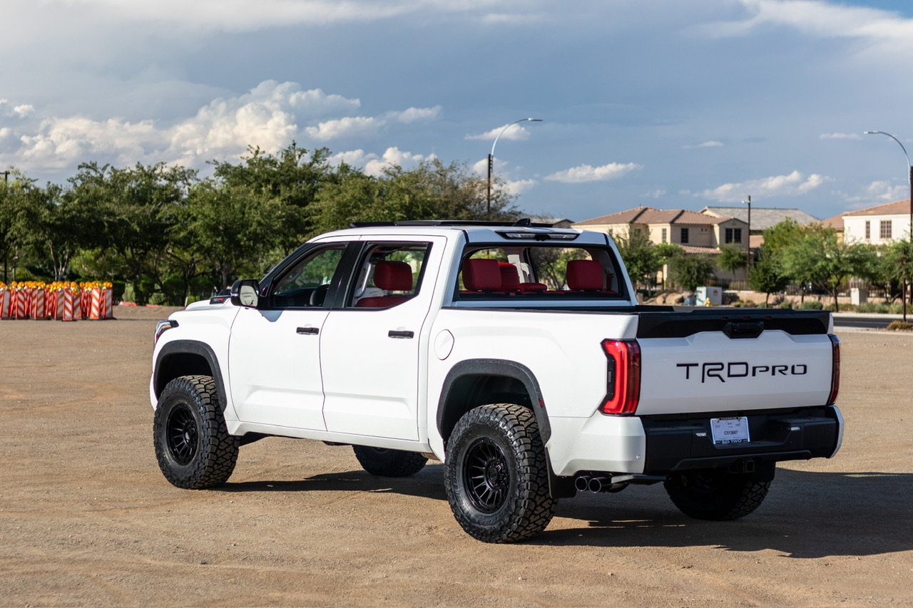

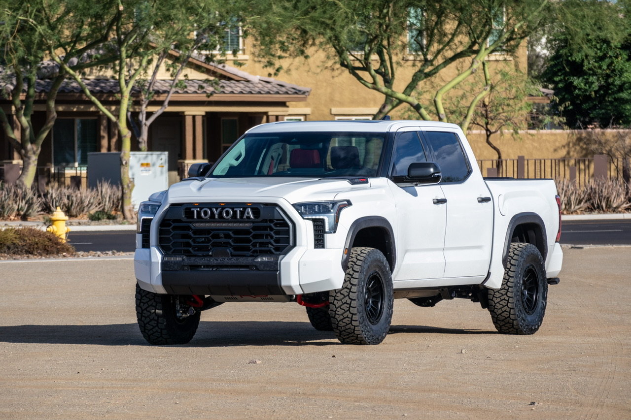

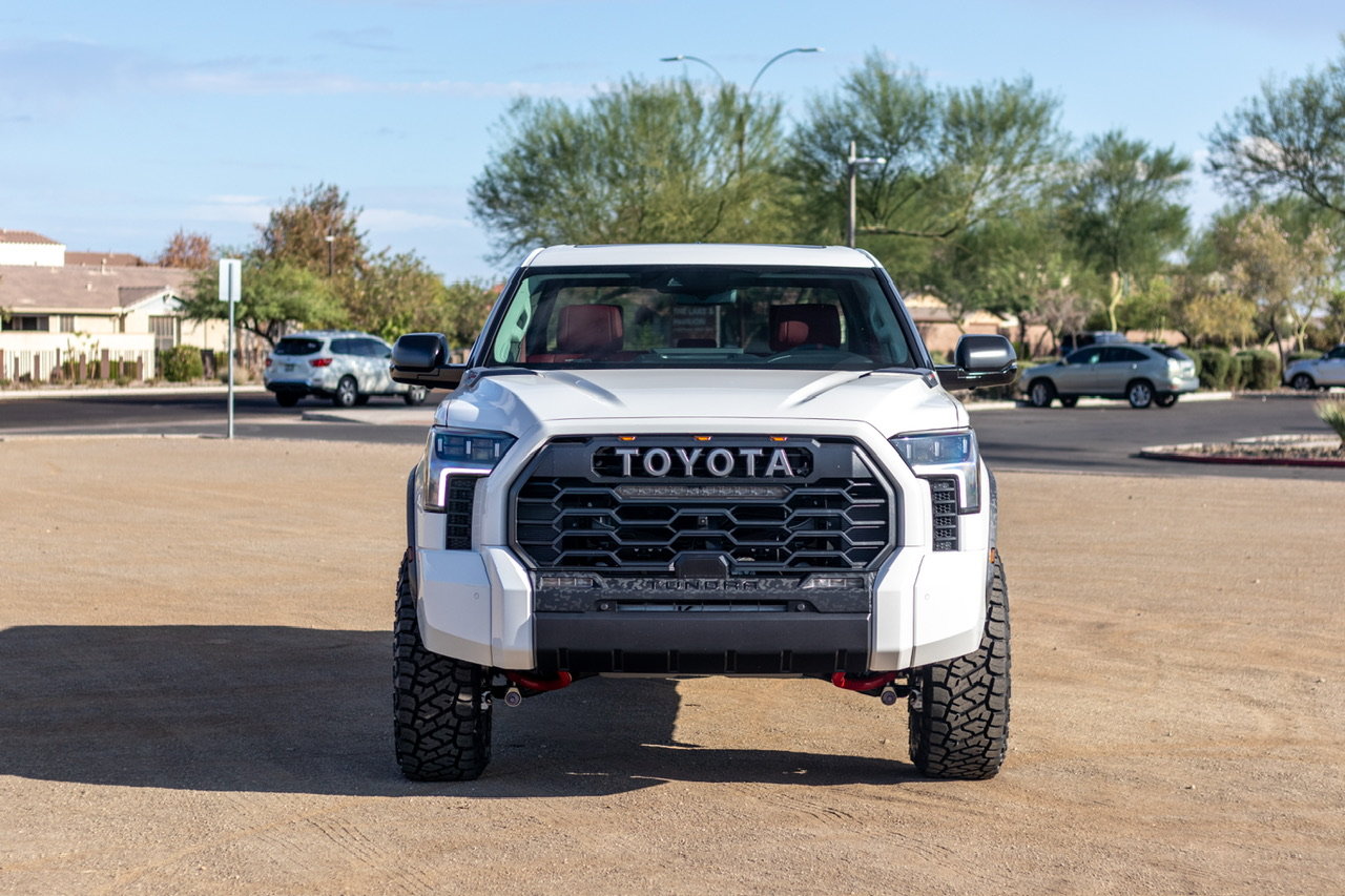

    KMC Impact 17x8.5 0mm
    Toyo Open Country RT Trail 35x12.5r17
    Westcott 3/1 lift

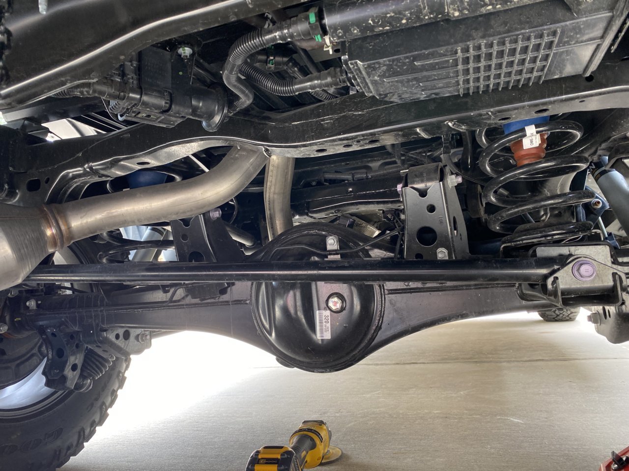

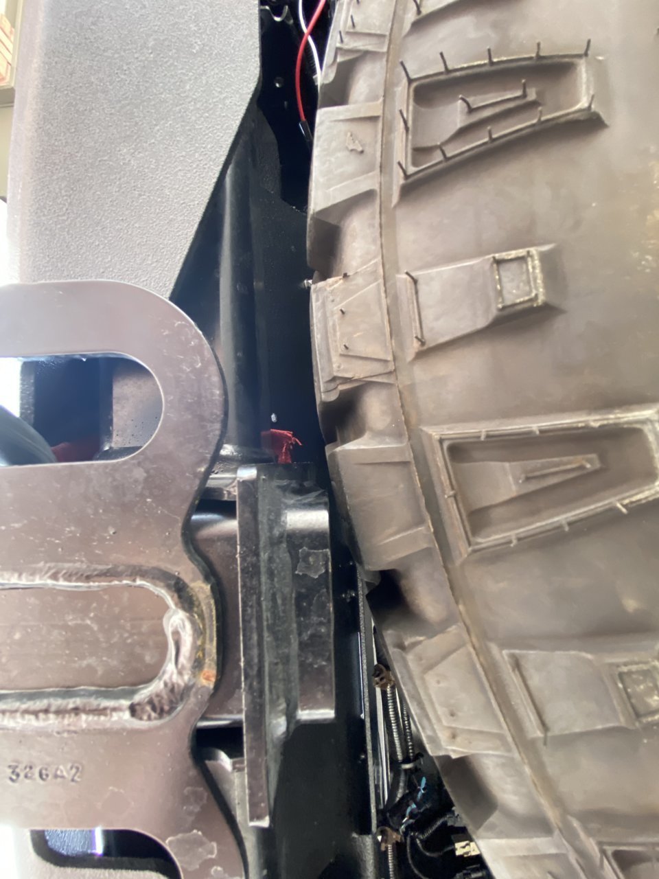

    Welp… A 285/75/18 Goodyear duratrac will not fit in spare tire location (35.1” per manufacture specs). Rubbing on the pan hard bar… Gonna cut off the spare tire mount brackets to see if it’ll help.

    Cutting off the support brackets helped a little. Released some air but it’s still rubbing the pan hard slightly. I’m not doing hardcore flexing of the rear end (mostly towing and occasional beach trip). I think I’ll be okay with the steel bar rubbing against the tire with the conditions I’m in.

    I don’t recommend cutting off the brackets towards to cab.. It’s a little wobbly but I’m not worried about it. Can’t see it in pic but it now clears the pan hard bar by millimeters

    Thanks for this. There’s really no fitting anything bigger in there unless you do some sort of relocation. I think the raptors with 37s actually moved the frame.

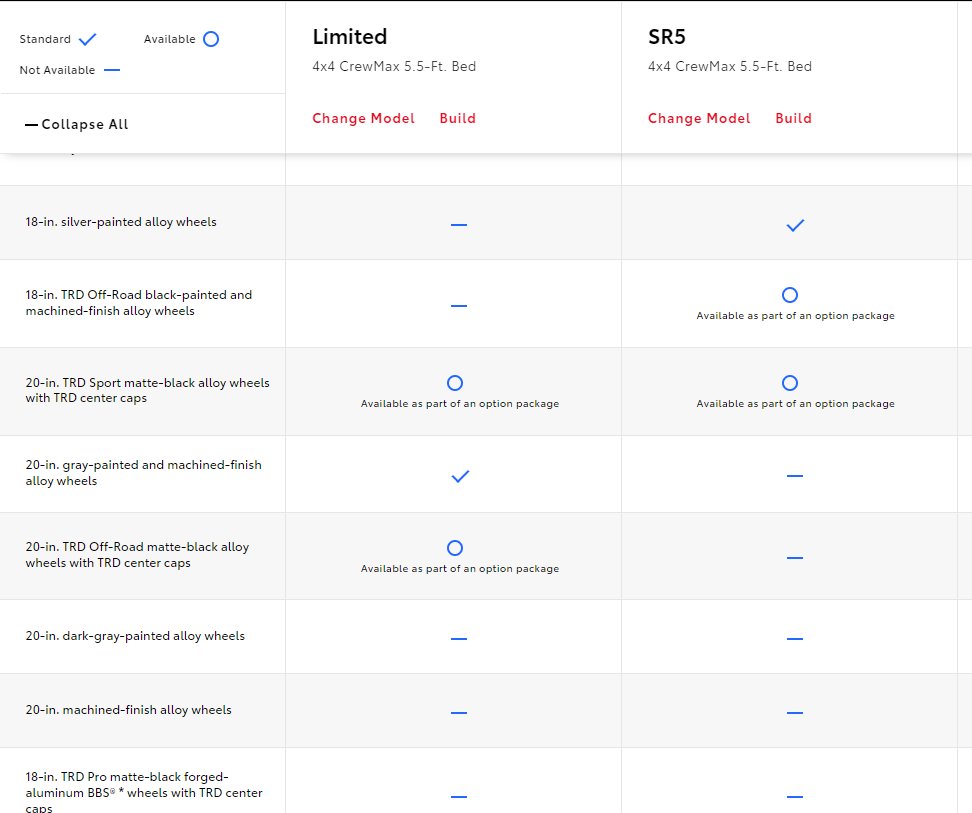

    Whats the stock wheel size for limited hybrid TRD off road? Is it 265/60R20 or the 18 inchers?

    in Canada we get 265/70r18. In the states I believe you’re correct.

    Limited comes with 20" wheels (265/60R20) on standard and TRD trim.
