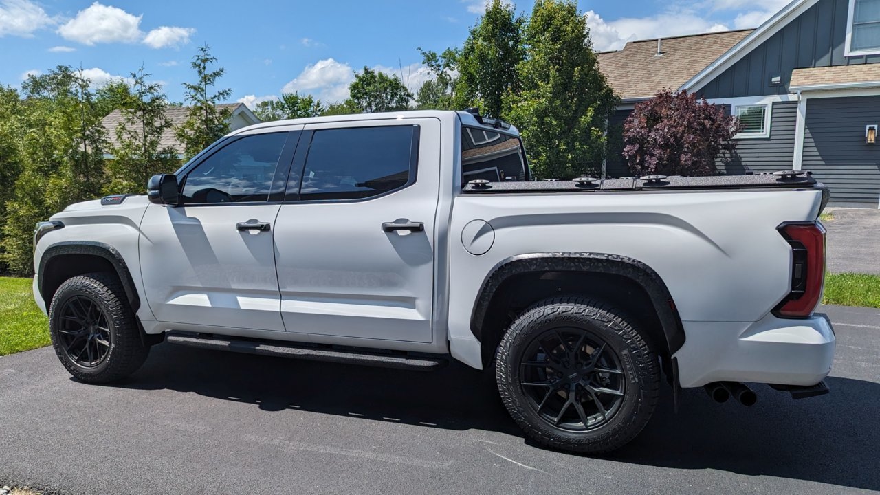

    I dont like how the Platinum 20” stock whees and tires look. So i got some Vision Turbine 20” wheels and some 295/60/20 Nitto Ridge Grappler which i think are about 34” today. After all, they are between 1” and 1.5” poke which look fine to me. They are already touching the fender lines at full turn so i did not want to risk it by going 295/65/20 which is 35”. I dont believe they will look that different anyway. Since im not gonna do any lift in the near term. I think this set up work for now. Will try to take better pics soon
