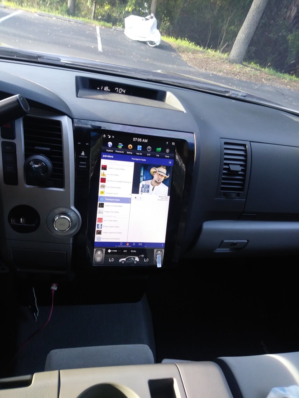

    And i got the red air bag light illuminated on the dash. Will go away i heard if you disconnect the a/c and radio it will do that what do you think.

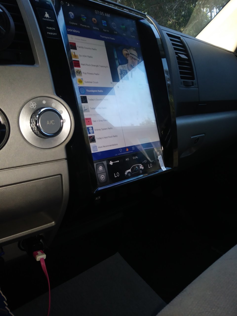

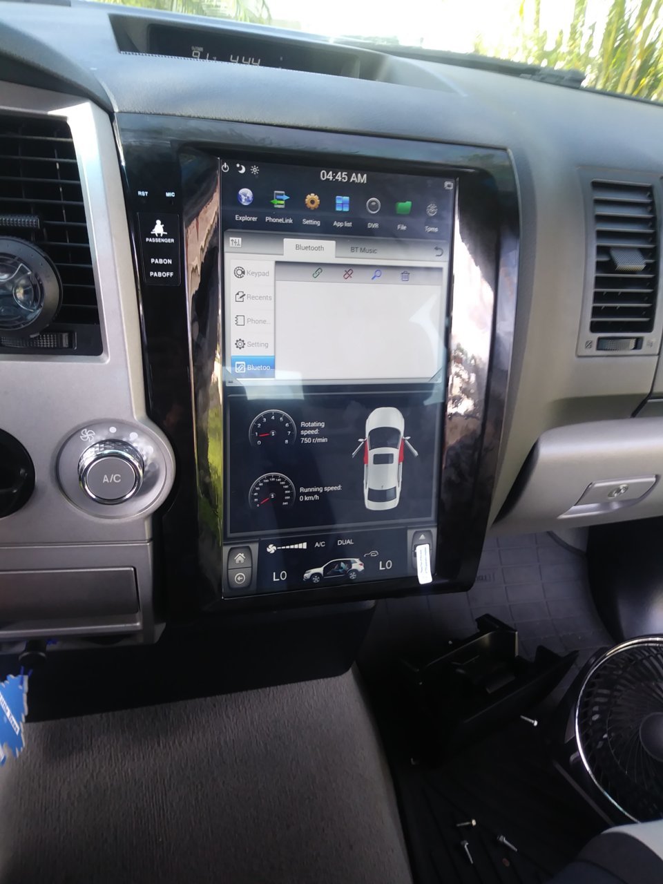

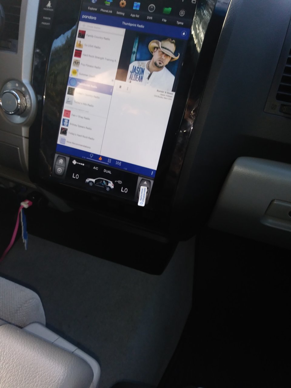

    I decided not to hook up the camera just because it would look werid in a way and im not going to spend 100 on a tailgate camera. 20190623_164517.jpg

    Try this. ...

    Ok thanks i got it now. Yea that makes sense now because now when a passenger sits down the light is on for the airbag on the headunit which is good so thanks for helping...

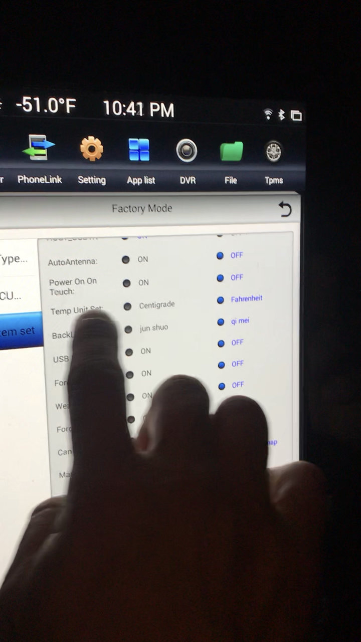

    Hey on the Tesla unit how do you change Celsius into Fahrenheit I cannot find it for the life of me LOL

    Settings>System Settings>Temp Unit Set

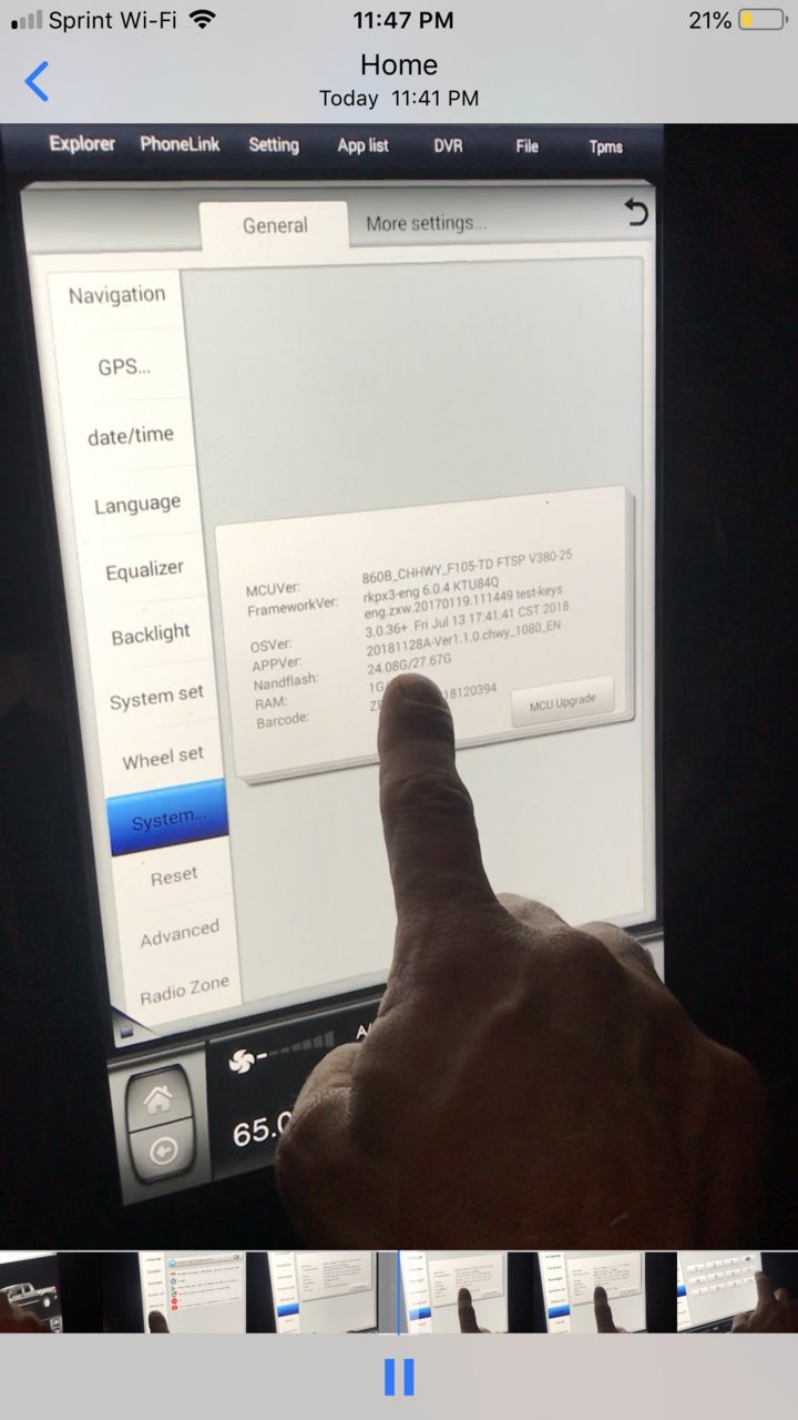

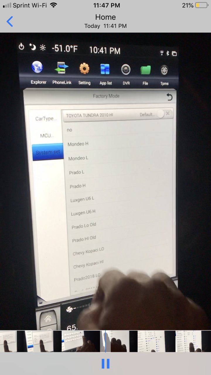

    I’ll send a video, I think
    Settings>hold white box until it ask for code
    Code : 7890
    Scroll down to c° or f°

    Settings at the top
    Click “system”
    Hold the white badge
    Type 7-8-9-0-ok
    Select: system set
    Scroll down to c-f
    * take pictures of anything u change before changing the settings, a lot of times messing in this section causes unexpected results
