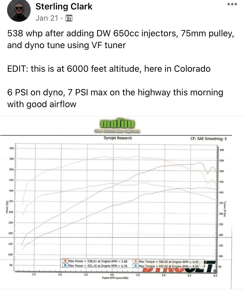

    Here’s what a 75mm on a Harrop 2650 at 6k ft could get you. Stock it comes with an 85mm, and you can get down to a 60mm mostly in 5mm increments aside from the 77.5mm which is what I have at sea level. If you go with a Magnuson 2650 @snivilous makes a variety of comparable sizes for that blower as well. Whipple I think can still be bought but they may not be available anymore shortly it is sounding like.

    have you read/heard anything of people going from the altitude configuration to sea level and experiencing issues?

    Yes, you'll make a ton of boost and most likely have issues. The supercharger pulley is 4 bolts to swap so is easy to do, or there's methods to keep the boost low despite the smaller pulley at sea level. If you're in Colorado and go to sea level you'll probably make ~double the boost at sea level that you did in Colorado.

    I wouldn’t tune it at elevation and then go flooring it all around town at sea level. That said, that 75mm pulley for example lots of people are running smaller than that even at sea level where it makes about 10psi. The issue comes in with what it was tuned for. That pulley makes 7psi at elevation, but atmospheric pressure is lower at 6k feet also, around 12psi. 12+7 = 19psia in the manifold. The same pulley makes 10 at sea level, with atmospheric pressure at 14.7psia. 14.7+10 = 24.7psia in the manifold. Several people run 10 at sea level, but they’re tuned at sea level.
