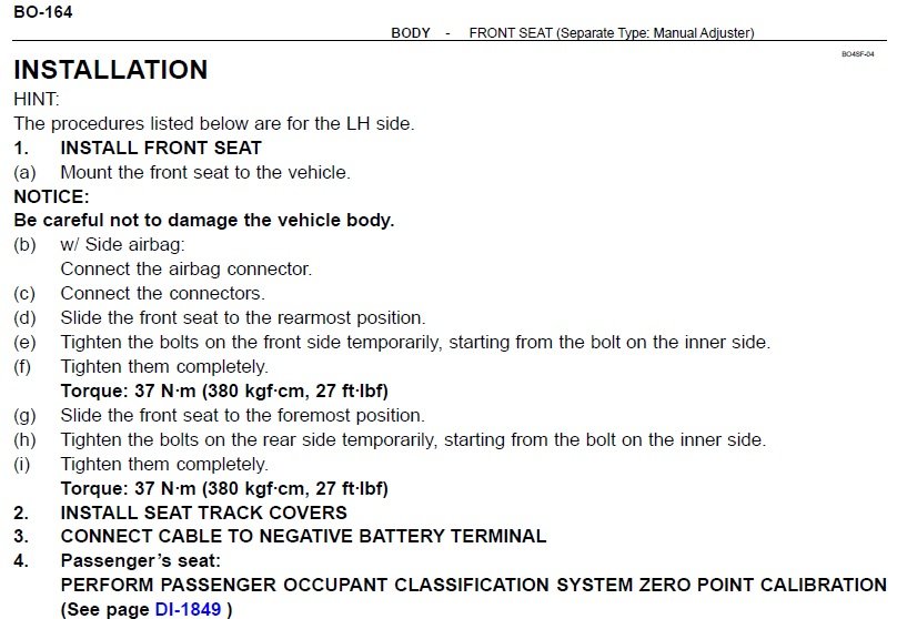

    Just bought a Sunex 3/8' drive torque wrench. Even if I don't get much use out of it, my geezer friends will be SO jealous. BTW, if I decide to torque my seat bolts, what's the recommended foot pound setting?

    According to the 05 FSM, regardless of which kind of seat....mechanicl, elec, bench, split, etc....torque is 27 ft lb. For me it was German tight and 1 or 2 uggas.
    The thread shift linked to above also has a link to 05 FSM if you wish to download and look in Body section BO for other seat notes, especially when it comes to pass seat and zero calibration.

    Interestingly, to me, I had 27 ft lbs in my mind as the torque for the seats, but no idea where that came from.
