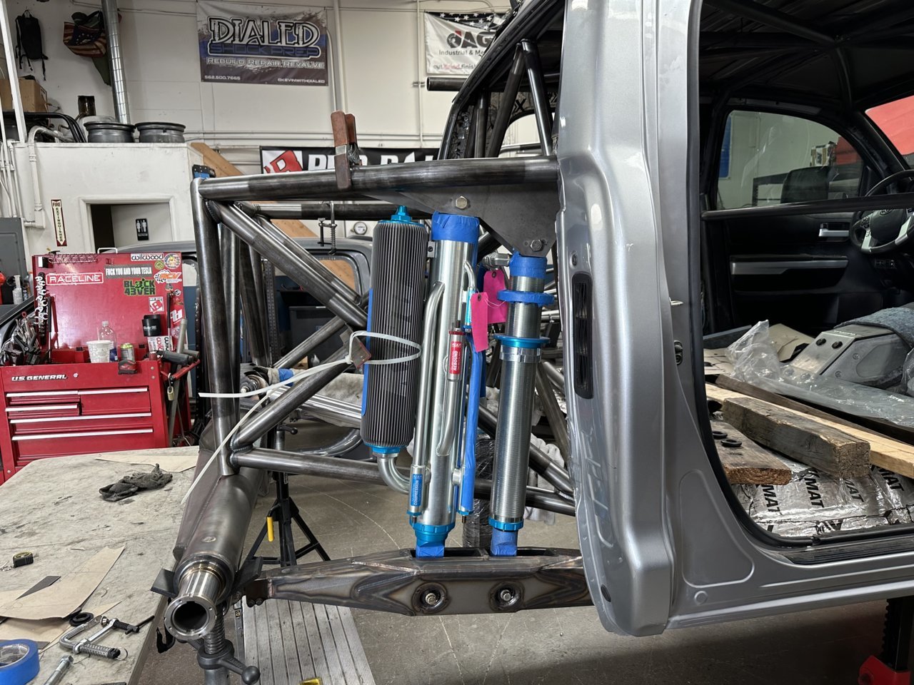

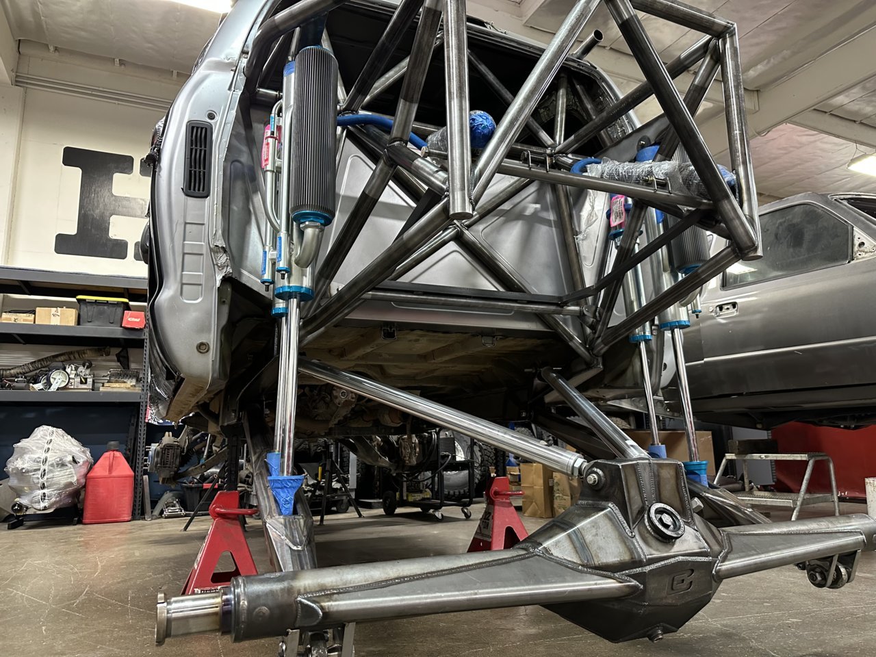

    Awesome progress. I’m guessing 25”-28” rear travel expected? Interested to see how they'll work on the rear axle abs crap. I know the sensors tied to a lot of things within the ecu

    keeping the rear travel a secret till she's all done

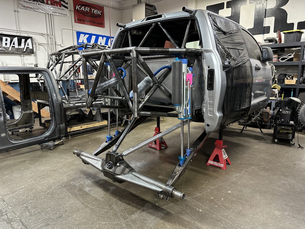

    Just pull the ABS 1 fuse on a build like this. Disables ABS, traction control and ATRAC. I assume this’ll have a locker and won’t need any Nannie’s. Our fuse has been out for like two years now.
    Or go stand alone engine management. I need to scroll back through and see how deep this is getting. Great build @gears_call
