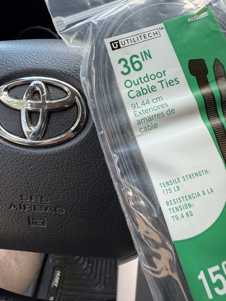

    This worked! I was skeptical but I wanted to start with the simplest & least expensive intervention.
    Recently had a check engine light activation due to vapor / emissions and the mechanic told me they could find nothing wrong. I filled up my tank after picking up the truck then road-tripped a few hundred miles. Upon returning I was unable to put in more than maybe .50 cents at a time but no check engine.
    Nevertheless, after watching videos and reading through a number of threads I found this one last night. I went to Lowe’s Hardware this morning, grabbed these and headed to the gas station.
    To ensure it wasn’t a fluke the past two times I tried to fill up, I tried again and was unsuccessful.
    I fed the tie into the tank until I met resistance, did a little manipulating and pressing until I felt a definitive *pop*.
    Voila! Filled the tank from the 1/4 mark to full with gauges reading correctly and so far no other issues. Fingers crossed I’ll update sometime in the future to confirm how long this fix lasted.
    What a relief! Thank you!!!!
