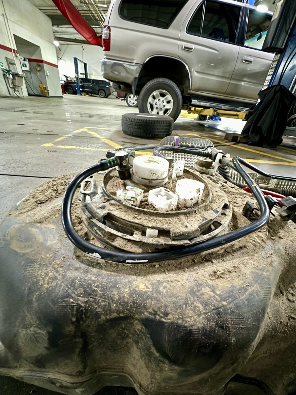

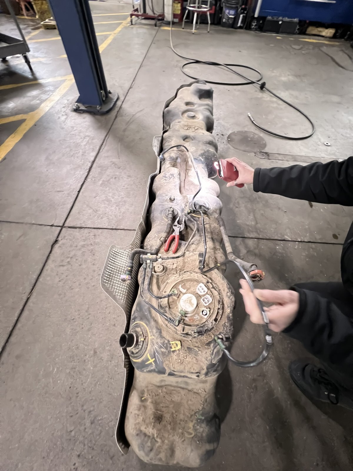

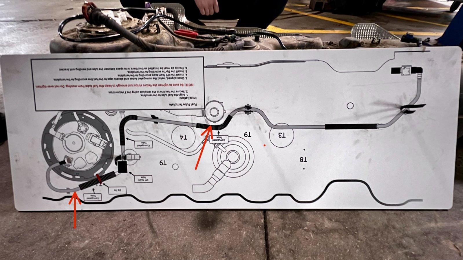

    UPDATE:
    I figured I would keep this going for anyone following. Not interested in the banter, want those who are concerned to have the resources to at least try to check their trucks at home if your dealership can't get you in.
    Went into the dealership today and they had a few other trucks in getting the temp fix done. Techs said they had only got the parts in for the temp fix last week and were just starting to push them out this week. My gas line had rubbed the break line all the way through and had begun to rub 1/2 to 1/4 way through at another spot (red arrows). The other posts I have seen so far are wrong about the location of where the rub is happening, it is not where you see the two lines cross above the tank, but rather it is against the break lines that are attached to the frame (picture attached). Each spot that was marked on the template for corrugated plastic was rubbing on my line. I would assume that the location on the top middle of the tank that was wearing will effect everyone's truck at some point.
    They fired up the truck and drove it into the shop there (apparent communication breakdown) and the tech's first words to me were "I hope you didn't drive that thing down here, it was spraying fuel all over the shop. Those lines are at 40-60PSI"
    Let's keep it civil and make sure everyone is safe.

    Is that you in the shop taking photos of the tank and such or did a tech do that for you??? (just curious)
    But, either way, it looks like at this point (at least) the shop is being transparent w/you and not trying to make excuses or 'hide' anything; which is good. I'm glad you're getting taken care of now. Sucks that you ended up in this position, but fortunately you had the whereabouts to watch for issues and dig a bit deeper when something more presented itself.
    Hopefully your posts will help folks understand a bit better what is actually going on here. This kind of information gives consumers a better perspective :thumbsup:

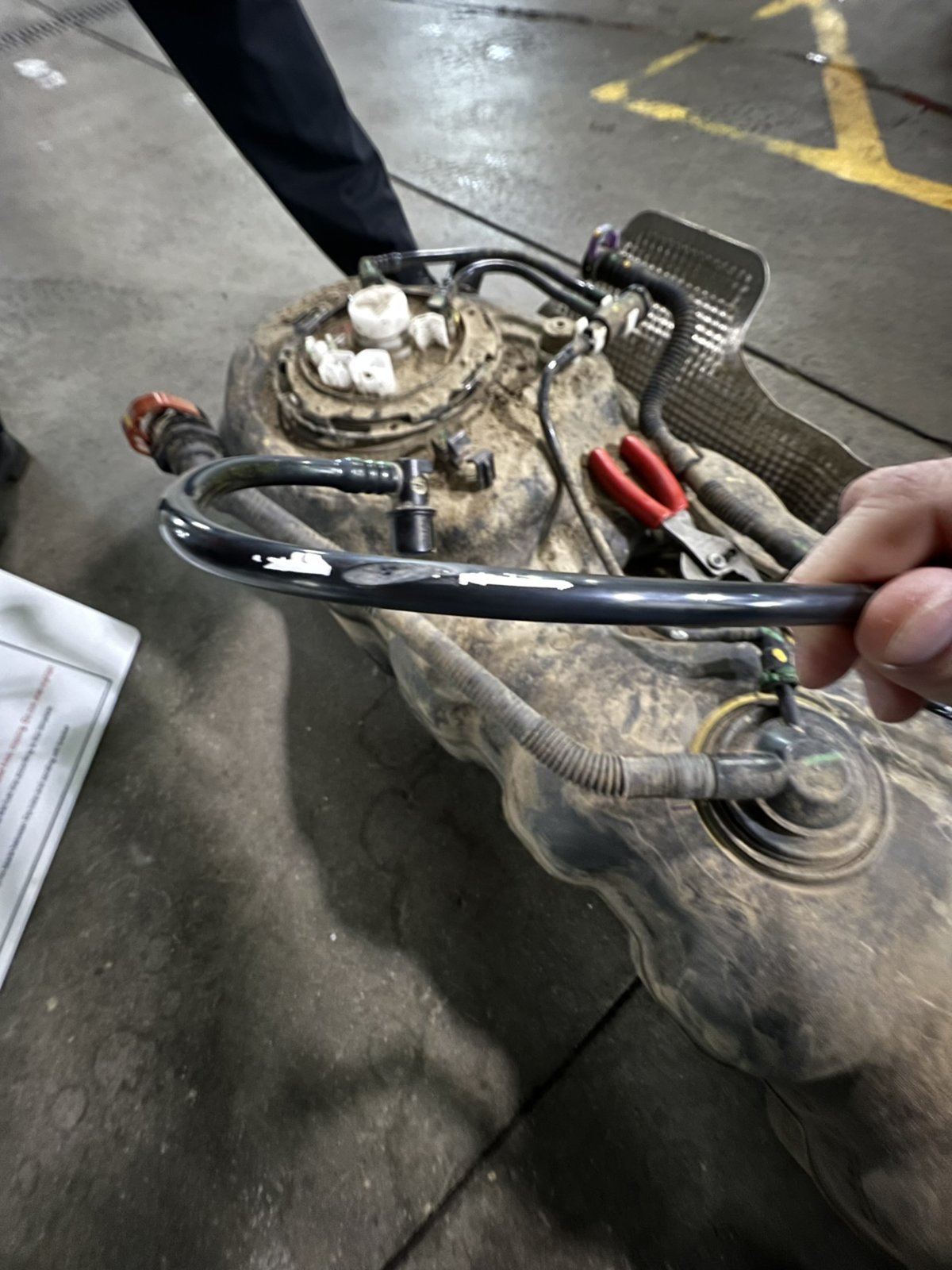

    That big chunk of material missing on your first picture is where the leak was?

    Correct. In between the white marks is where the break line rubbed through the plastic fuel line

    Yep, they had it all laid out for me to look at which was very transparent. I am going to go back in before it is installed as well to see what the fix looks like before the tank is bolted back on. I'm not sure I am interested in the "zip tie fix" for a fuel line at this point after seeing all the wear that line has taken, but we will see.
    And yes more information the better for everyone to make their decisions

    Kudos to the OP for providing the most visual content I've seen on the issue, so far. It appears there are multiple locations where a potential leak can occur.

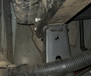

    While they have it down, have them look for loose bolts, like this one in your post

    Thank you for catching this! I will sent that over to them

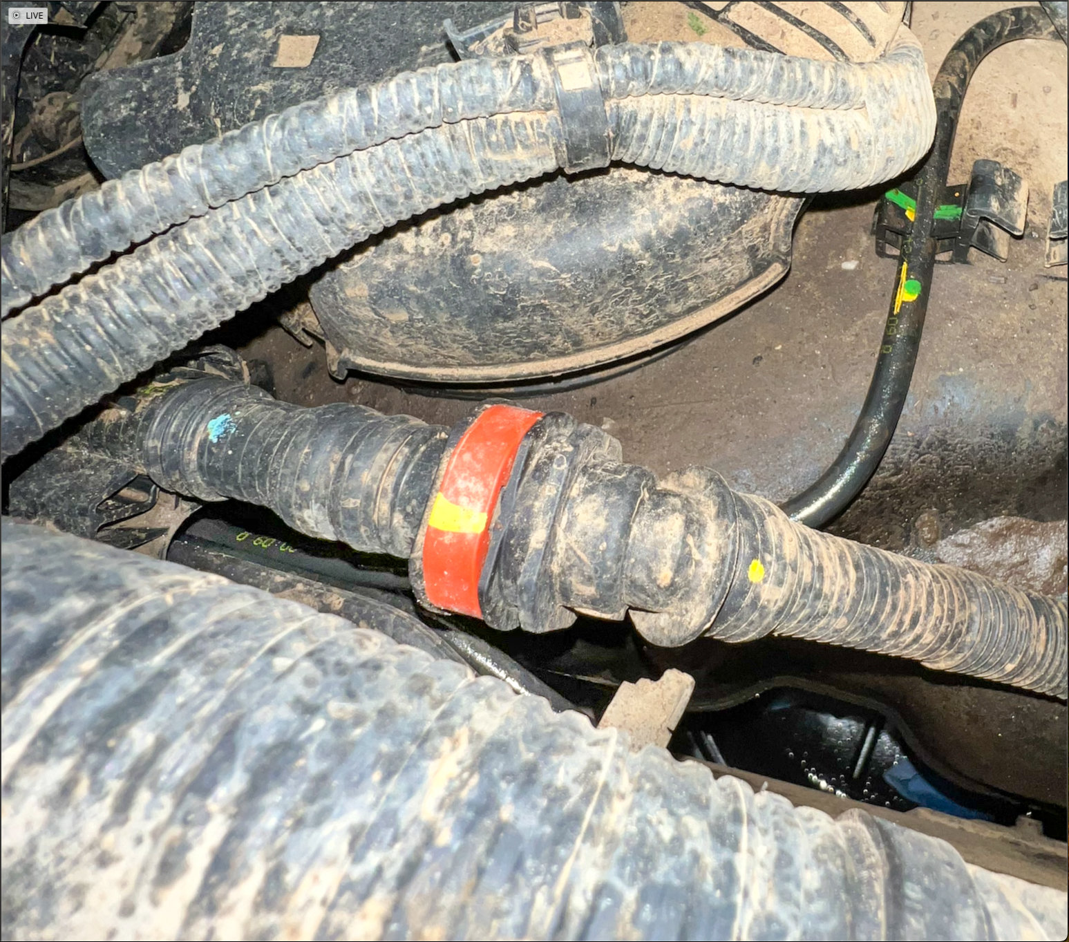

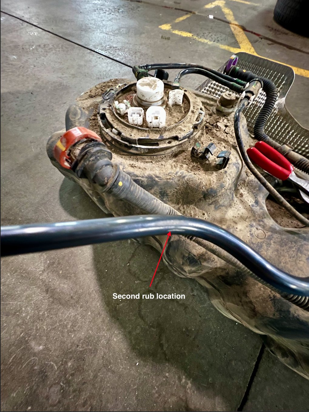

    Found a photo that shows where the two lines were contacting. It is actually on the side between the frame and the fuel tank. Interestingly on the template for the temp fix, the corrugated plastic looks to be installed further up the line where the fuel line crossed under the other plastic line and not where mine rubbed.
    The fuel line is back-ordered and they're hoping to get the temp "fix" done within a month if they can get the part...

    I am curious about the condition of the brake line? Not as weak as the plastic line but add some abrasive material and it can sand away the thin steel as well?
    Sorry, but the rabbit hole was calling!

    Damnit, now I'm gonna have to crawl under my truck and take more pics. I don't have pics of that location.
    BillyGoat, would it be possible for you to take pics of the same locations post repairs?

    Sure, I will keep updating this. I am going to go in and take a look at it before they reinstall so we will be able to see it clearly

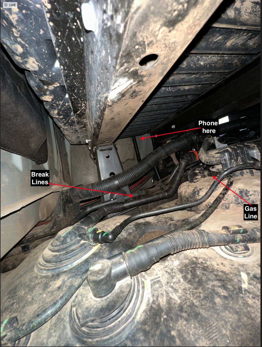

    Hey OP, could you show us a pic of exactly where you are sticking your phone in for these shots (or are you using a flexible inspection camera?) I have tried and tried with my phone and can’t get these shots you are taking. Thanks for the help.

    I would love to but it lives at the dealership for now. I went right in front of the rear wheel on the passenger side. Shove the phone camera all the way up flat to the underside of the bed and point it at maybe a 10% angle inwards towards the driver's side. You will see a large black corrugated bundle of wires you want to get the camera up and over that. If you have small wrists you could go between the drive shaft and the tank where the heat shield is.
    The picture below is from the drive shaft side looking back at where you want to get the camera flat up against the bed. You can see the black corrugated bundle you need to get above. wide-angle helps for all of this. You would need to angle the camera back towards the passenger side to be able to see where mine rubbed the break lines. The whole time I was taking photos I though they were rubbing where the two lines crossed on top of the tank.
