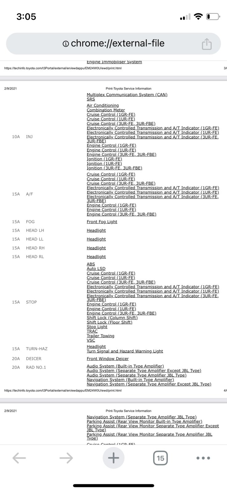

    Is 15V Stop the one am looking for? I consulted the 700-page manual with the complete wiring and am still confused if this fuse is in the engine or passenger fuse box

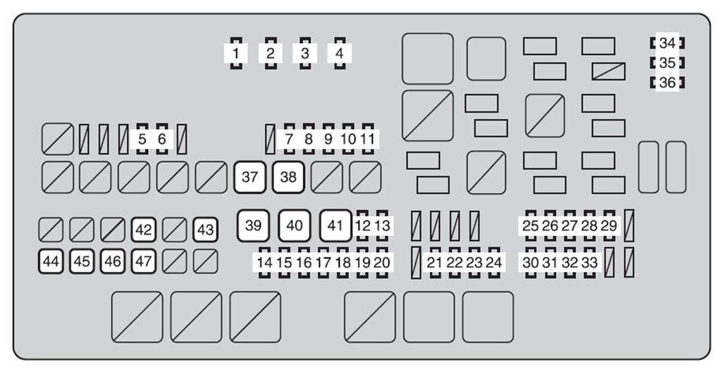

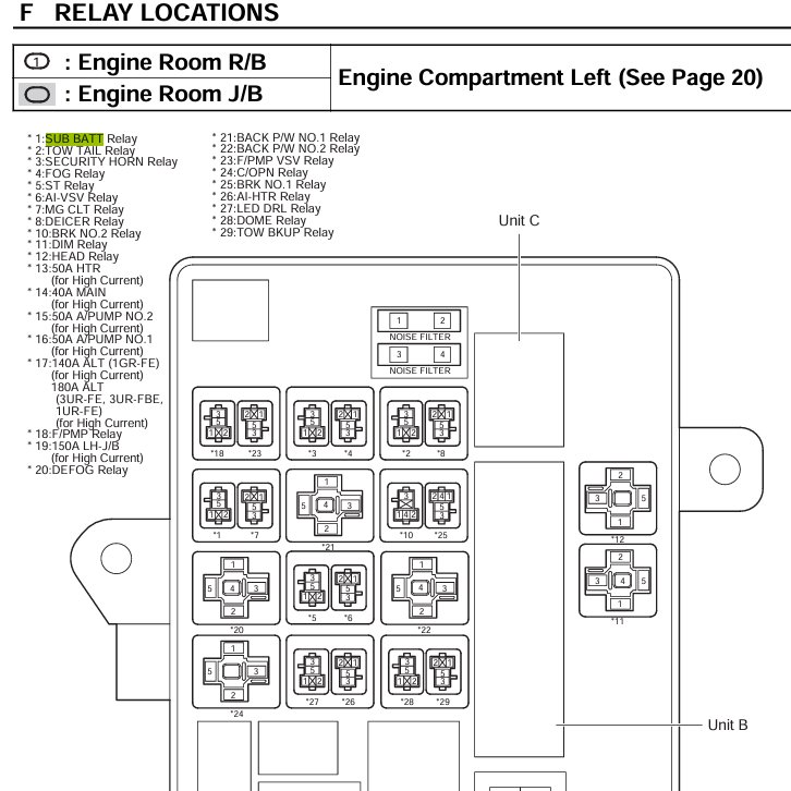

    Check #38 under the hood. I believe that's a 40A trailer accessory fuse.
    EquiTundra[OP] likes this.

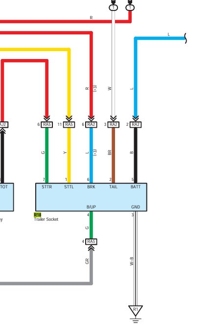

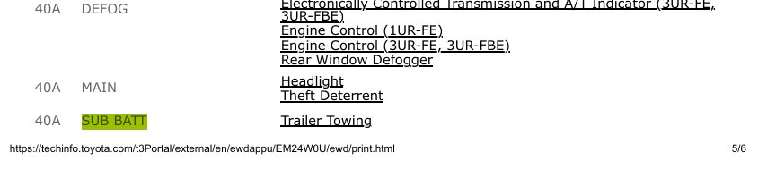

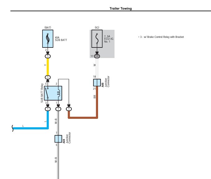

    That circuit is going to be your SUB BATT 40 amp fuse.
    Black wire, Pin 5 on your trailer plug.
    Maybe test it with a DMM.
    I'm guessing the fuse is in the engine fuse box, I can't find the location.
    Although the SUB BATT relay is in the engine fuse box.
    EquiTundra[OP] and _none_ like this.

    SUB BATT 40A is #38 in the diagram i posted above.
