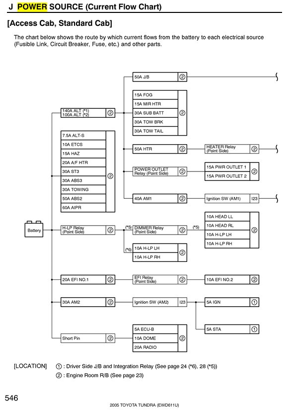

    I have a 2005 toyota tundra v6 and I have power to the ignition fuse under dash but no where else under dash fuse box panel. Does anyone know what could be the problem. All fuses are good.

    Welcome to the forum.
    Wiring diagrams can be found here.
    Ultimate TUNDRA Wiring Diagrams Collection | Toyota Tundra Forum
    What is the model of your Tundra: standard, access, or double cab?
    The double cab can be different from the other 2.

    It's a standard cab. We have replaced the 100 amp main fuse. What ground are u referring to? You will have to forgive me I'm not the brightest when dealing with electrical issues on vehicles
