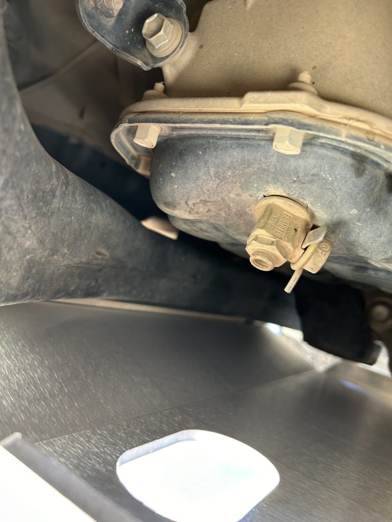

  16. Aug 29, 2023 at 8:49 AM

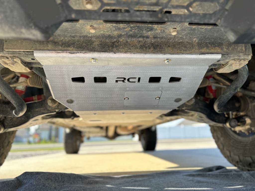

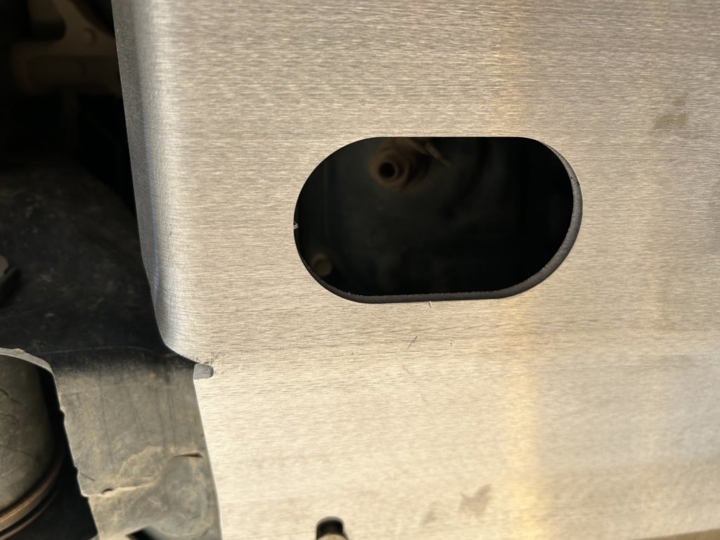

    37’s—PullKitchen--KB Voodoo Rack & Full Ext Cargo Tray
    The RCI skid plate works great with the Fumoto valve. I have about 1000 dirt miles with this set up and no problem. I don’t need to take off the skid plate

    Interesting. My ~3 y.o RCI skid is not like that. It's more narrow.

    This skid plate is on a 3rd Gen tundra

    I offroad in deep packed snow with Fumoto. Steel clip or a piece of copper wire keeps lever in place.
