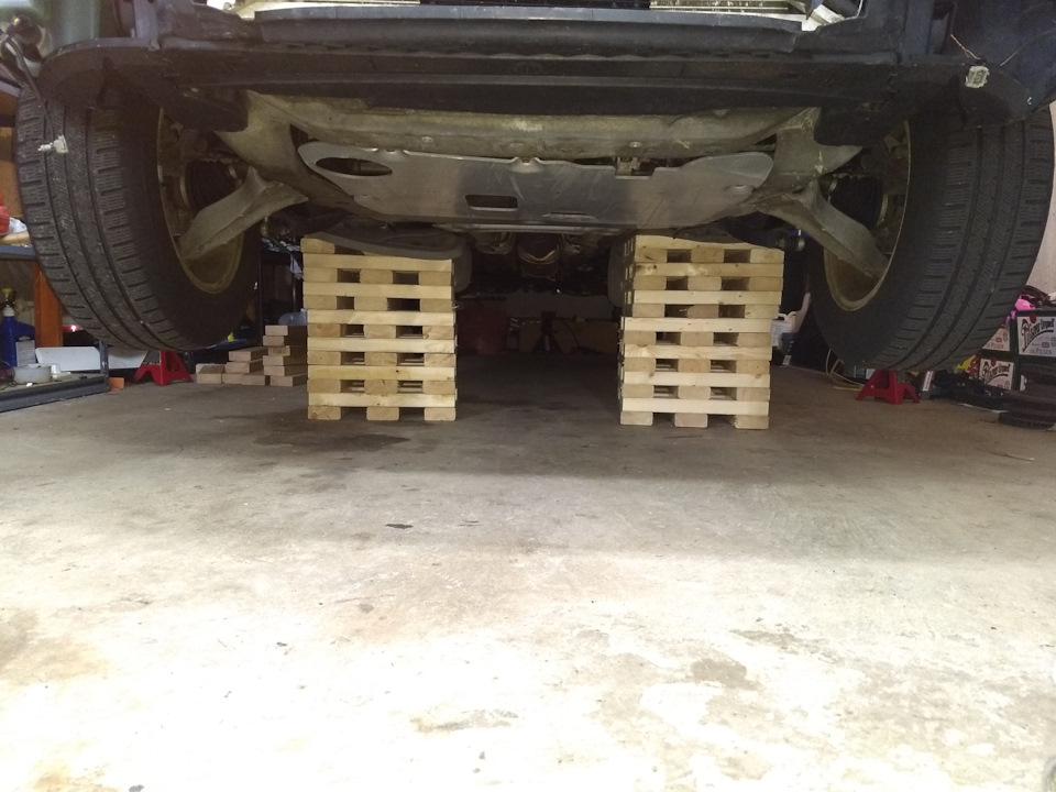

    Texas lift counts? Built one for overhauling Volvo transmission.
