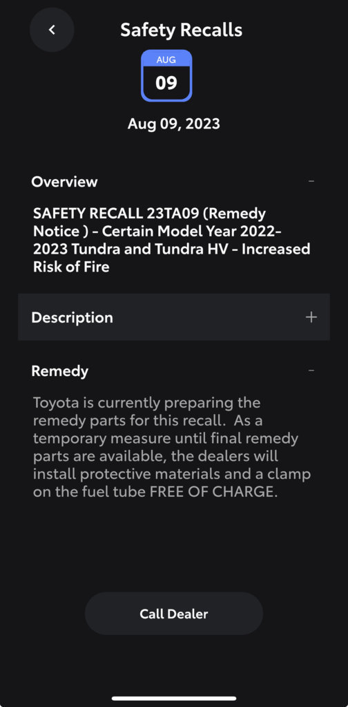

    Good morning all. I got an email this morning from Toyota that the 2nd portion of the fuel line recall is out. Parts get ordered by VIN. Call your local dealerships and get them ordered.
    I work at Toyota so i dont know if i get the email earlier or not but figured i would let you guys know.
    Campaign Description: SAFETY RECALL 23TA09 (Remedy Notice ) - Certain Model Year 2022- 2023 Tundra and Tundra HV - Increased Risk of Fire
    Campaign Status: Remedy Available

    Thank you! Ordered.
    Of course the app says it’s still not available yet. I appreciate the insider heads up!
