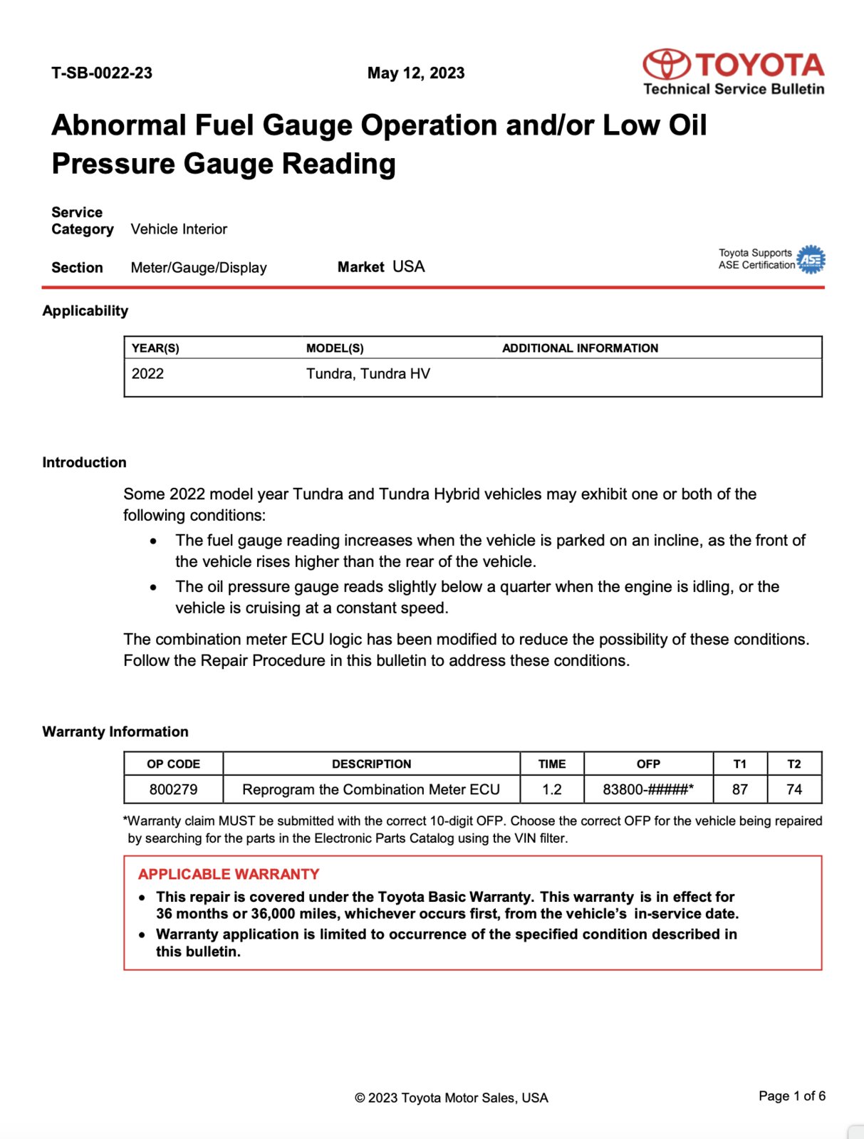

  9. Jan 27, 2024 at 12:23 PM
    #99
    PBNB
    PBNB Needy
    Oct 21, 2022
    #85226
    2,012
    Peter
    Vancouver, BC
    2023 Z71 3500 HD
    Lots of stuff!
    Mine did it the other day but mine went from 3/4 reading to 1/4 reading over night and my app told me what the gauge was showing as well so I lost 1/2 tank and the estimated range as well. I really thought I had my tank syphoned! I did the "D" reset and it went back up to 3/4.
    This happened just before the fuel line temporary fix. They would have had to deal with the extra gas fixing one problem and the other problem would have made it worse with all the added weight of the unreported gas.
    I brought this TSB to the dealership and during the other work, they said they didn't have it. Then they said that they didn't have the software to fix because Toyota didn't give it to them. Maybe in the next 6 months or so they might get it??
    I understand that fluid will move around when on an incline but the float should be dynamic and the reading should match the float position. This sounds sort of like our throttle issue. These are just variable resistor devices so why does this have to be so difficult??
    Maybe we need a "ctrl+alt+delete" set of buttons on the dash?

  10. Jan 29, 2024 at 7:24 AM
    #100
    nodak67
    nodak67 New Member
    Sep 7, 2017
    #9510
    3,297
    JR
    but that only applies to 2022 tundra's. the 2023 that this is happening to dont benefit from this tsb.
  11. Jan 29, 2024 at 7:34 AM
    #101
    PBNB
    PBNB Needy
    Oct 21, 2022
    #85226
    2,012
    Peter
    Vancouver, BC
    2023 Z71 3500 HD
    Lots of stuff!
    It looks like this doesn't apply to my situation either since my fuel level went down by 1/2 a tank and came back after I did the quick reset. Mine was built near the end of the 22 model year (one month later and it would have been a MY23) so it might have some of the transitional fixes that appeared in the MY23.
    I think their solution is to wait til I trade it in before it gets fixed :)
    I will just add this to the list of things that make it special!
