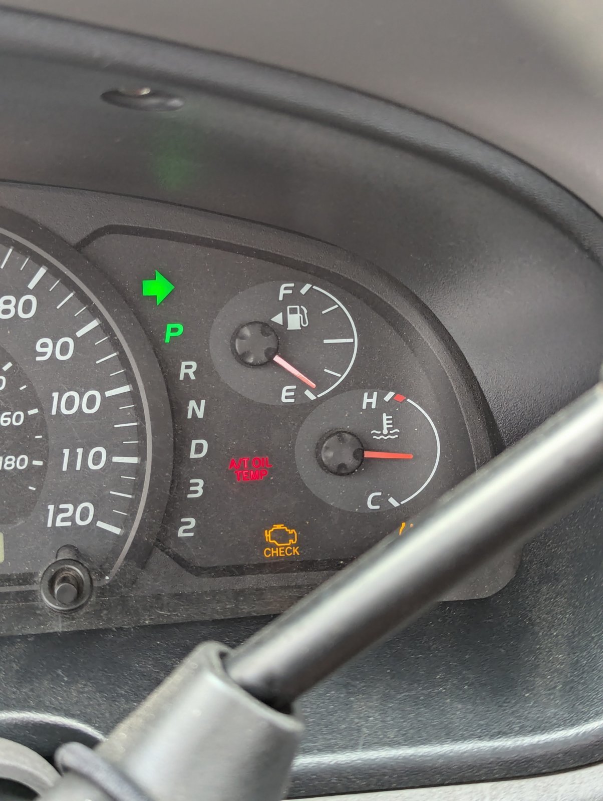

    My fuel gauge seems to be losing its accuracy. This is the 2nd time in the last 6 months it's just died while driving. I've had it much lower in the past. I understand it's not best practice to let it get super close to E but this seems off.
    Is there a way to reset something or is this a sign that the fuel pump is going out or there's a problem with the float or something?

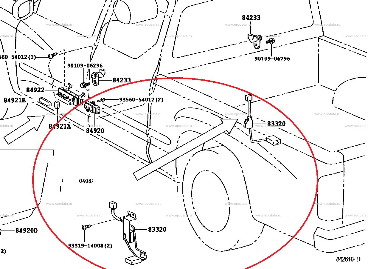

    You're right! They put the fuel pump in a weird place in the diagrams, it's under Body & Interior -> Fuel Tank & Tube.
    I dunno if your '06 is also UCK40 frame, but this is what I found for mine. In the diagram, I missed the reference link to the float/sender, here:
    That takes you over to Body & Interior -> Switch & Relay. From there you can click on "GAGE ASSY, FUEL SENDER" (on Schema 8 for me). MSRP is ~$131 at the time of this post. Most local dealerships to me have it marked at ~$90.

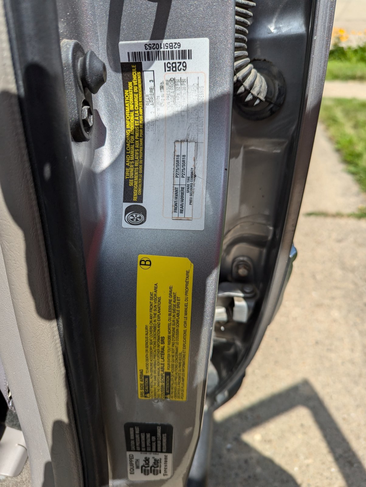

    Here's my door jamb sticker which explains why I can't find the frame code...was.like this when I got it
    Thank for the info. Hopefully I can get just the sending unit if needed. Gauge seems to work fine until getting close to E. Around 290 on that tank of gas is give or take normal for my truck from past tracking of miles.
    Mine is uck41

    I've got two stickers. The one you're showing on the post/hoop side of the jamb, and another one on the latch side of the jamb. Maybe my wording is off, I dunno how to describe something in that section other than "jamb". A lot of our older model trucks the latch-side sticker is black.

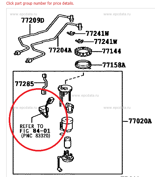

    This looks the same as the breakdown when I put my VIN in. Schematic is sorta hard to follow but is the sending unit part of the whole assembly and can be basically unplugged/unhooked and the new one be inserted and good to go? I'm wondering if even though the pumps don't tend to go bad very often if it's a better idea to replace the whole assembly. I thought they were well over 500. I think it's around 300 which isn't horrible.
    Edit* it's like 520. After some more looking at those parts and diagrams the resistor seems like it could present the same symptoms if it was failing but it sounds like if.it were bad it would do it at any level of gas in the tank. Is my train of thought correct?

    It's a resistance-based circuit. Almost all fuel tanks I've dealt with have a float of some sort - it's either a bulb on an arm/level that floats up and down, or a donut bulb on a slide that float up and down - and the float position change makes a change in the contact position of the circuit. As the position changes, resistance on the circuit goes up or down and the needle position is actually a basically showing the resistance level.
    Because a contact is involved, corrosion becomes a factor. Corrosion would change the ability of contact to happen, which could leave you with dead spots (i.e. fuel drops to nothing when you reach a certain gas fullness, as the float is contacting a bad spot), or if the corrosion was consistent and/or the float bulb was cracked and letting fuel inside, it may read as some weird lower-than-normal value because the float isn't, uh, floating.
    I really hope that answers your question. To install, you'd likely need to fully pull the pump assembly, unbolt the float/sender from the assembly, bolt in the new, then reinstall the pump. Naturally, if your pump has more than 150k-200k miles on it, I'd recommend replacing the pump, or the entire assembly just to get back to factory, but ... your money, not mine.
