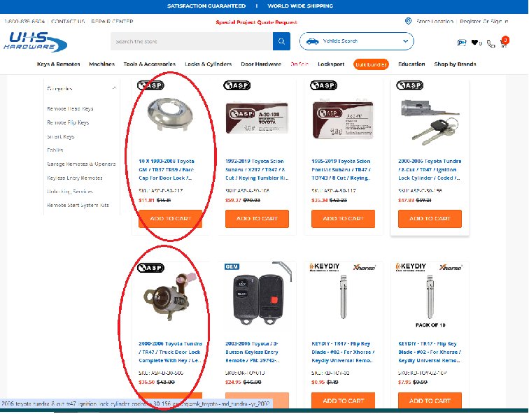

    https://www.uhs-hardware.com/pages/product-result?rq=mk_toyota~md_tundra~yr_2002
    The cap this site lists as "Face cap for door lock" doesn't look like it's the correct part for the door lock they list right below it. The cap looks like it's for the fuel door. Might be worth a call.

    That does look very similar but the tabs on the side are different. Edit after reading the description it's for the fuel lock. It says "Toyota Face Cap for Door Trunk Gas Tank Lock"

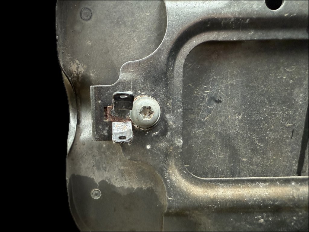

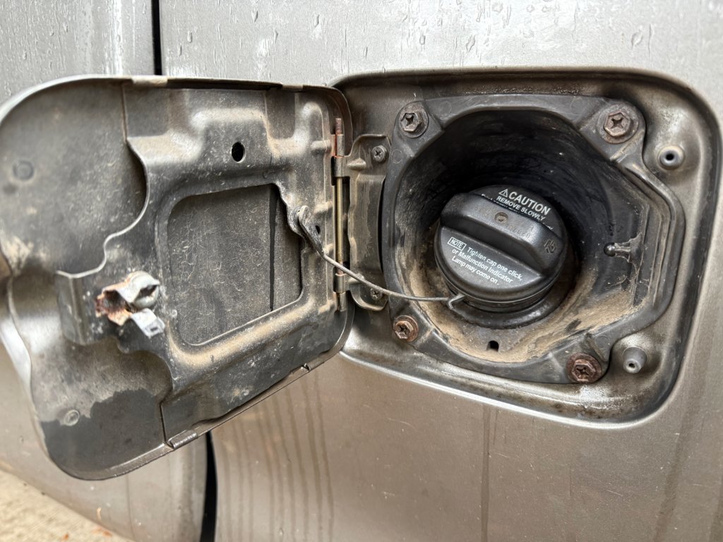

    Here's mine without the lock. Looks like it's just a normal hinge, a metal clip on the door, and a plastic tab on the inner shroud. Ignore all the dirt, the rain hasn't managed to wash all the dust off the truck yet.
    The clip is only attached with a single screw.

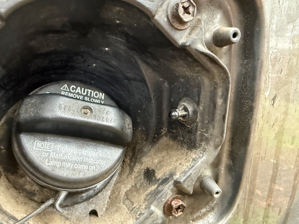

    Here ya go @Upshot Knothole . From the 2002 AC LTD.
    Outside (obviously)
    Inside. Yellow arrow points to the rubber coated, angled catch for the fuel door
    Fuel door lock. Yellow arrow points to the spring-loaded plastic locking arm in it's locked (at rest) position.
    Fuel door lock. Yellow arrow points to the spring-loaded plastic locking arm in its unlocked (under tension) position.

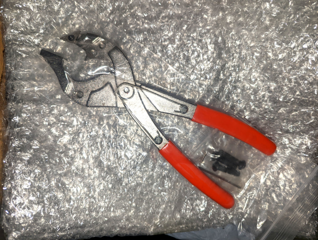

    Got one of these to play with.
