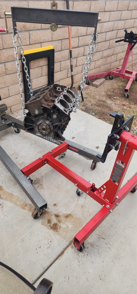

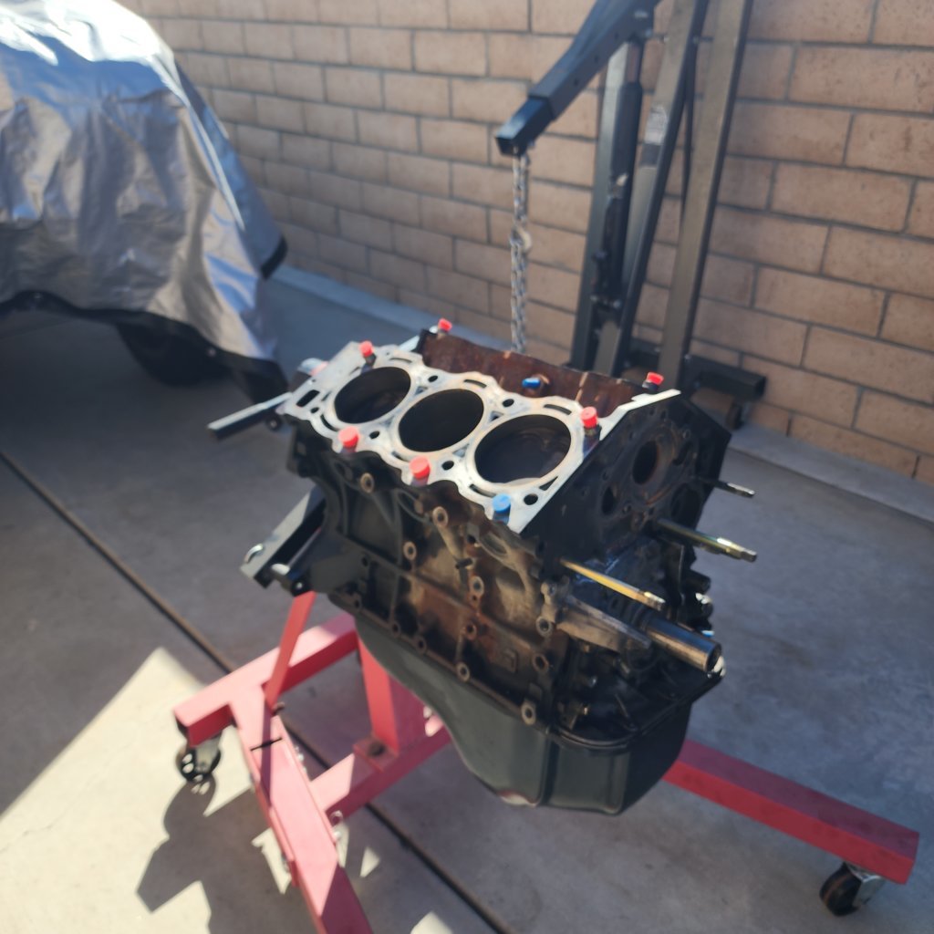

    I have a Haynes for my '02 Tacoma that I gotta dig up somewhere. Does Haynes provide detailed disassembly and reassembly of the engine block? Or should I look into getting one of these FSMs for my truck?
    I got my engine currently half disassembled and thinking being a YT mechanic may not be enough to give me all the proper torque specs.
    @shifty` I've seen in this forum that you know the 1st gen Tundra inside and out. How's your knowledge of the ins and outs of the 5VZ?

    Thank you guys! I found my Haynes manual and skimmed thru it. It has a lot of info in there including the exploded diagrams like @Jack McCarthy stated. Only thing though is it covers Tacoma, 4runner, & T100 so that makes it a bit difficult to work with. I think between that and the '03 from @shifty` I think I'll be able to tackle this :thumbsup:
    Much appreciated!
    I am a bit intimidated by taking this further than what I already have done so far. Disassembly is easy enough but it's the reassembly that gots me a bit nervous. Have been thinking of taking it in to Yota1 and having them do it for me but I'm on a tight budget right now and have all the time in the world to do this myself so I'm on the DIY fence now about it.
