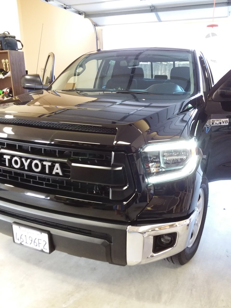

  9. Dec 30, 2017 at 4:14 PM

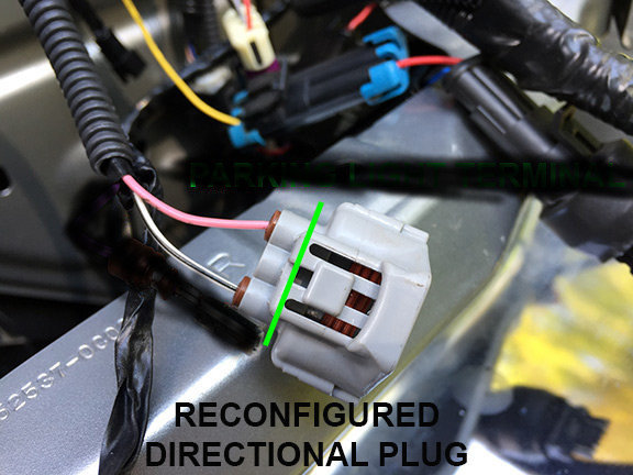

  14. Dec 30, 2017 at 4:32 PM
    #344
    boostedtrdpro
    boostedtrdpro voided warranty
    Nov 23, 2017
    #11123
    1,207
    Jeremy
    2024 GMC Sierra 2500HD AT4X 2020 Sequoia TRD Pro 040
    Here's a picture of the completed reconfiguration on the plug. If it's not this, then I would check fuses and bulbs I guess.

    #346
    Triton19X2
    Triton19X2 New Member
    Dec 10, 2017
    #11450
    210
    2021 Silver 1794 Crewmax 4X4
    A picture is worth 1000 words....I swapped the pink/red and the white and had the hyper flash but the white actually needs to move to the #3 location...not #2

    2019 TRD PRO LED Headlights, 2019 TRD PRO Rigid LED Fog lights, All LED Interior, LED Cargo Lights, Bed LED Lights, Undercover Flex, Husky Weather beater floormats, FORTIN EVO ONE remote start, TDR Cold Air Intake, Tundra tail gate inserts, Pop & Lock...
    Pink and red keep the same location, the only wire you have to move is the white/black

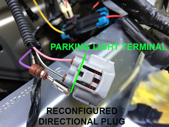

  20. Dec 30, 2017 at 6:53 PM
    #350
    iHacker
    iHacker [OP] SW TRD PRO
    Mar 19, 2016
    #2962
    1,271
    Mario
    TRD PRO Super White CM
    Yeah is the same, the only difference for SR5 or PRO is we also have a purple wire there but this is the one we have out of the connector to power the DRL lo

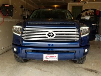

    I got my lights installed yesterday but they don't work 100% right - any help is appreciated...
    With the engine off, everything works like it is supposed to.
    With the engine on, the DRL's work until I turn on the headlights. When I do, the drivers side DRL goes out completely. when I turn on the high beams, the headlights and the passenger DRL shimmer from normal to a lower level, and back and forth quickly.
    I have heard of people getting a bad Morimoto. Could this be my issue?
  24. Dec 31, 2017 at 9:14 AM

    That’s weird, since your truck is a Platinum your Ballenger harnesses have zero intervention with DRL, I suggest you to check connections for the Ballast and High Beam plugs, I’m not sure wiring colors they use but the plug going to the ballast side have 2 wires I guess one is white (ground) and the other is green (positive), and for the high beam plug is just a single wire in the positive side maybe blue or not sure, check this connections to see if they aren’t placed inverted
    And also any info in what you did with the pins swap in turn signals only Your wire position were like this before any mod
    And after pin swap must look like this just had to move the white/black from center to that spot with a black rubber plug
    Your LED DRL plug is plug n play nothing to do there

    Ill have to double check the harnesses - I am pretty sure I plugged the one with 2 wires into the high beam plug. I wasn't sure which one went to which one since they weren't labeled, just took a chance and plugged them in the same way on both and they worked before I reinstalled the headlights all the way back into the fenders, but I didnt go through starting the truck and running through all the different lights individually. The directional plug wires were swapped just like in the pictures above.

    Yes check that, the high beam plug just have one wire in the harness and the other with 2 wires in the low beam or Ballast in the motocontrol this is the same in driver and passenger side

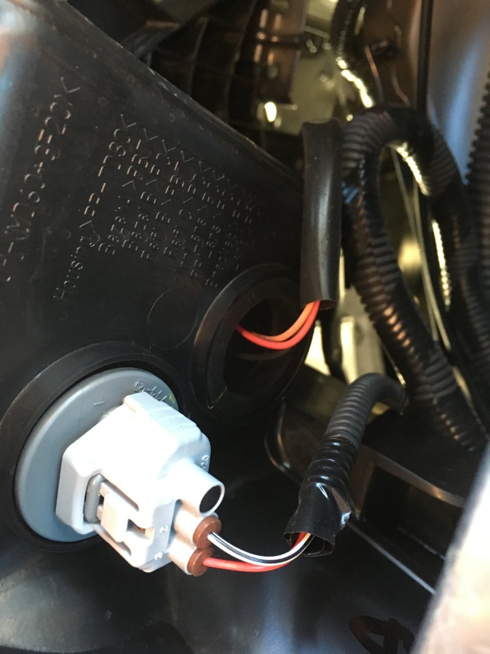

  27. Jan 1, 2018 at 2:34 PM
    #357
    Trevman2
    Trevman2 New Member
    Dec 5, 2017
    #11357
    41
    thumbnail_20171230_115036[1].jpg thumbnail_20171230_094250[1].jpg thumbnail_20171230_094246[1].jpg thumbnail_20171230_094240[1].jpg
    Yup - that fixed it. Thanks for the help

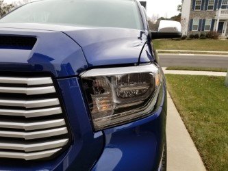

    Finally got around to installing the 2018 LEDs in my Tundra last week. Definitely wouldn’t have attempted this without the harnesses from @iHacker – He makes a fantastic harness and responded quick with all of the questions I had - I had an issue with getting my VLED V3 Triton turn signals that I was previously using to work and his advice was spot on.
    This mod was definitely worth it. The lights look great and the LEDs are just as bright as the GTR Lighting GEN 3 LED bulbs I had been using and the light pattern looks more focused and not scattered. :thumbsup:
    Thanks to @Roman for the black Friday deal on the headlights and thanks to @iHacker for everything else! :cheers:
