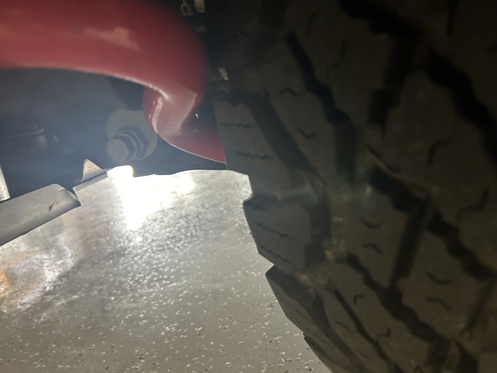

    Yea my 35s are kissing the bar and I always kick around just removing it.

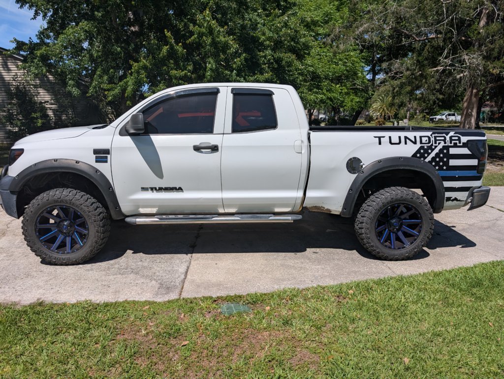

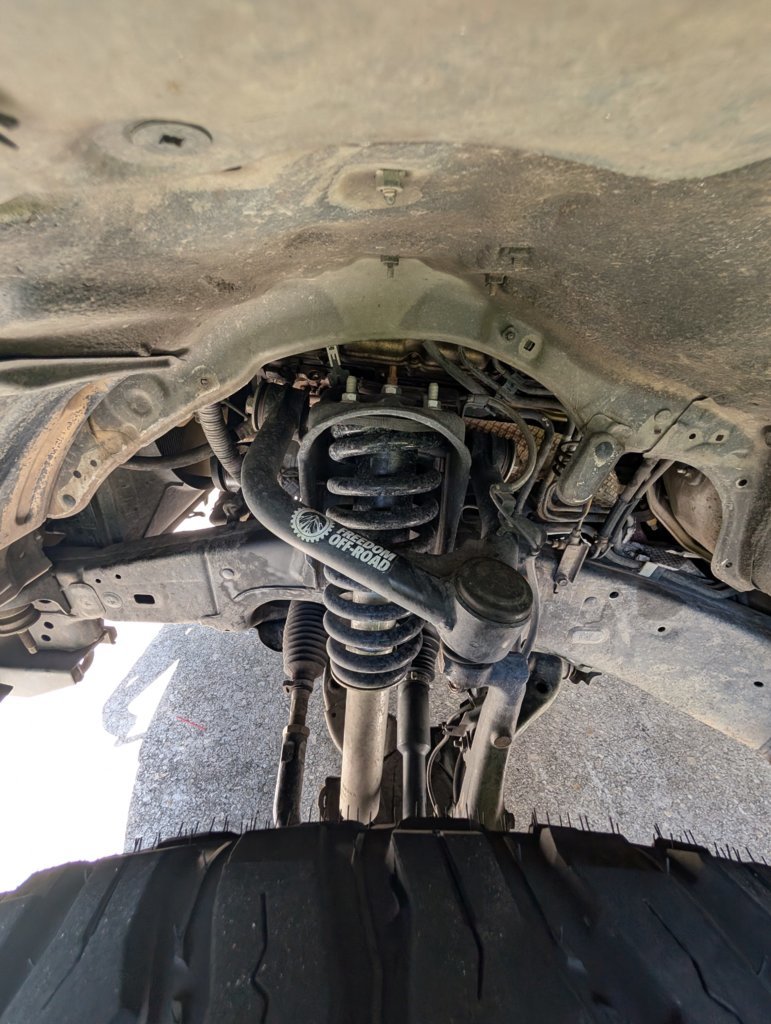

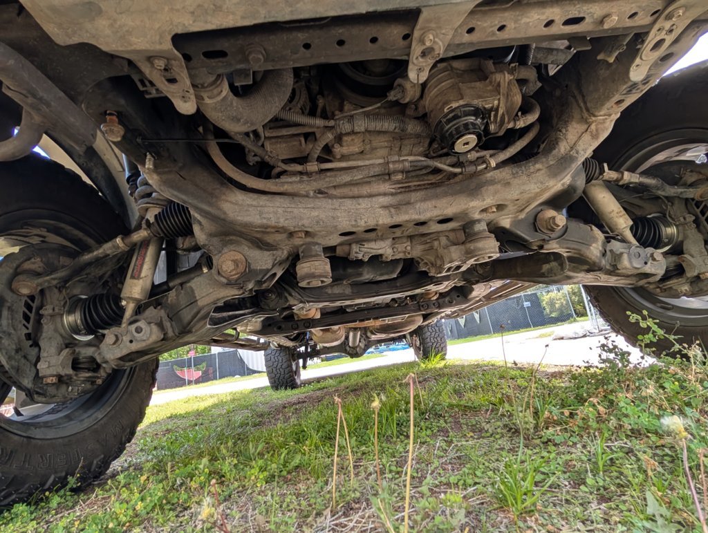

    I removed my bar last week and its going back on for now. I already fight a vibration issue but the cheap rough country 3.5 struts up front dont keep the tires grounded for highway speeds. I do like the feel of it gone in a lot of other aspects - a bump on the right side doesnt make the whole truck feel it, it feels more free but it multiplies the vibration i have from 58-68. I can get to 70 and it be good but at 75, the typical truck shutter kicks in. Rebuild drive shaft and balanced. new cv shafts, rear bearings and seals, 2nd set of tires. Not the TC but could be trans as more prevelant in 5th\6th. Dont feel a thing under 50. The after market shaft does the typical vibrations\shakes. That whole discussion is for and on another thread lol.
    My current SB bushings were hard as a rock\dead along with back shocks (just ordered the 2" 5100's to help with that). After sway bar delete, I went a had tires balanced and new alignment yesterday along with a new tire to replace one that was chopped up from the front fender well.(prev owner cut into frame and body for tire size) No help with ride this morning. My feet are falling asleep with my seat vibration at the speeds mentioned above. Have to fix the one of the bolts that got stripped and stuck inside the frame when removing nut before re-adding bar.
    Add photos of my 4wd blender. lol
