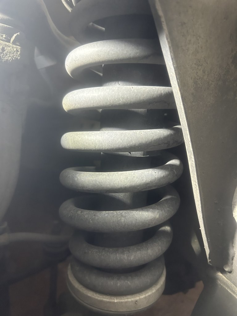

    Hello everybody, I’m back here to pester you fellow 1st gen intellects with more questions. Anyways, so I am replacing the front shocks on my 2006 Sequoia V8, 2WD. Right now it has some shitty Quik struts, and I’m not sure whether to reuse the coil springs from those. I can’t seem to find any new coil springs, OEM, or aftermarket ones that retain stock ride height. The only OEM ones I could find (48131-AF370 for LH) (48131-AF380) are listed for 4wd sequoias, mine is 2WD. I’m not sure if those would fit right. I’m not looking to lift it, at this time, as this thing barely clears the garage door, but I digress. Btw, new shocks are Bilstein 4600s, already installed the rear ones.

    Do the coils have any markings on them? Any paint? Red/Yellow?

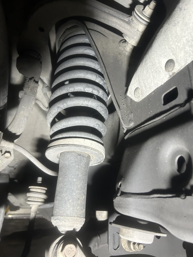

    Here is the pics of driver side, sorry I’m afavnace if the quality is lacking

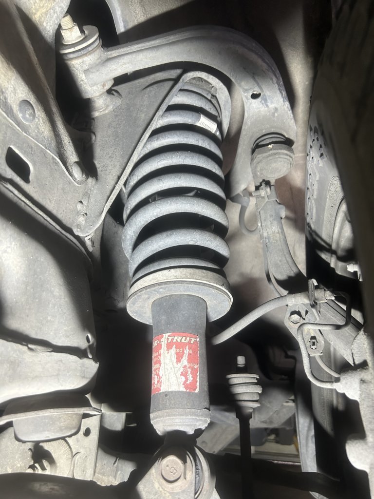

    Here is passenger side. Yes it is also a quik strut (the sticker is just on the back side)

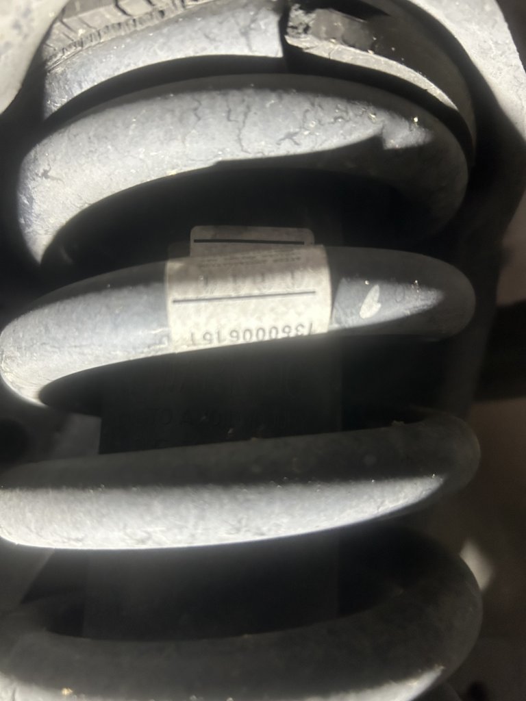

    I did a quick Google search for "135000615T" and find that it's the spring pre-loaded in the Monroe Quickstruts.
    Whether or not it'll be compatible would depend on the circumference of the coil, top and bottom, and the strut you're replacing it with.
    I can tell you, with semi-high confidence, @whodatschrome has experience on this very topic, and if my shitty memory has that much correct, I think I'm also correct that the top of the coil was too small a diameter to work with the OEM top isolator, or something to that effect.
    Hopefully he can chime in and say. If it were me, I'd just go get some some OME 2883 springs to go with those Bilstein 4600s, and get the necessary new isolators (and tophats if you don't have any OEM on-hand), assemble or have someone assemble them, and be good for another 80k-120k miles. The 2883 shouldn't provide much (if any, ½" - ¾" max, which is nothing) lift on your Sequoia.

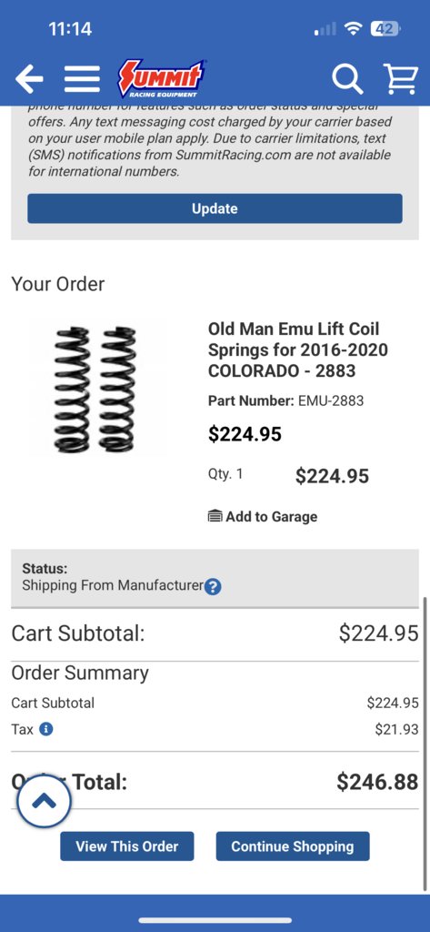

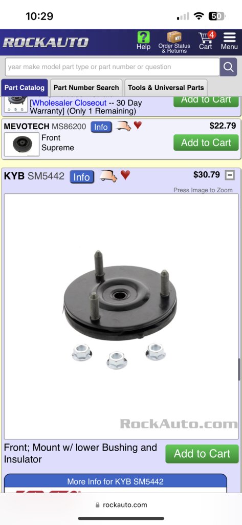

    Ok so I’ll give the 2883 a try then. As far as the insulator/top mount. Would this work? It’s listed for my 06 sequoia on Rockauto. Or am I’m gonna need a beefier one for the upgraded springs? Like I said, I don’t really have a problem with the stock rake on this truck. I think it’s the tundras (especially double cabs) who got it worse.

    Went ahead and pulled the trigger on the springs. Guess now I have bragging rights that I have an old man emu setup on my “off-roading rig” (forgetting it’s a 2WD) nonetheless, can’t wait to give it a shot

    That's the tophat you need and that kit comes with rubber isolators IIRC. Per another member, this KYB set has the spring isolator you'll need, to seat the OME spring to the isolator.
    You can buy the isolator from anywhere. But if you're ordering from Summit already ...

    Update: ok so I ordered the tophat plus isolator, KYB SM5442. Everything (including the OME 2883s) won’t get here until next week so now I just got to play the waiting game. Other than that, I thank you all for the input, and hopefully the assembly/install goes smooth

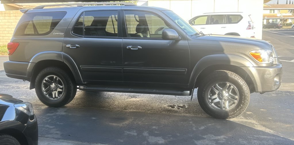

    Tophat is getting here tomorrow. But I just wanna make sure, the OME 2883s are not gonna make this thing do a Carolina squat, are they? I don’t wanna install them and then realize I look like I’m living an alternative lifestyle. Idk, just having 2nd thoughts lmao
    The springs are expected to ship out Thursday *sigh

    Have a pic of what you just got? If it's what I think it is I'd definitely avoid it.

    Is your rear currently higher than the front like a crewcab 1st gen?
    If yes, it shouldn't.

    This is the way it sits now. This is with the third row out, I have no use for it as a single 20 year old without kids lmao

    Measure it on level ground? Either tire to fender or hub to fender.
    I can't 100% tell from a pic, as I'm on my phone. Though the front does look 1/2" to 1" lower.
