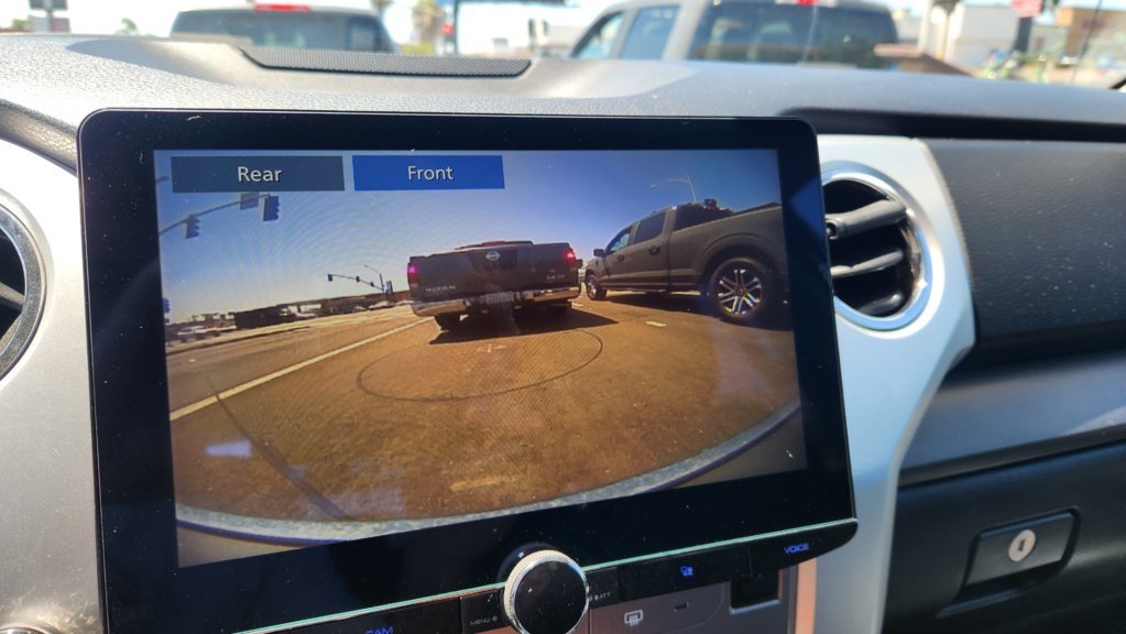

    Yep, they'd let you drive right into a brick wall if it's directly in front of you. :(
    Main reason I added the front cam when I upgraded the HU. Makes life SOO much easier.

    How do you like the head unit and what year is your Tundra? I feel like there are to many settings linked to my head unit to remove it

    Love it!!
    I have a 2019.
    I think I lost a couple of the Entune settings that I didn't really use, and gained WAY MORE than I lost.

    That’s an awesome unit, do you have the model number by chance?

    Yeah, I really like it.
    Kenwood DMX1057XR
