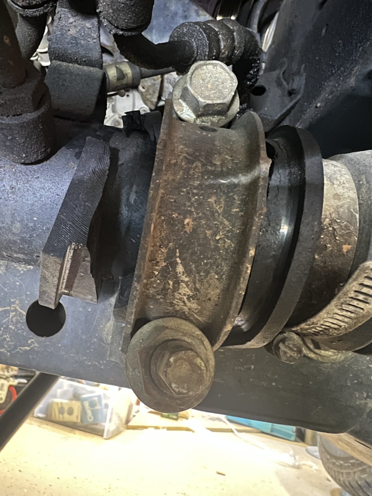

    Mine did this. Put your phone in front of the truck on video and steer back and forth. If the rack moves before the tires move, pull the rack bolts and put in new steering rack bushings. I used the two piece whiteline bushings and it was like a whole new truck.

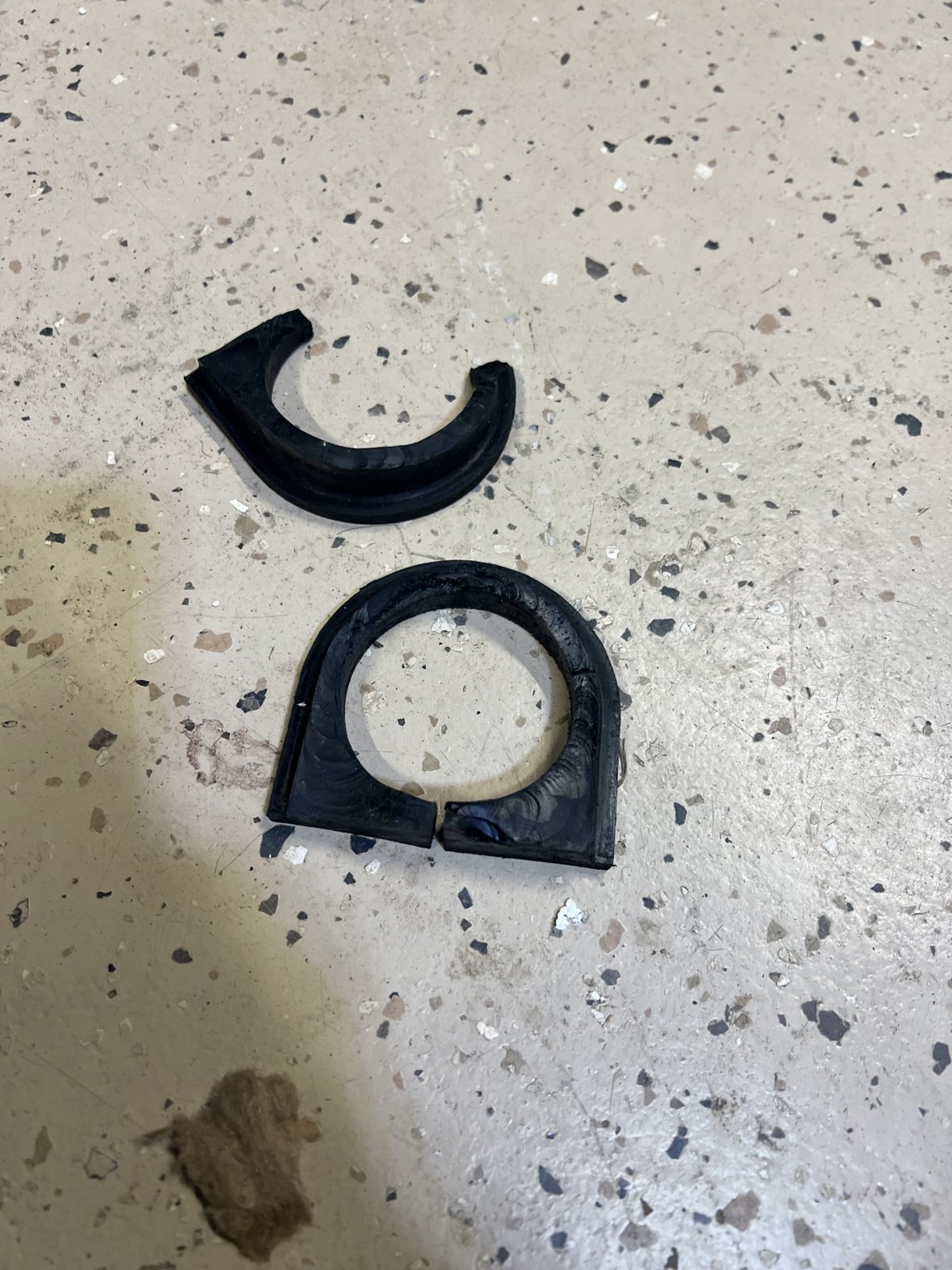

    Interestingly I just had a similar complaint / symptom on my truck. Steering wandered a little and felt like it lacked a true center. Like driving a solid axle vehicle with a loose steering box gear. Turn in felt lazy and then it would sort of slip with a big dead spot. Turns out my steering rack bushing was non-existent. I put poly in about 40k miles ago and it had failed. Had to make an emergency run to the LAPS to replace.
  16. Nov 8, 2023 at 7:18 AM
    zzyzx85-714
    zzyzx85-714 New Member
    Oct 10, 2023
    #105204
    14
    2006 AC SR5 V8 2WD
    what brand poly bushings were the ones that failed?
  17. Nov 8, 2023 at 7:18 AM
    KNABORES
    KNABORES Sarcasm incoming
    Jan 1, 2020
    #40572
    14,516
    Arkansas
    I’ll have to dig deep into the archives and see if I can find it.

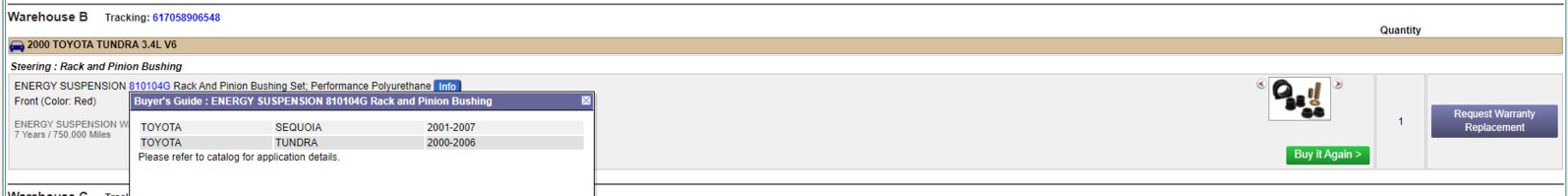

  18. Nov 8, 2023 at 7:28 AM
    The Black Mamba
    Sep 6, 2023
    #103472
    4,757
    Snek
    DFW
    Black 00 SR5 AC 5VZ PreRunner
    Imma keep it stock
    These are the ones I went with most recently

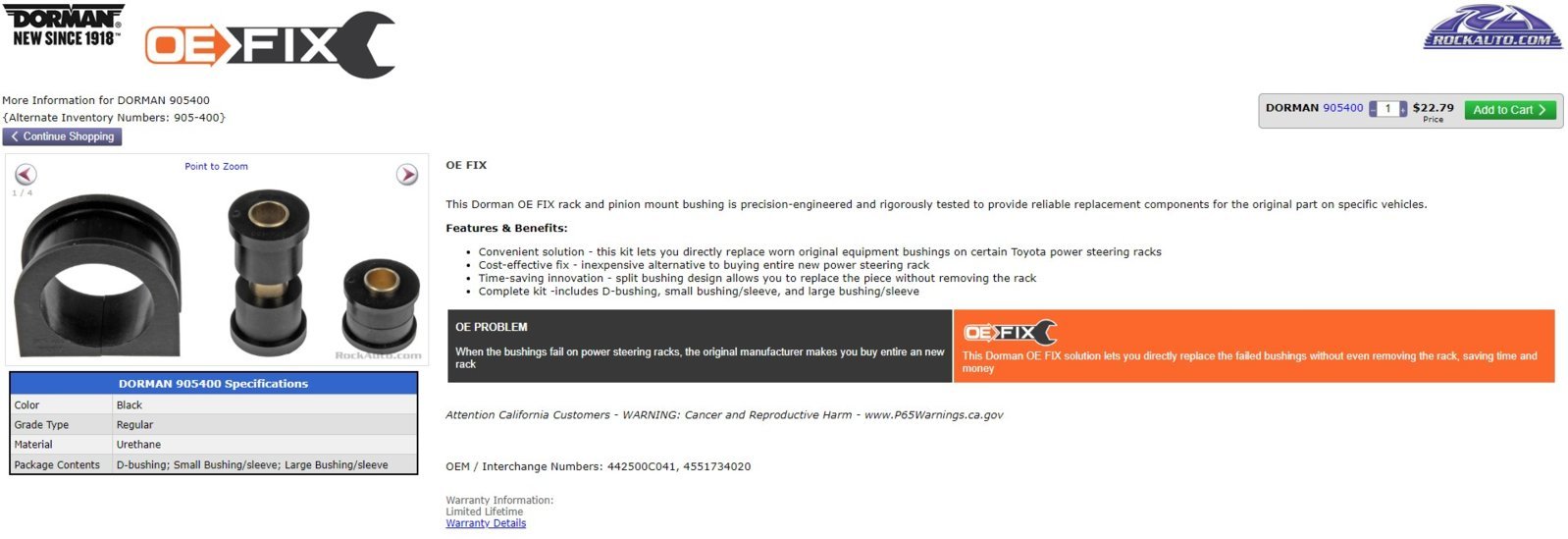

  19. Nov 8, 2023 at 7:39 AM
    KNABORES
    Jan 1, 2020
    #40572
    14,516
    Arkansas
    These. Urethane Dorman replacements. Updated the hall of shame thread as well. Booooo

    I have the Energy Suspension kit in a cart and have for about 2 years now.I guess I need to pull the trigger on that eventually.
